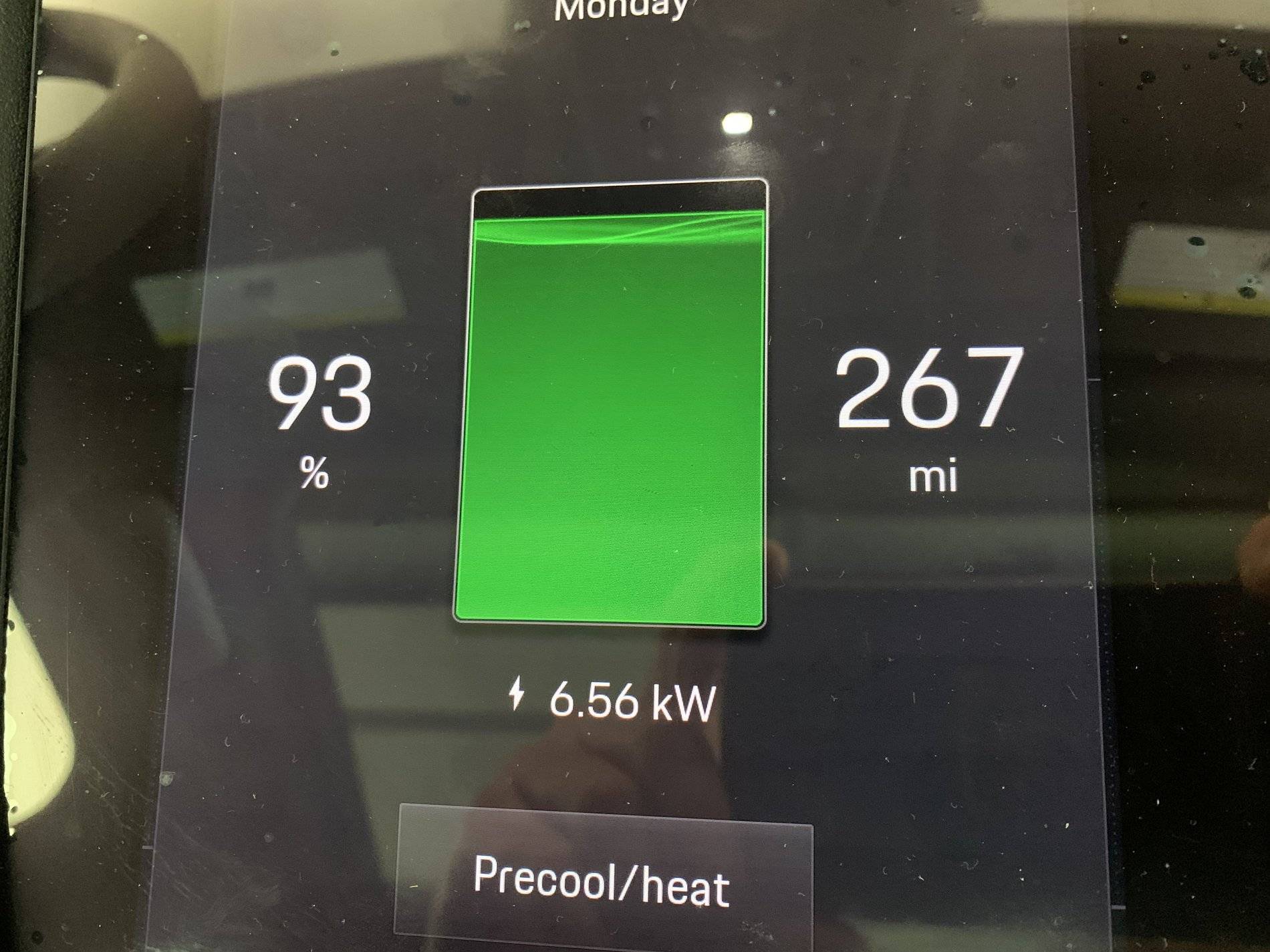

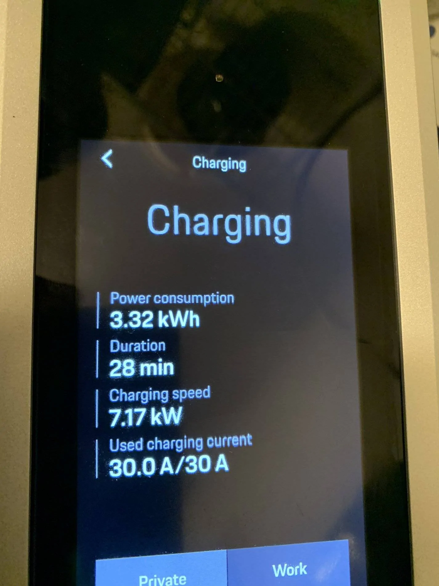

I'm very interested in seeing what the kilowatt rate is on the charger and the one in the car to see how much lost there is between the two. But be sure that the lights and HVAC are off in the car so no other large draw items. The reason I am a little concerned is the wire for the 25 foot cord did not look too large from the pictures I have seen. I bought a Chinese charger that would do 32 amps and it's cord is very beefy.
Test at 30 amps from a dryer 220 circuit
I tried it again and here is what I got, can someone in the US, post what their results with a 50 amp circuit, would like to know what to expect, thanks
Porsche Taycan Setting up for charging in garage IMG_1199
Porsche Taycan Setting up for charging in garage IMG_1201
ron_b
Ron
Dec 30, 2019
327
1,588
1,679
SF Bay Area, USA
That's great @Cpoarchy
7.17kw x 100 / 30A = 239 Volts which is perfect as expected for non-commercial which is often only 208v.
So a 50A circuit would give the max of 40A x 239V = 9.56kW. so basically 33% faster. But it's always good to get it the info from a actual owner which sadly I am not yet. You can look on plugshare and see if you can find an available nema 1450 in your area for testing, I had found one in Santa Clara that I used to test my charger when I first bought it at full power.
Btw you should check your circuit breaker for that dryer plug outlet and if it is only a 30 amp circuit breaker you should not be trying to draw 30 amps as the car draws it to continuously. If you are monitoring it and it will be less than a couple hours it's probably not an issue but I would not set it higher than 80% (24A) if you are leaving it unattended.

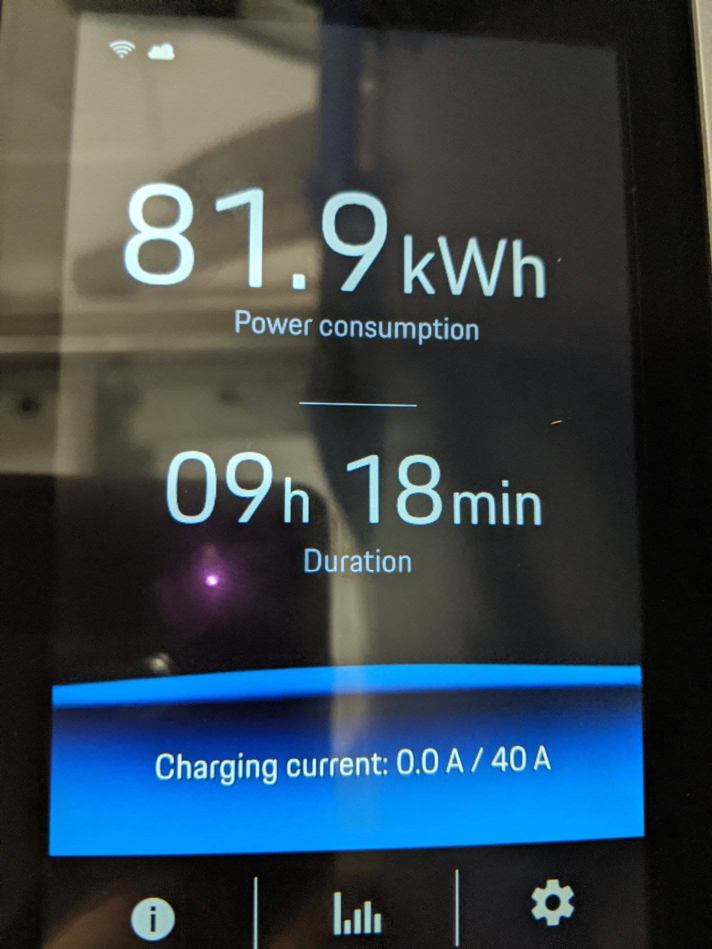

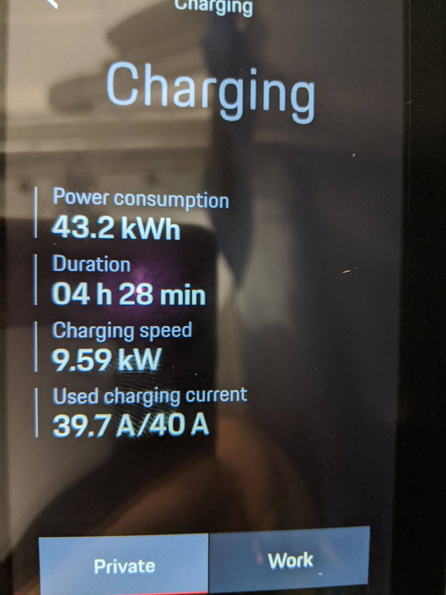

dryii
Doug
Jan 30, 2020
331
292
Orlando, FL
I plugged in at ~19%.
Porsche Taycan Setting up for charging in garage IMG_20200618_160303
Porsche Taycan Setting up for charging in garage IMG_20200618_155958

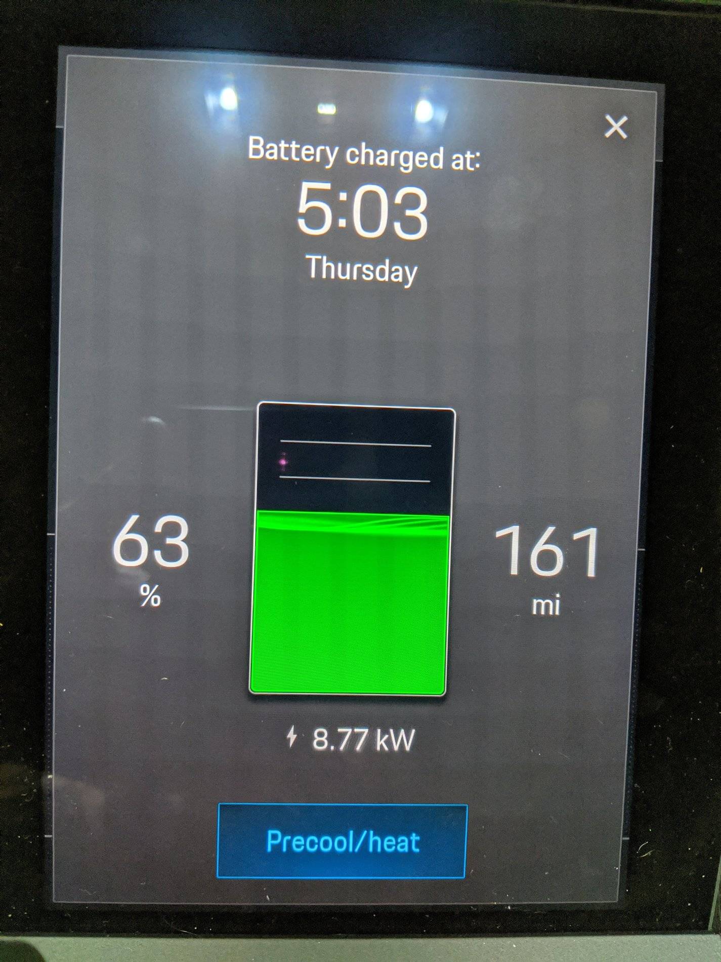

Well that computes out a bit high from even what I was expecting which was 90 to 91 kWh.
To explain what I did was use the in car kilowatt charging rate from your previous post and the charger kilowatt rate from your previous post to determine the charging efficiency which is really quite good at 91.4%.
then using that efficiency along with the delivered kilowatt hours for this cycle / 100% - 19% to derive the theoretical full usable battery which is 92.5 kilowatt hours. So they seem to have reduced the reservation significantly which is similar to the Tesla philosophy. I definitely think you will want to set a charging profile to 80% or 85% and as long as you don't fiddle with it after the charge begins you should not have the problem that Don @louv speaks of. I would only take the car to 100% if you're going on a trip and leaving shortly after it gets to 100%.
May I ask how quickly you collected those photos after it reached 100%, if it was several hours then maybe the car did some conditioning afterwards that would explain more charger usage.
AC Charging efficiency:
8.77÷9.59 = 91.4%
Usable projection:
8.77÷9.59×81.9÷(1−.19) = 92.5kWh
Time if full speed charging
81.9kWh / 9.59kW = 8.5hr
Charging time was 9.3hr so basically had to only slow down for a little while. I am just too excited to get my car. :cool:
