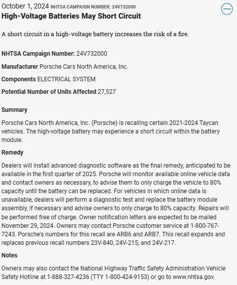

In the recall.
From WRS1 dealer campaign:
As soon as the software is available, the final action (Q1/2025) must be carried out in accordance
with the ARB6 recall campaign
ARB6 recall campaign:
Porsche Taycan ARB6 Recall notice UK.... 1744668780655-dw
Dealers will install
