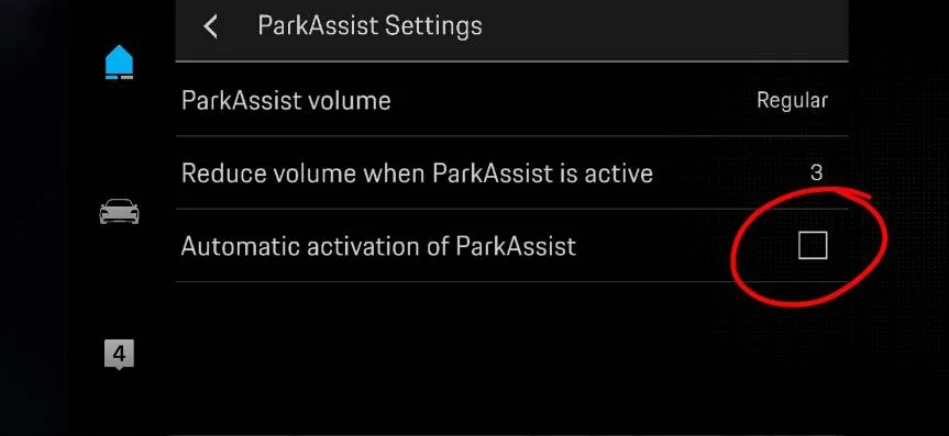

Dee
Dee
Dec 14, 2018
63
2,653
3,109
A lot
Hi @LukeManning ,
I have a question according to settings.
I don't want to "auto-switch on of parking cameras" so I deselected the checkbox (see att).
The next day, when I switch on my car, the checkbox is selected again.
It seems the car doesn't store this setting while other settings are.
My car is MY2020.
Any ideas?
It's quite annoying when you pull up at the traffic lights and the cameras (and beeps) come on...

Hi @LukeManning ,
My car is MY2020.
Any ideas?
Dee,
I am not sure on this one.
I might try to press "Set 1" and see if you can save that setting to one of the dummy keys on the side doors.
