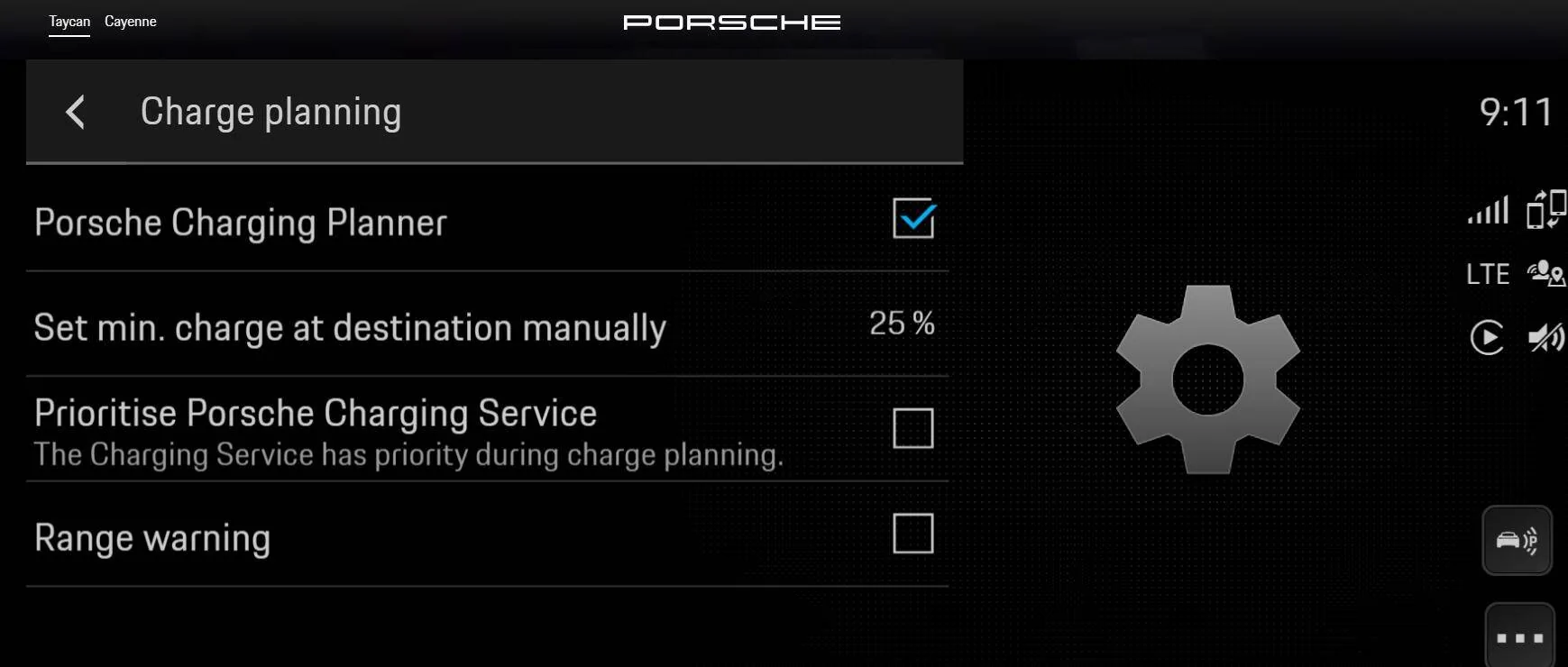

Another way to avoid unwanted charging stops - without altering the minimum charge setting - is to deactivate the Porsche Charging Planner for that trip:
PCM > Nav > . . . > Charge Planning > Porsche Charging Planner checkbox

Looks like default setting is 25%.
Stupid as at least 50% of your journeys are to home where you have charging so why the **** would you need 25%.
Leave Porsche charge planning ticked. Too useful to me and I don’t want to forget to turn it back on.
Turn down minimum charge at destination to 3%. The minimum.
Obviously if you are going somewhere without charging and you need a certain charge for when you leave you will search for and go to a charger before you get there.

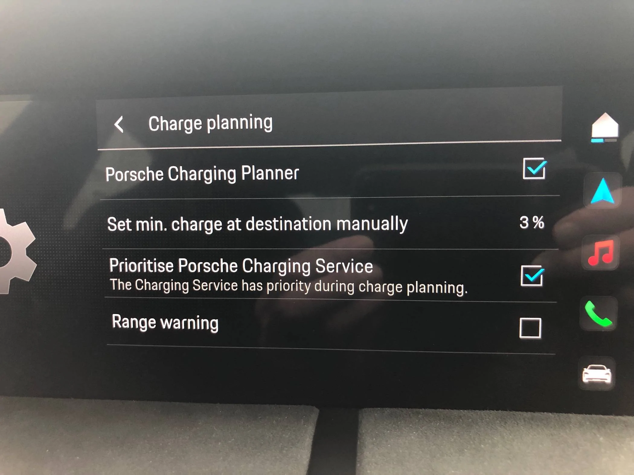

My screen
Porsche Taycan Battery level at destination IMG_4556

Thanks Everyone! One final question....What is the series of clicks to get to that last screen?
