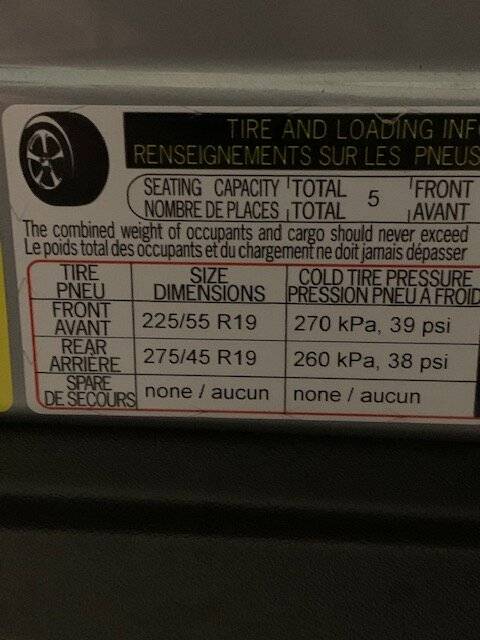

If I remember correctly, my pressures are specced on the decal at 42 (front) and 45 (rear). Are yours different?
39 and 38 according to the decal. The car was delivered mid-October and early December the low-pressure alarm went off: 35/36. Reading on this forum that a slightly-above-spec tire pressure improved range, I increased mine accordingly.
As the decals don't differentiate for wheel/tire sizes (I have 21 Summers and 20 Winters), then I guess its a difference between the TurboS vs the 4S. That's a pretty big difference I think!
Decal pressures are for full load. Partial load values are lower - you can get them in the PCM menus. IIRC it's 38/38 for the 21" rims.

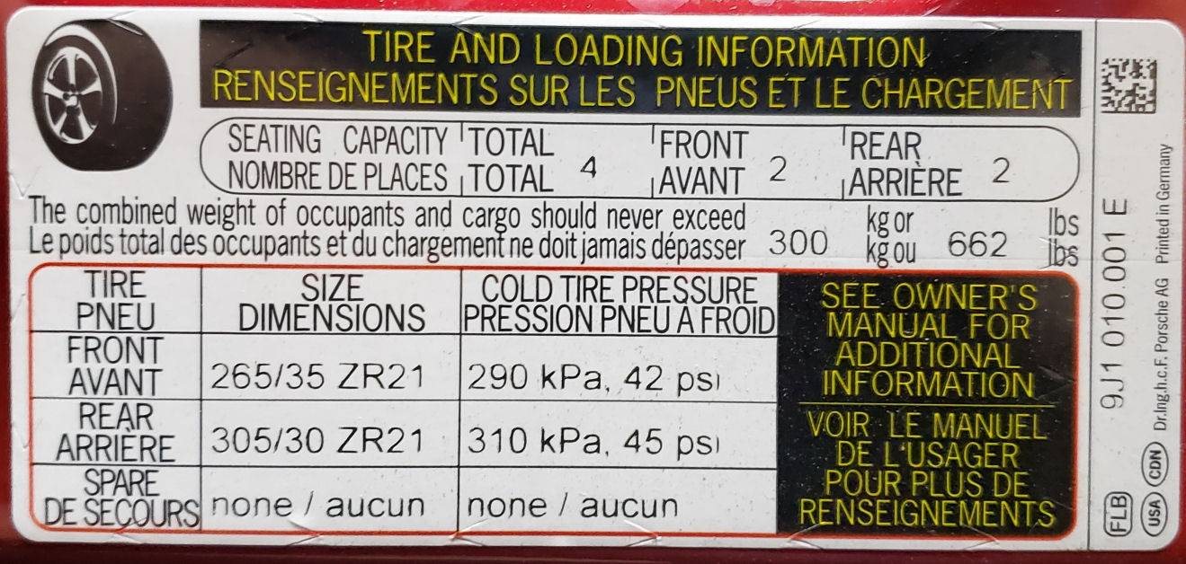

Just Confirming:
Porsche Taycan Consumption and full battery charge level Tire Pressures
(It is specifically for the 21's)

Just Confirming:
Is this label somewhere in the car?
Disregarding the info on tyre pressure for a moment. Car is good for four persons but only if they weigh 75 kilos each! That does not leave any room for any luggage at all for a trip. And where would you find 4 adults weighing less than 75 kilos each, to go on a trip.
Is this correct?

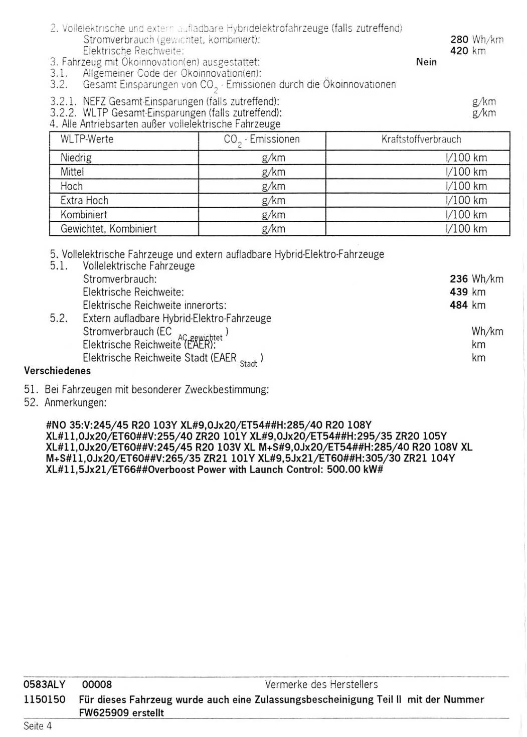

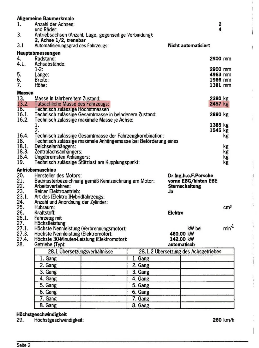

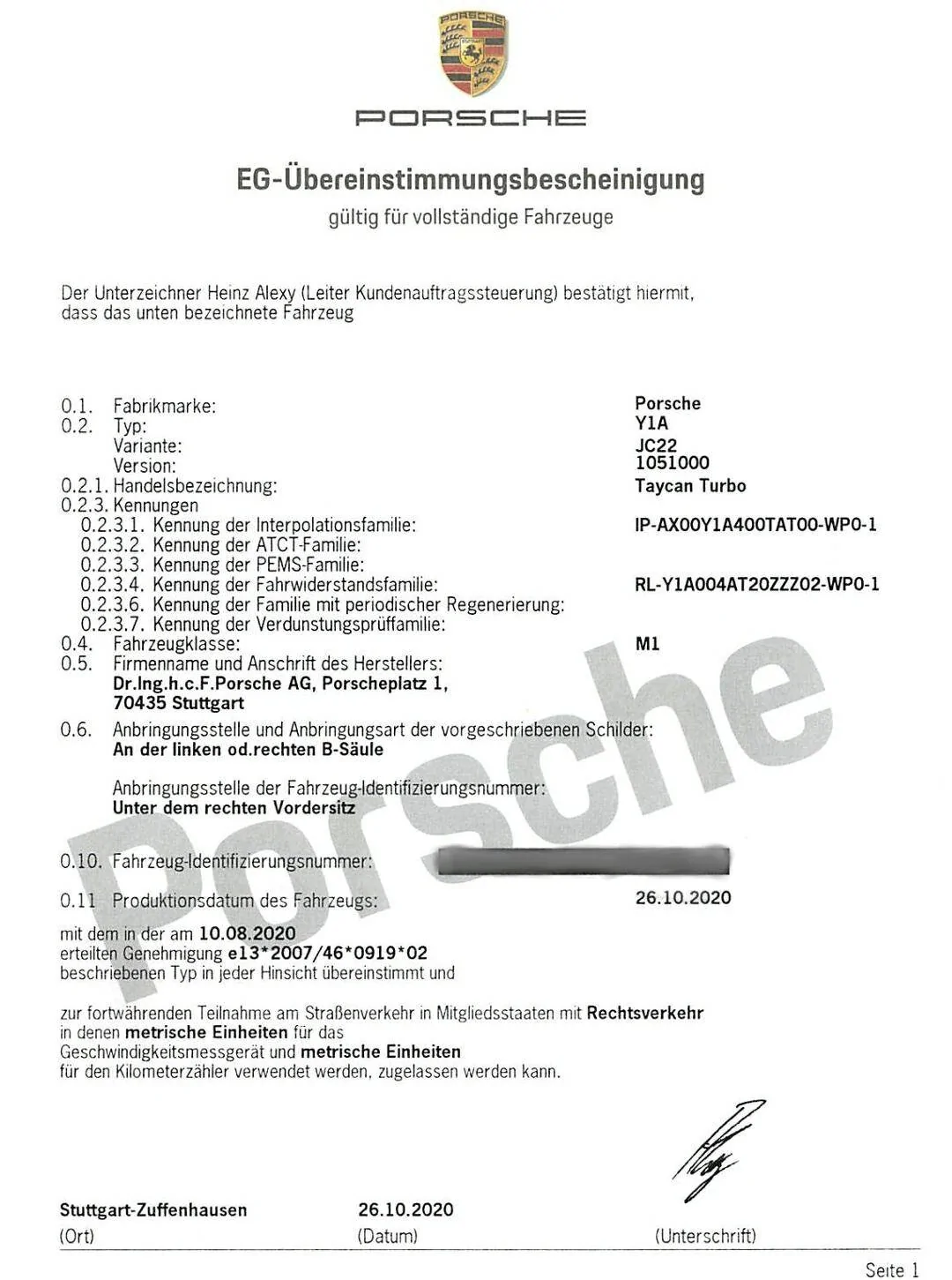

Don't belive the technical spec for unladen weight if you have any options (I believe most of us have :CWL: :CWL: :CWL: :CWL:) as my Taycan Turbo weighs 2457 kg (5417 lbs) empty and my payload is 423 kg (5 larges adults without luggage ;)) , for those interested you'll see below my "EG-Übereinstimmungsbescheinigung" (CoC, EC Certificate of Conformity)
Is this correct?
Yes, that's a photo of the exact decal on my car (42 psi Fronts/ 45 psi Rears /21 inch wheels / TurboS). Was that not clear?
3,046
2,638
I was surprised to see the maximum weight of occupants and cargo! 300 kg for a car that can seat 4 persons.
Maybe all Taycan owners should get a free membership of Weight watchers as well?? ?
If so, I'm in trouble!
BTW - The Cirrus SR22 I just sold was also a "four seater", and its max payload with full fuel was only about 350 Lbs! At least in an overweight car you are not going to fall out of the sky...
