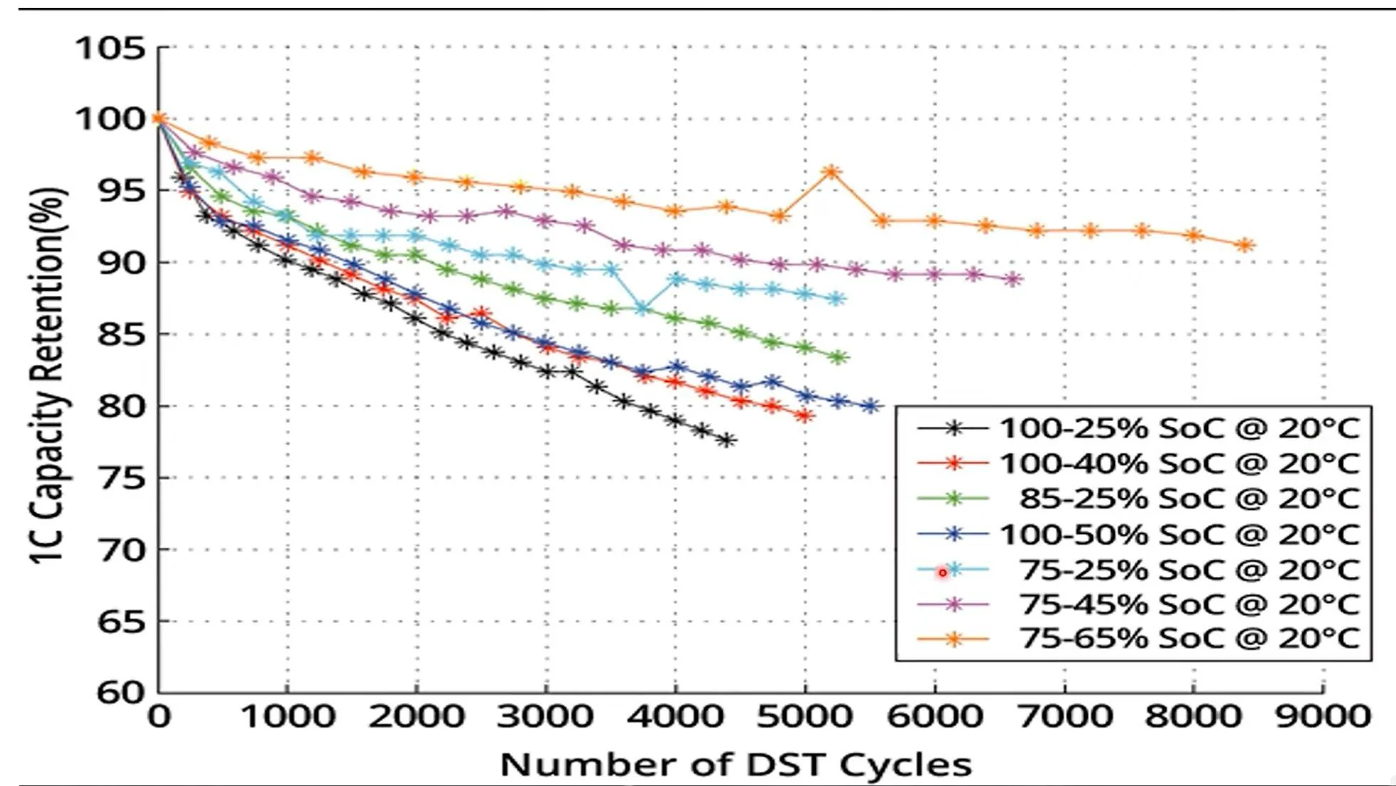

I need to do some research on their methods, but I'm somewhat confused on what a cycle is in that graph. Is it equivalent full discharge cycle or are the cycles of varying depth? If it's the latter, then for a ten percent cycle you have to go out five times further in the graph than with a fifty percent cycle to get an equivalent total consumption and the graphs are misleading.

As @DougFrisk commented, the graph is quite confusing. This is a terrible analysis of data, and completely misses the most important point shown in what is really a very misleading graph. I am no expert in this area, but I can read a graph and interpret simple data. My understanding is that battery life is highly dependent upon the TOTAL charging energy transferred to the battery over its life. That is, how many kWh of energy have I transferred to the battery over its lifetime. At least for the data presented in the video, this is a terribly misleading graph, and the conclusion is not supported by the data shown.
If I charge from 25%-85%, this is charging the battery with 60% of its capacity each DST cycle. For simplicity, let's assume I have a battery with a capacity of 100kWh. This means each charging cycle I'm putting 60kWh of energy into the battery. After 1,000 charging cycles, I've cycled the battery through a total of 60,000 kWh of energy charging. If I charge the battery with a charging cycle of 65%-75%, I'm only charging 10% of the capacity each time, or 10kWh. To get the same total of kWh charging over the life of the battery, I would need to charge 6,000 cycles to get a total of 60,000 kWh energy transferred.
If you want to compare two batteries that have both experienced the same total charging energy over their lifetime, then compare the 25%-85% battery at 1,000 cycles to the 75%-65% battery at 6,000 cycles. Both batteries would have experienced the same 60,000kWh energy transfer over their lifetimes. As you can see from the graph, both batteries (the green line and the gold line) are at about 93% capacity. No difference.

Some of them are directly comparable. The 100% to 40% and the 85% - 25% both cycle the battery 60% on each cycle and there is a significant difference bethwen them. Similarly the 100% to 50% and the 75% to 25% are directly comparable. It would be nice to see a 95%-85%, an 85%-75%, a 75%-65%, a 65% - 55%, and a 55%-45%.
They are defining a charge cycle as the charge from say 65% to 75%, ie only 0.1 of a cycle as known for EV’s. They call Dynamic Stress Test cycle.
The video is not much of value at all.
Yes, this is another significant problem with the data as presented. Everyone will agree that charging frequently to 100% will degrade the battery, so again, this is not a good comparison. To your point, looking at frequent charging of 10% at various levels such as 85%-75% would be a much better comparison. Given the lack of basic good experimental design and data presentation here, I would discount pretty much anything coming from 'The Battery University', which does not have any kind of certification, industry relationships, or peer-reviewed publications in any major journals that I can identify.

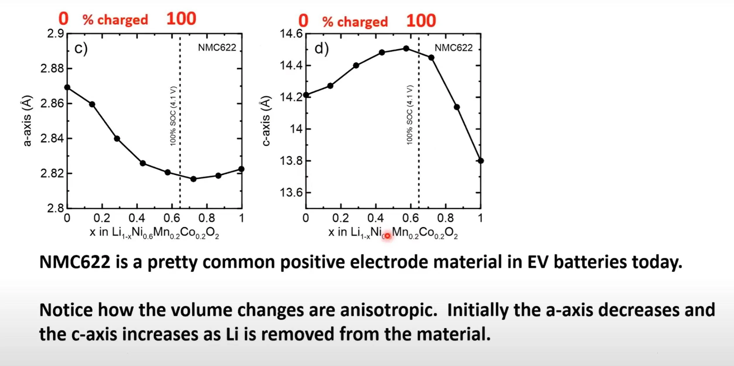

That was fascinating. I was particularly interested in the bits about physical deformation of the electrodes during charge and discharge causing microcracking. The Taycan battery is NCM712 so probably close to the 811 chemistry in these graphs and he stated that the dips at the higher states of charge correspond to large physical changes in the electrodes.
Porsche Taycan "Best practice EV charging for longer battery life" - video 1700244161080
Minimizing mechanical stress on the electrodes would be a matter of finding the points on the graphs below where the slope is minimized across both graphs. For the a axis that appears to be between 60% and 90% SOC and for the c axis it appears to be about 40% and 75%. Again, the Taycan uses 712 and these are 622 so not exact, but possibly a good proxy. So it seems you may be able to minimize mechanical stress and with it microcracking by aiming to charge to 75% on a daiiy basis. Which turns out to be the exact number he suggested.
