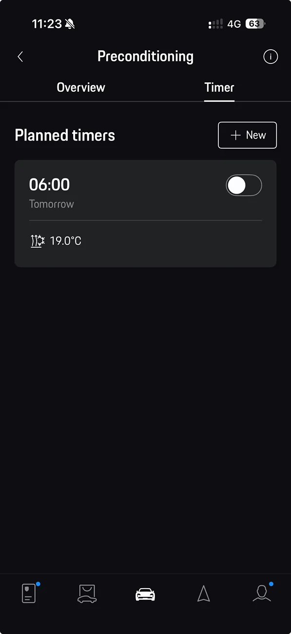

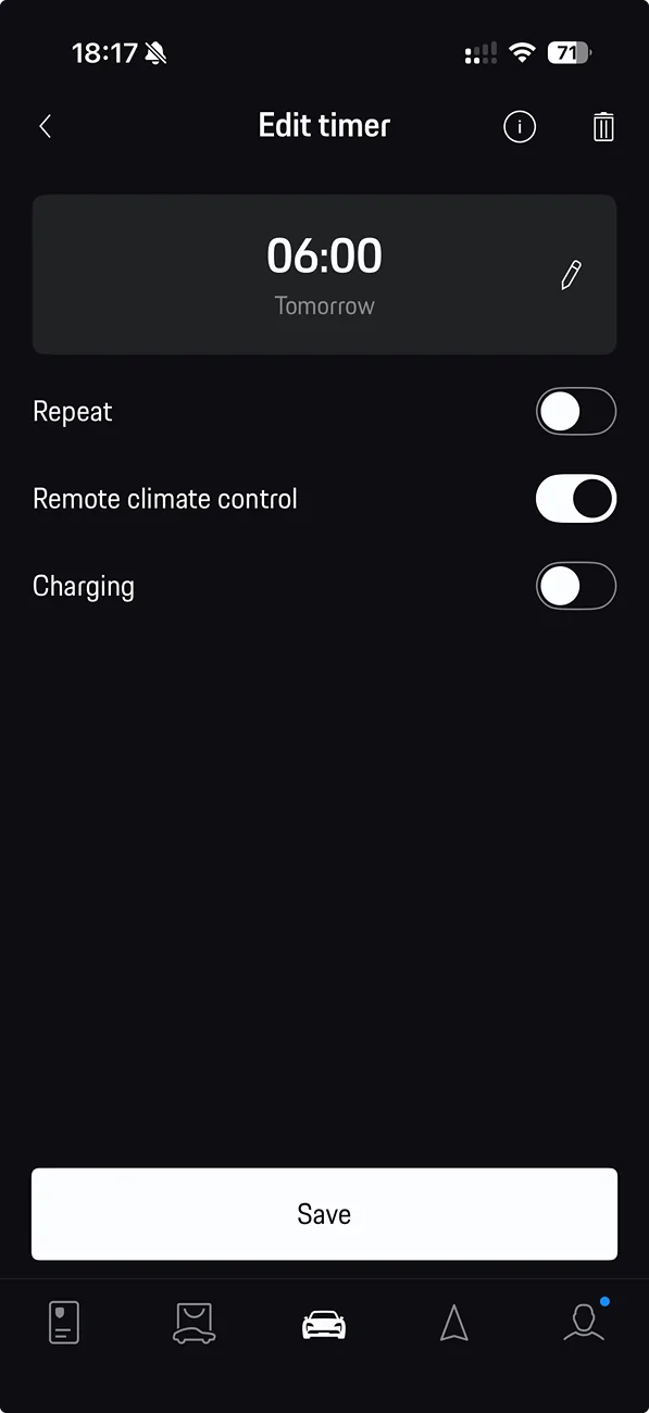

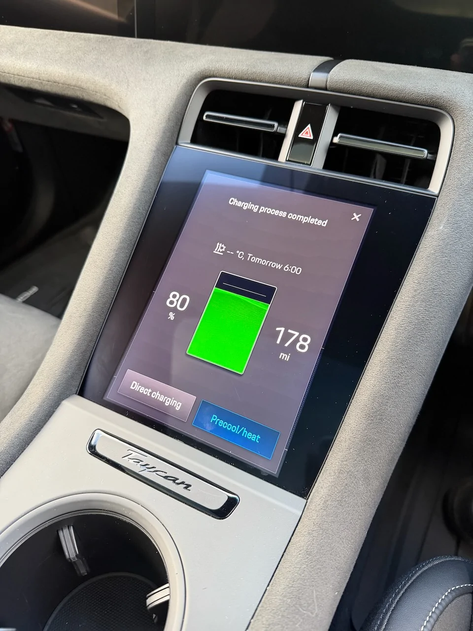

I just enabled my timer for 0600, sent it to the car then, after it'd sent successfully, walked out to the car to see what it looked like.
Timer in app:

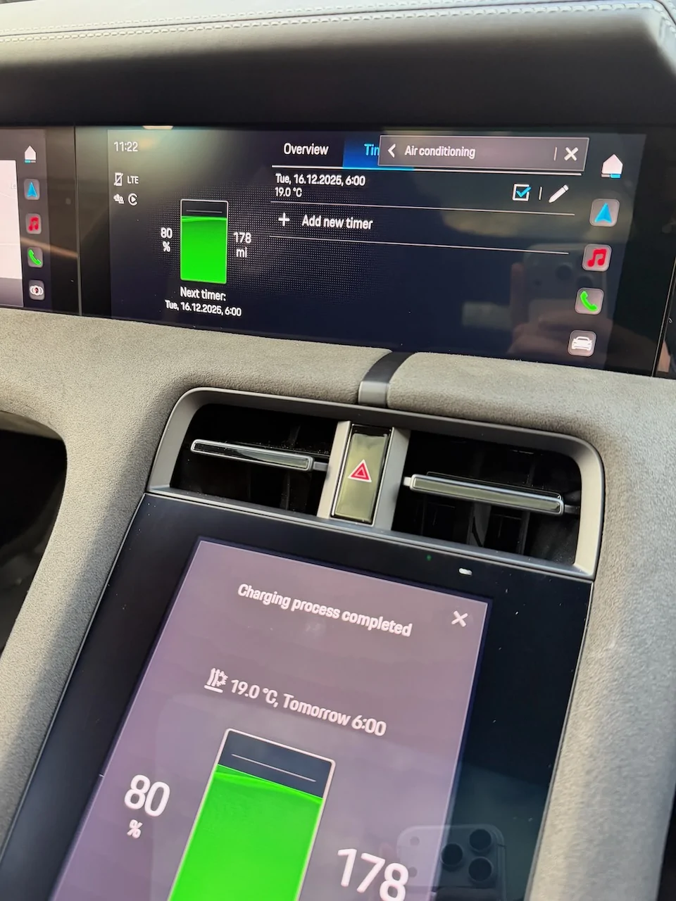

View in car when I first got in (note: the '--c' is curious...):
Porsche Taycan Cabin preconditioning - have I got it wrong? IMG_1346

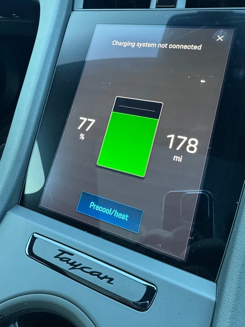

And after PCM had booted enough to let me access the climate menus:
Porsche Taycan Cabin preconditioning - have I got it wrong? IMG_1347
So all looks ok. Although I do wonder if the '--c' view at first meant it hadn't synced properly until I turned on the ignition..? Seems unlikely given it had the correct time.

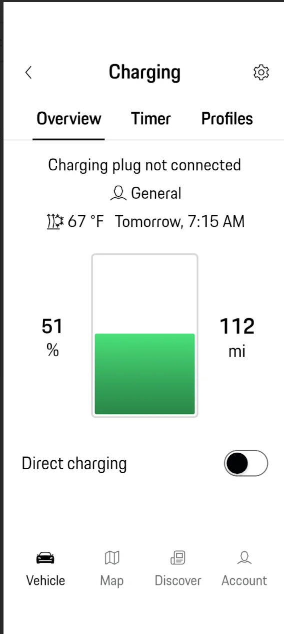

I’ve not touched the setting on the console, but this is how it is currently. I should add Octopus controls the charging on my car and add charging timers and would delete any climate timers I have set when they do that. Therefore I only set climate timers occasionally, when there’s no charging due, most of the time I do it on demand from the app.
Porsche Taycan Cabin preconditioning - have I got it wrong? IMG_2389

Perfect!
The temp will be whatever you last left the in car setting at unless you've overridden that in the App. Essentially will default to last used setting - 19C in this case.

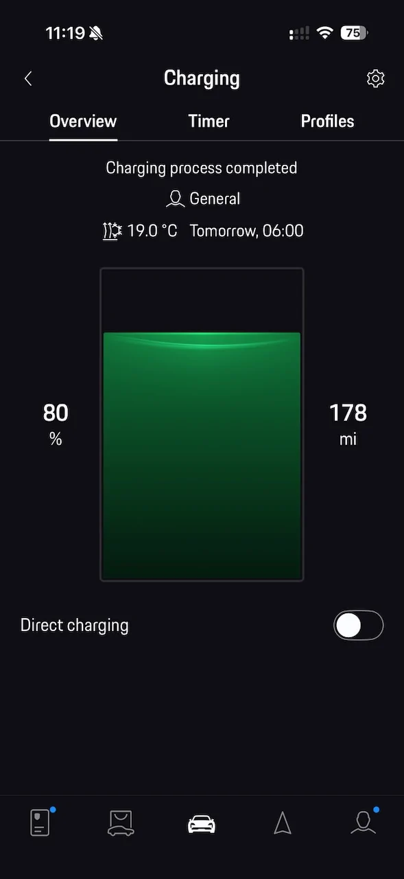

Right, I see. I haven't done anything different this time, to what I'd done the other times, except for going out to the car and checking what was set in there... So it'll be interesting to see if it works.
edit: Although the climate in the car was last set to 20, not 19.

But you have set 19C in the app which takes precedence if you use the app to set the timer. If you set in car to say 21 lock the car and then check the app for your next preheat it should show 21C.

Sure, but my confusion was that it said neither (at first), implying it was missing some parameter value.

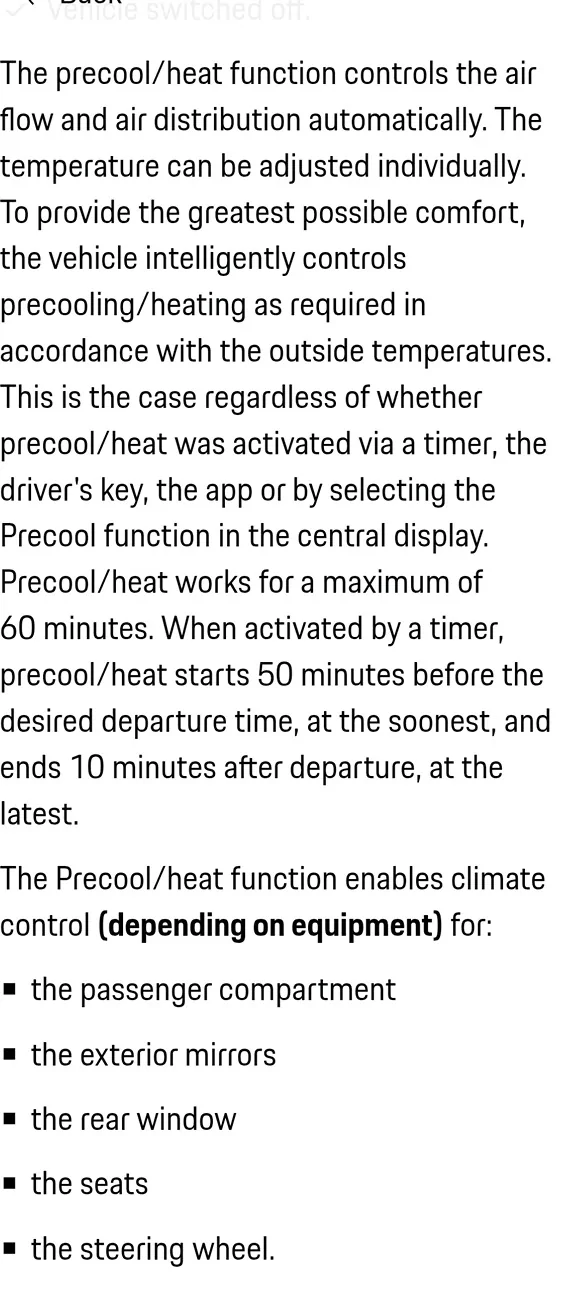

I tested mine and it worked as expected. I set it as a one time Tomorrow Timer with Pre-condition cabin, see settings, and this morning I got a message in the App that it was done, I checked the car and sure thing it was pre-conditioned as programmed. Then as expected, the Timer is on the Off position after it ran since it was a one time.
