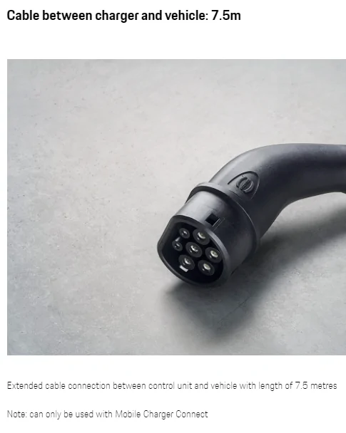

Order the 7.5m cable for your charge point to car - it's free and the extra length useful.

For the 7.5m cable you have to have the mobile charger connect. Looks like it won't work with the ordinary mobile charger
