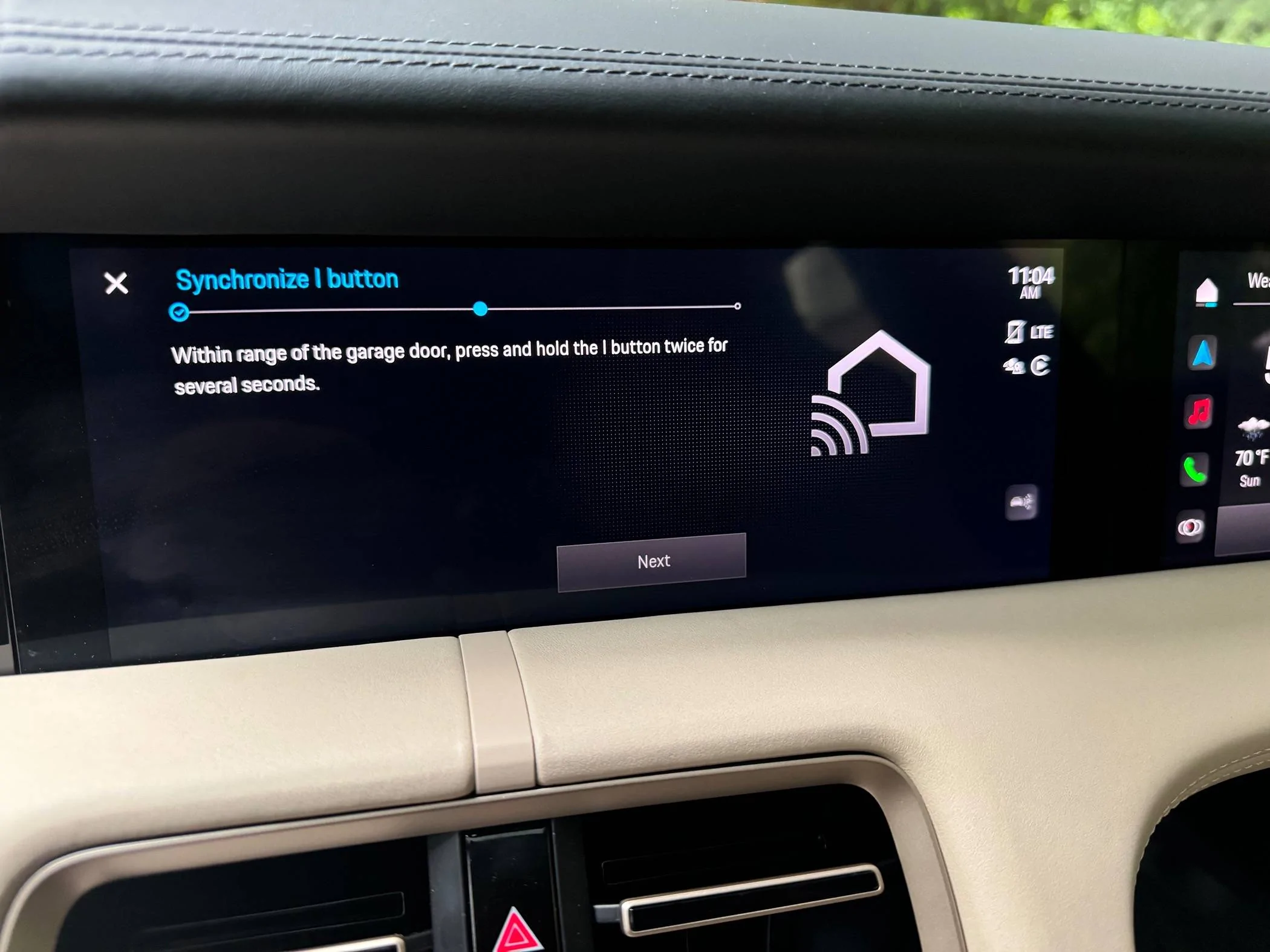

See, you can’t get past this step because it wants you to press the car’s homelink button but there are no buttons to push! All this technology and I’m back to this!

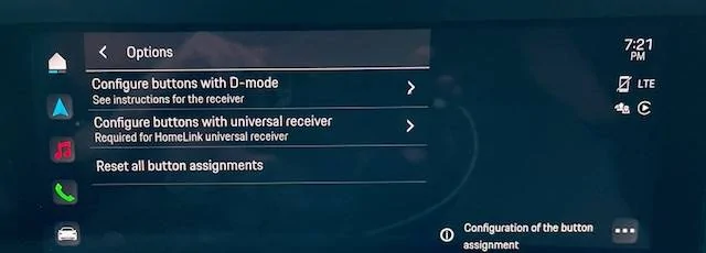

I should clarify that if you press the three dots at the lower right side of the first homelink screen, it takes you to this screen:
Porsche Taycan Can't set up a Homelink IMG_4504
However all of the options lead you back to the screen where you need to press button I.

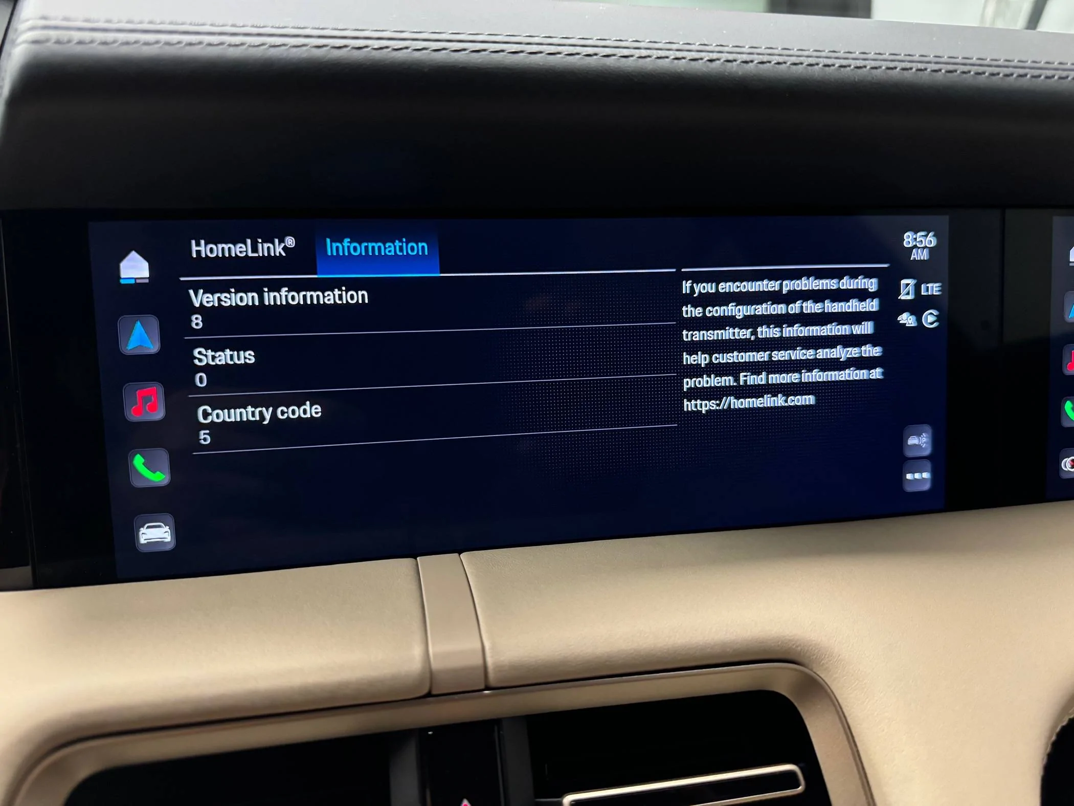

Just got my 2022 GTS back from dealer today, and I have the exact same problem. HomeLink data wiped, can't open the garage doors, no i, ii, iii buttons on the roof button panel. Quite frustrating...
What did the dealership do to your car?

Hmmm, I’m pretty sure lots of other people on this forum got the WPN9 update. What does your car say the software version is? IIRC it should be 3882.
My PCM software version is 3882, MPR3_US_POG46_K3882
Well that is concerning. You seem to have the same version as multiple other people on here that have not reported this Homelink issue. I was planning to get the WPN9 update applied to my car in June but I don't want to if this issue will prevent me from using Homelink.
