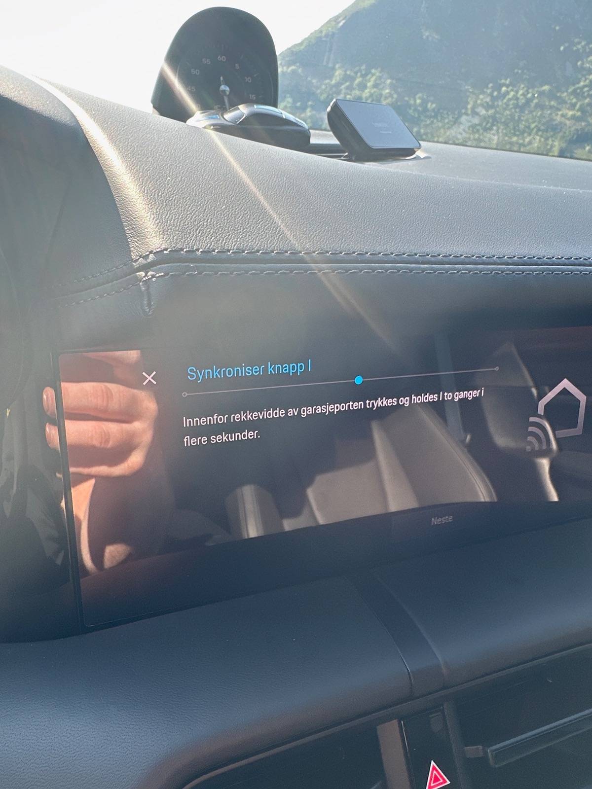

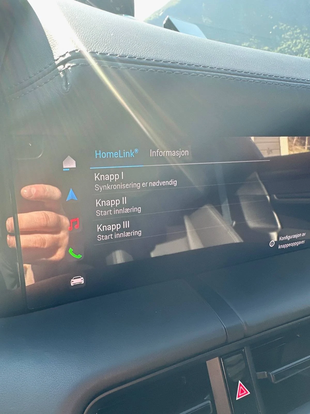

Same happened to mine My 22 after service and PCM programming. Anybody with same issue that got this fixed?
I had these recalls:
WNB4 replaxing movement detector
WNJ8 update to software network VR 19.0.1
WNK7 replace antenna cable plug connectors
WPL8 replace electric passenger compartment
Porsche Taycan Can't set up a Homelink image0
Porsche Taycan Can't set up a Homelink image1
Actually this looks different to the OP's issue - the Homelink icon on the right of your image isn't showing the 3 button one from the OP's post and there is no option to learn / change to the correct type - use transmitter. Looks like a software package destined for the Macan (not latest model) found its way to the Taycan which is pretty poor if that's the explanation.

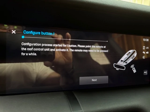

I got a call from the service manager at my dealer (Porsche Reno) and they have acknowledge the problem and are working with PCNA on a solution. Apparently the new Taycans have these buttons and they are updating our older car with the software for the new cars. I am waiting for them to come up with a solution - I assume a version of the software that doesn't need the buttons.
11,078
6,858

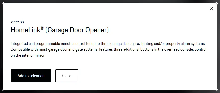

Aha - that now makes more sense rather than the Macan muddle. A quick check on the confuserator now details MY25 Taycans with 3 buttons - sad really, the current implementation is great and no buttons required. Hopefully, the diamond button assignment will still be possible.
They'll have the software but not need to figure a simple way to check the model type / year and apply an 'either / or' to load the correct software package.
Yes, that is what I was told too. I checked the 2025 manual, the buttons are now on the mirror.....similar to the new Panamera. The manual shows a different screen image compared to what I see.
Porsche Taycan Can't set up a Homelink image003
However, maybe it is a mixture of both. A little big of Macan with some sprinkle of 2025 Taycan, and this is what you get. :CWL:
