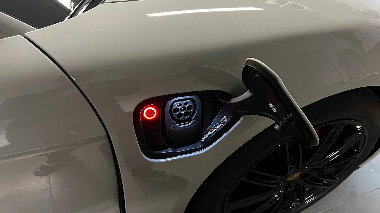

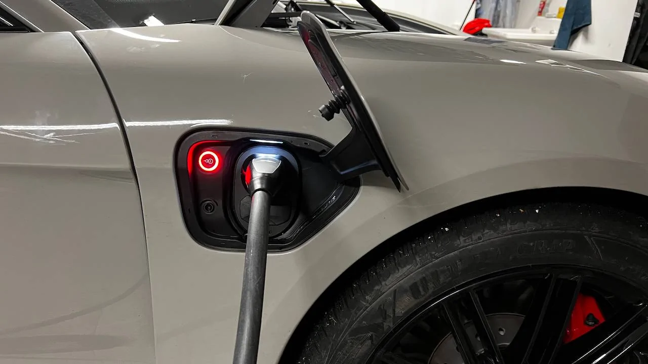

Unfortunately manual cover doesn't help. I have it, forced opened it, but charging also blocked electronically if there is a door problem. It happened with me on the DC side as well, so up to the service repair only AC charge was possible on the other side.
Porsche Taycan Charging Port Impaired - "Left (or right) charging port impaired" error message IMG_4935
Porsche Taycan Charging Port Impaired - "Left (or right) charging port impaired" error message IMG_4966
