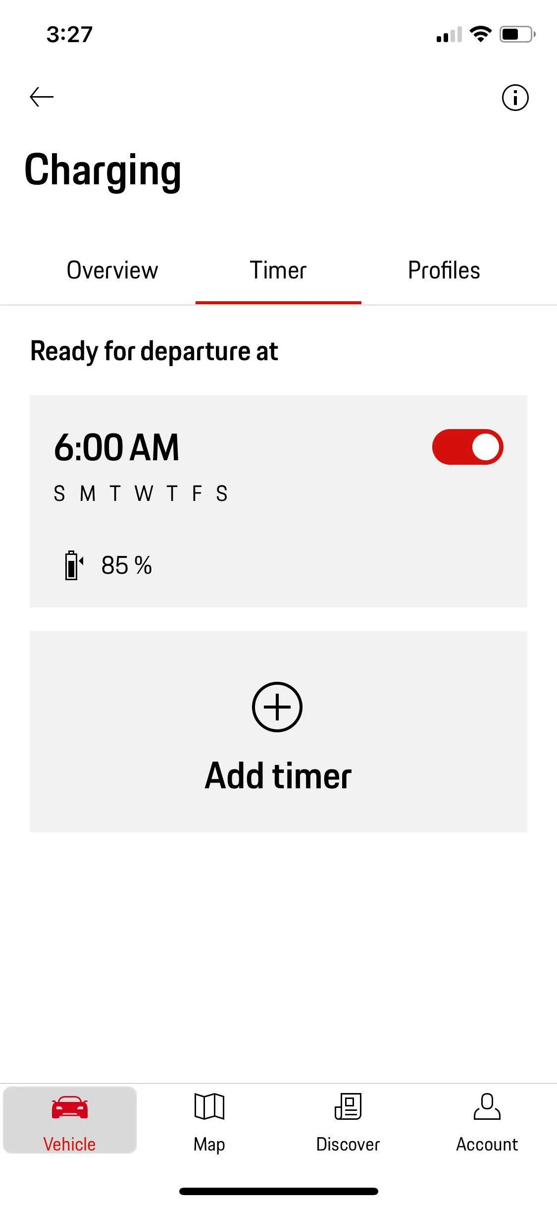

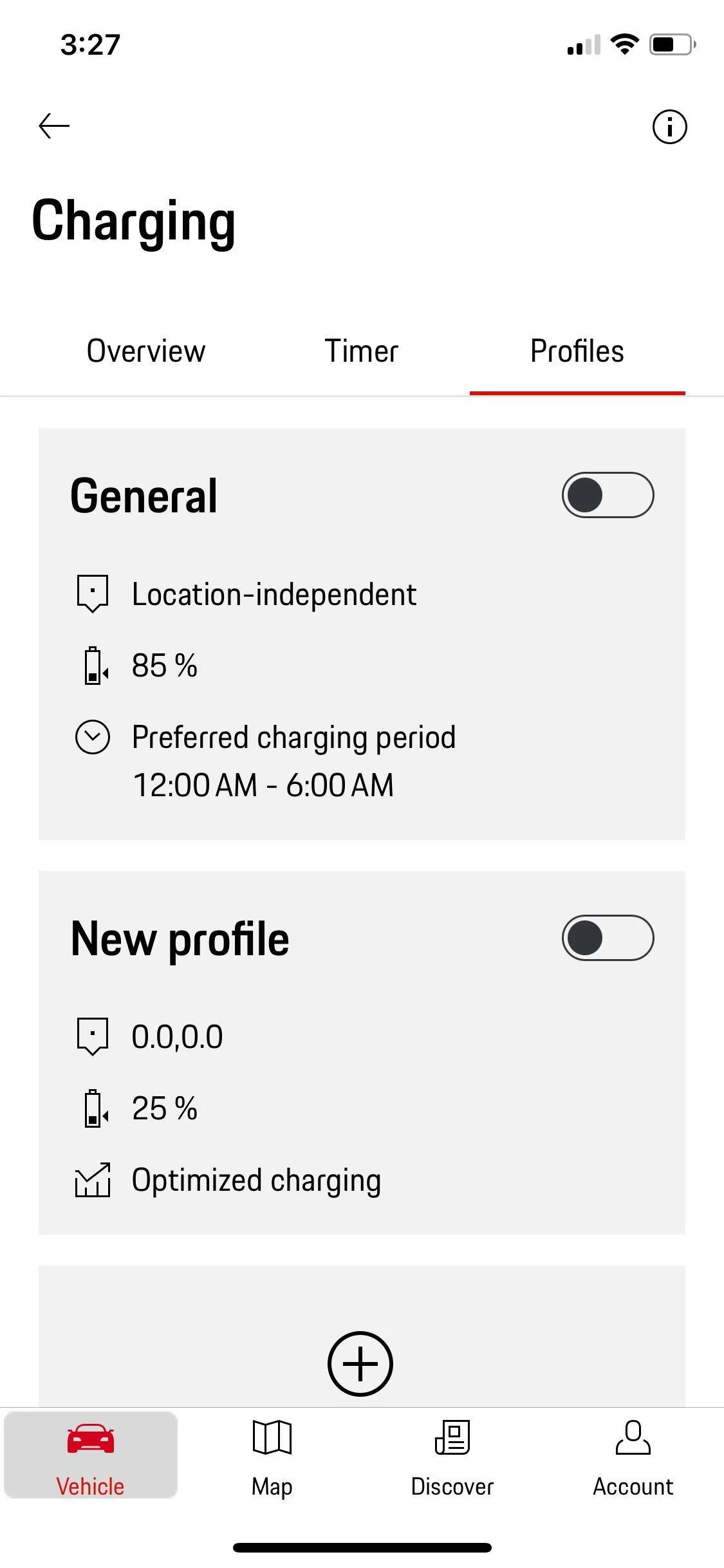

I'm plugging in around 7pm or 8pm
Porsche Taycan Charging Timer IMG_2792
Porsche Taycan Charging Timer IMG_2796
Porsche Taycan Charging Timer IMG_2795

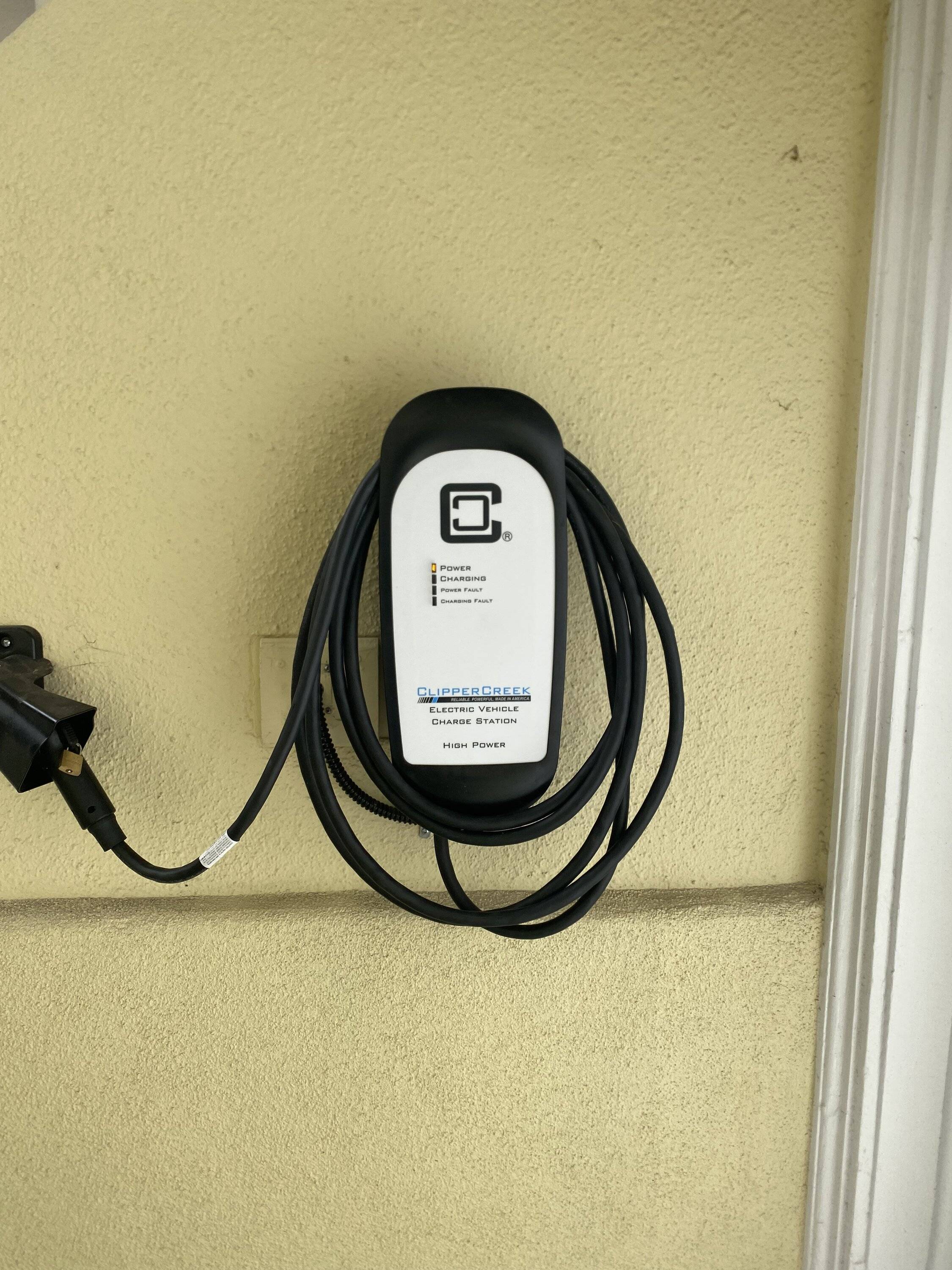

Do you know how many kW or amps that Clipper Creek is? Is there a label on it?

Clipper Creek (installed Nov, 2022) 32 Amps, Level 2, 240 Volts

Minimum was set at 85% in error

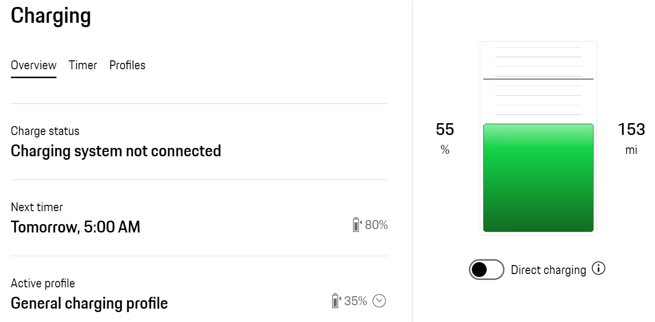

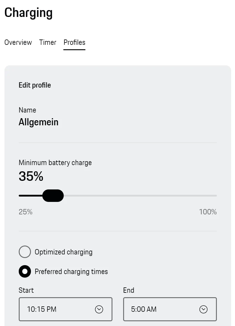

FWIW, there seems to be a lot of confusion about profiles and timers. There's another thread here with conflicting information as to how all the options work separately or together, and I'm not sure how country-specific it is either.
For me in the US, and from what I've learned on this forum, here are my settings. I plug in whenever I want and the car will only begin immediately charging if the SOC is below 35%. Once it reaches that threshold, or if it's already above 35% as shown below, it will pause and then begin charging again sometime after 10:15 PM in order to reach 80% SOC by 5:00 AM the next morning.
For me, this works like a charm.
Porsche Taycan Charging Timer Overview scree
Porsche Taycan Charging Timer Profile scree
Porsche Taycan Charging Timer Timer scree

This turned out to be a simple problem.
Instead of the minimum being set at 25, it was set at 85. Thanks for your help.
