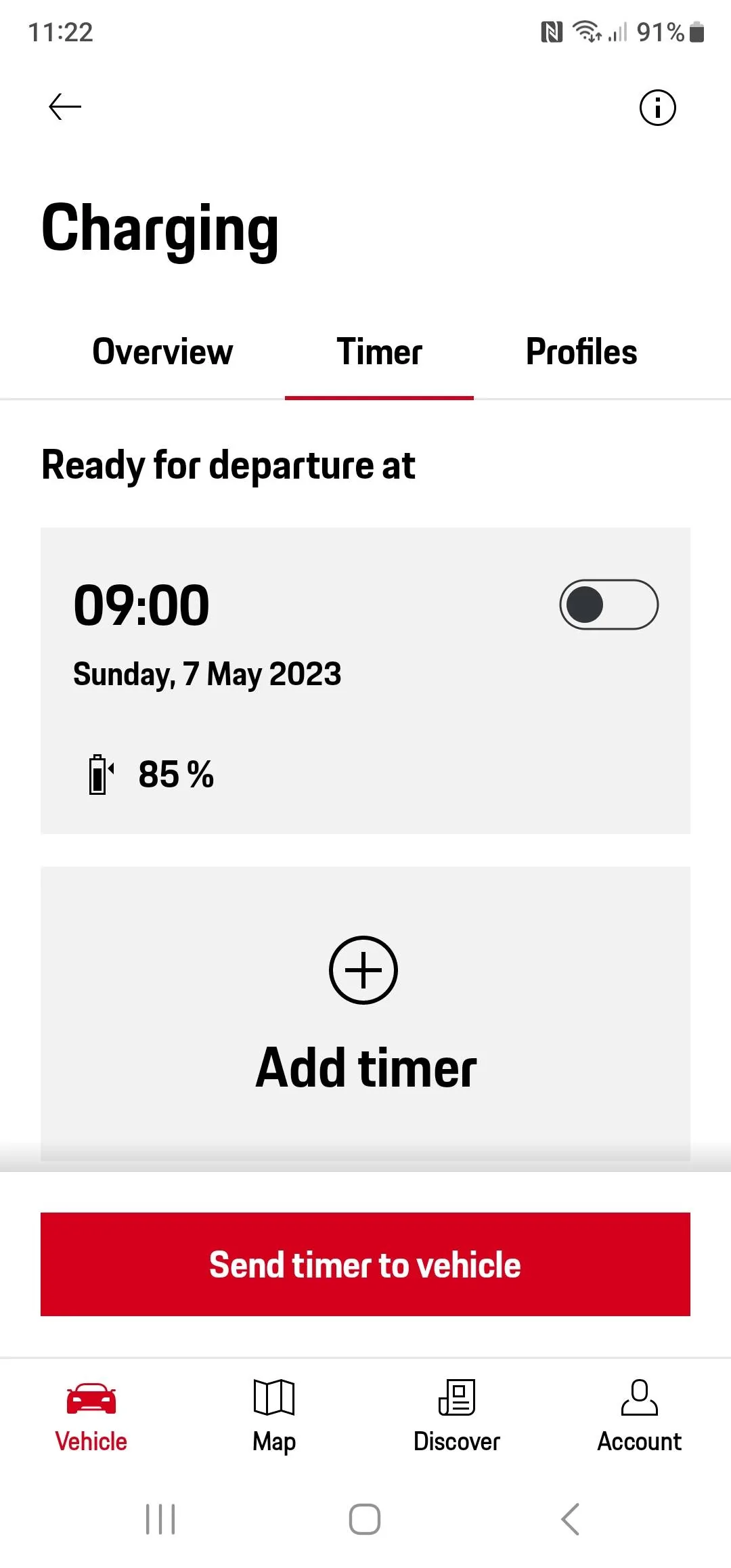

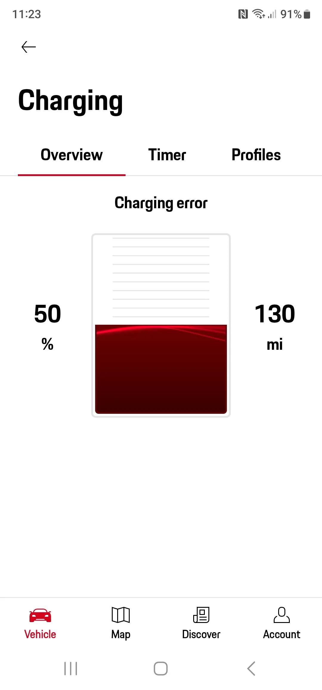

Looking for advice. Eventually decided to try the timer on the car as attached. However, plugged into the home EV box and the car reported an error at 50% but should have charged to 85% . No programs/schedules saved on the actual EV home box.
Any advice?
Thanks

It happens sometimes and it maybe the EVSE as much as the car. I had a problem with low voltage at home which was definitely causing the EVSE and I think the car as a consequence to throw errors.
I'd suggest unplug it. Lock the car and reboot the EVSE. Maybe try plugging in to the opposite charging port you were using too.
I wouldn't worry about it unless it does it a lot.

Mine did it this week too, but I wrote it off as an app error. It also showed the incorrect charging speed while it was charging (app reported 2.2kW, the EVSE and car were up around 9kW). In the morning, the app showed a charging error at 99%, the EVSE was reporting the charge completed and the car wasn't showing any error either.
