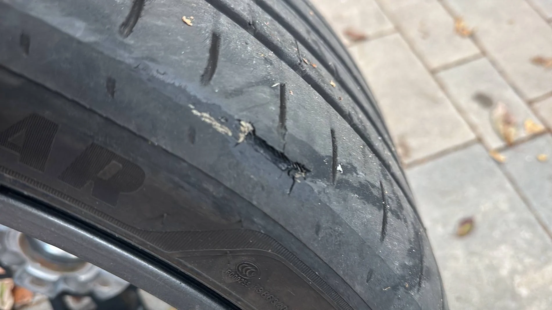

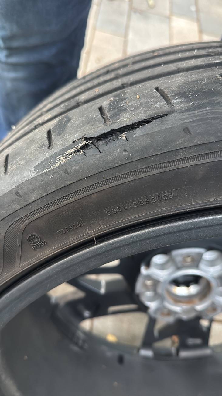

Changed my wheels to winter set-up a few days ago.
It was an "early round" and I'm very happy I did it.
n both front tires the carcas shows on the inside.
No way visible, when tires are on the car.
BTW: good time, to buy a new summer-set:
Got a set new Goodyears 21" Assymetric 5 NF1 for € 1100,- , including 24 months tire insurance.

And this is a classic example of why Porsche needs to look at the setup of the car.
Yours, same as mine, look to have plenty of tread left over the actual tread width, but the corner edge of the tyre is worn so badly it's through to the cords.
That's not right.
Am going to see how my latest set wear and then have a more earnest chat with Porsche on this.
To the poster above that notes about handling, how much better might the car be if it were using the whole tread width properly! Although every time I look at cases like this one, it looks like it is....it's just that corner is getting worn excessively.

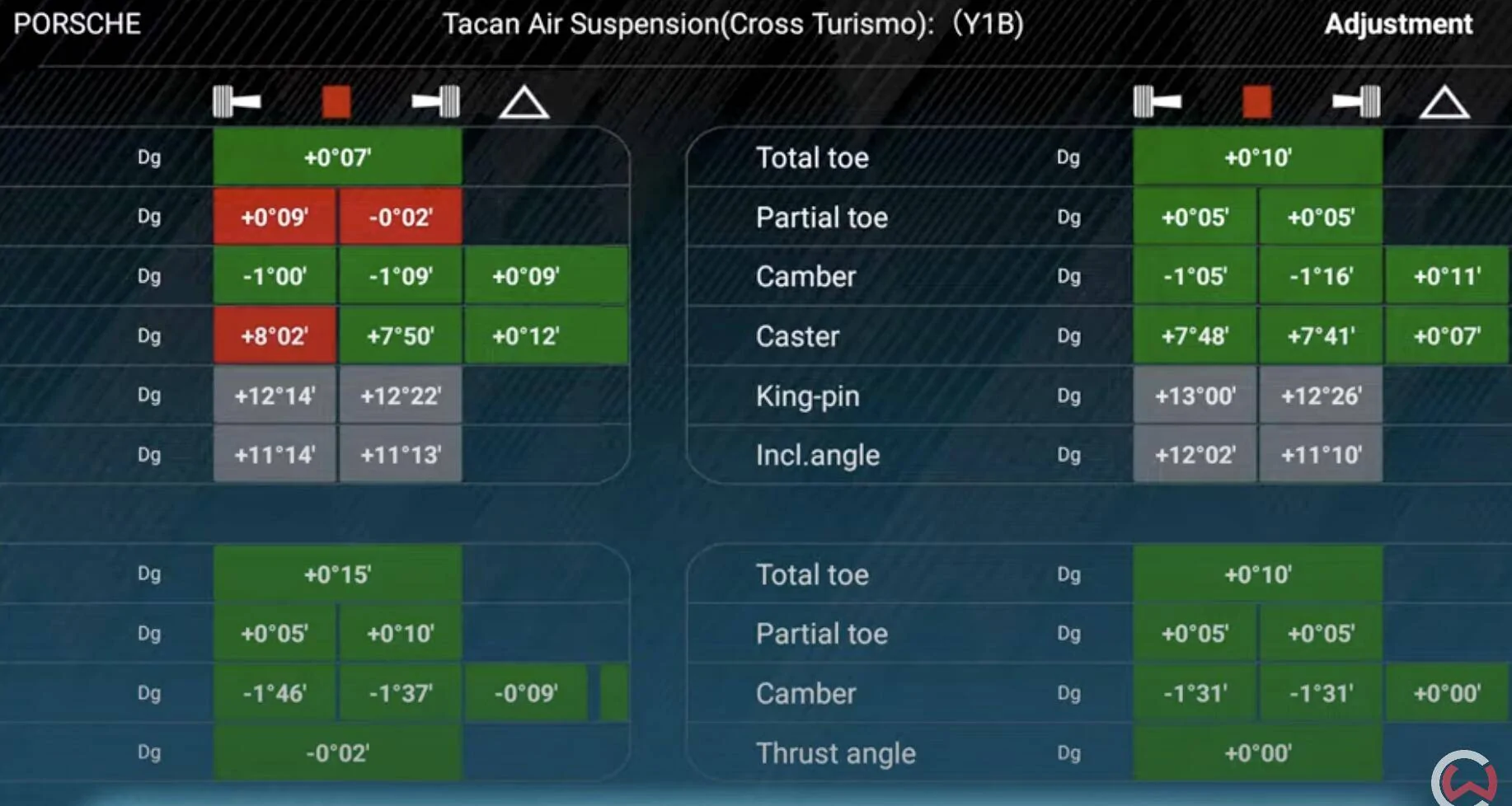

darrenfx
Singh
Sep 4, 2024
Bay area, california
Taycan Turbo vs Model 3P vs Mazda Miata NC2
Taycans have very aggressive negative camber, and positive caster of which camber can go out of spec as explained in:
You can reduce camber, toe and still stay in spec, and reduce the wear significantly
Before (left) and after (right)
