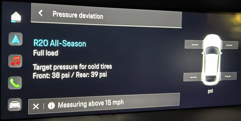

Do you know what the pressure specs on these tyres are? I've asked Porsche several times but they are not very helpful. They told me to use the PCM pressure measurements and top up as appropriate
87
8,202
7,236
If you tell your PCM what tires (size, summer/winter/all-season) you have, along with full or half loading, it will tell you what tire pressures are expected.
Porsche change them, and I've checked and it's all correct, so that's what I'm using. It would just be useful to see the specs written down somewhere ;)

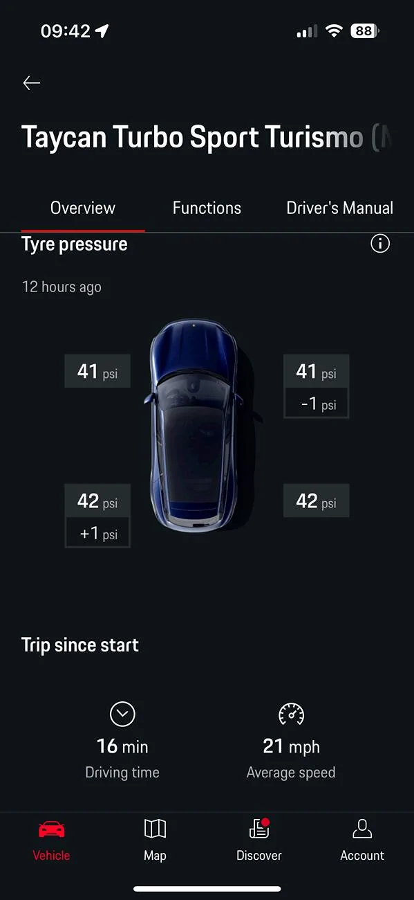

It’s not always that helpful - see picture
The PCM will actually show you the expected cold tire (I think that's at 10C, from my experience) absolute pressures. I usually start there, then adjust +/- 1 after a day or two and driving a few miles. This is what the PCM screen looks like with target cold pressures:
