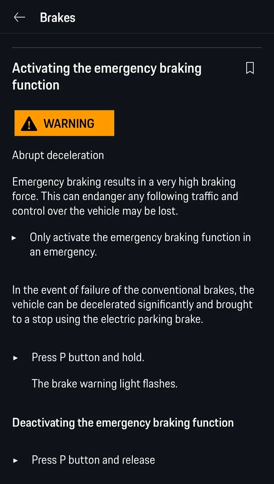

As others have said, thank you very much for taking the time to respond to all these questions. One thing many of us learned as a result of your misfortune is that there is an emergency brake in these cars. I've been on the board and other places for a year and never heard of a brake failure. Maybe others have? That would suggest maybe not a bad design but a bad part. But who knows. I apologize if you said, but on which corner was this flex line located? I would not be surprised if the part was shared with other Porsche models like the Panamera.
+1 but don't forget the emergency brake is not unique to the Taycan - all cars have this feature which have the electric switch for activating the "handbrake" for many years.

Sounds like a failure of the manual brakes, not the regen braking. I've had that happen in ICE cars I've owned, only two in the almost 60 years I've been driving. One was caused by a master cylinder failure the other by a broken brake line. Once the cars slowed down I was able to stop them with the emergency brake.
It sounds like something similar where the regen braking slowed the car as it would normally but when you got below the threshold where the manual brakes take over they failed. I wonder what the equivalent of an emergency brake is on an EV?
Porsche Taycan Complete brake failure !! IMG_1511
