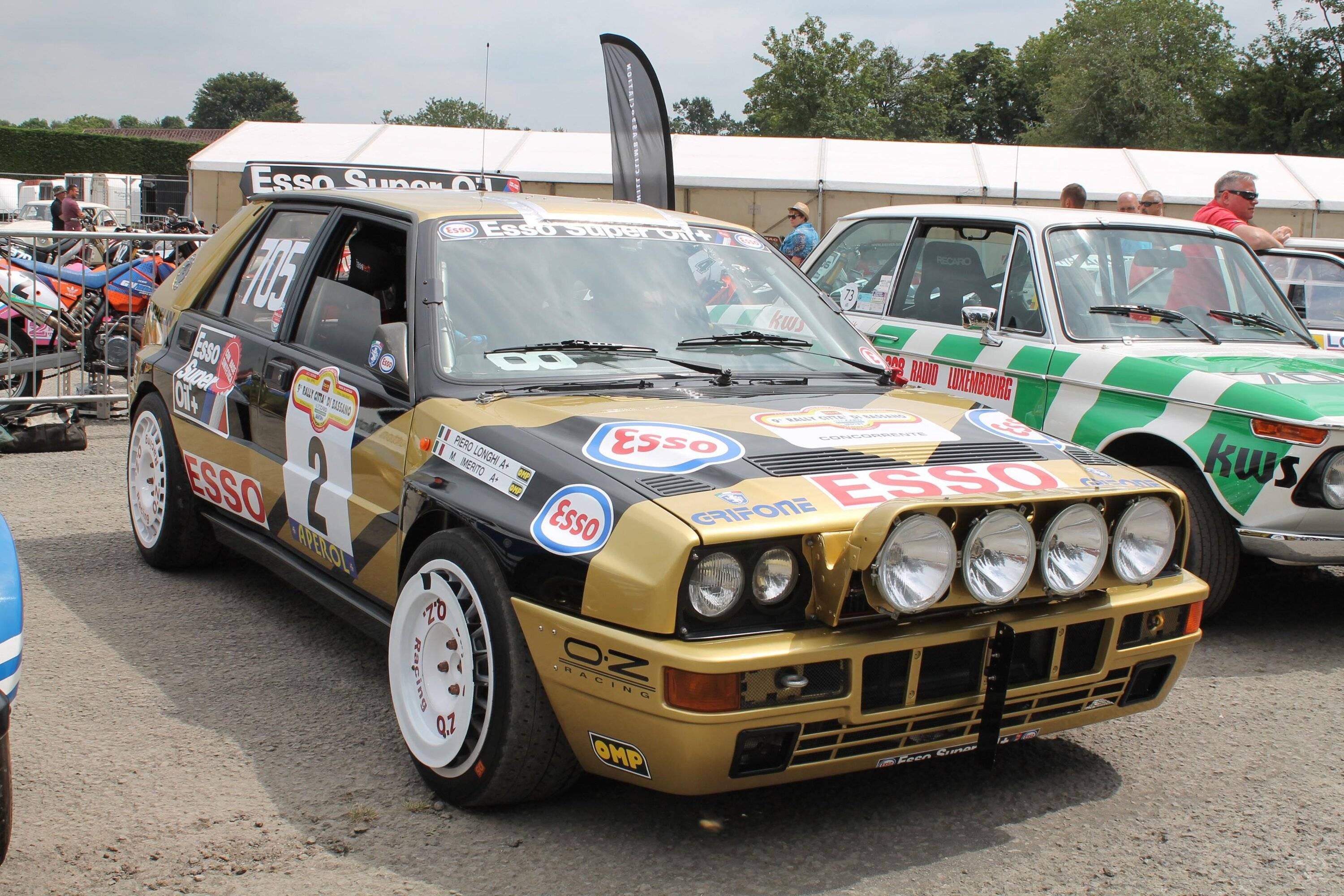

This is a Lancia Delta on a tarmac stage in the good old days.
Gravel stages aren't that demanding on brakes (less grip) so that's why you only see it in this set-up.
Modern rally cars have bigger wheels and I suppose they don't need the aero disks anymore cuz of improved brake design and bigger, open wheels.
Or the benefit wasn't that big and/or others just didn't bother.
I don't know if wheel design is in the regulations nowadays though...

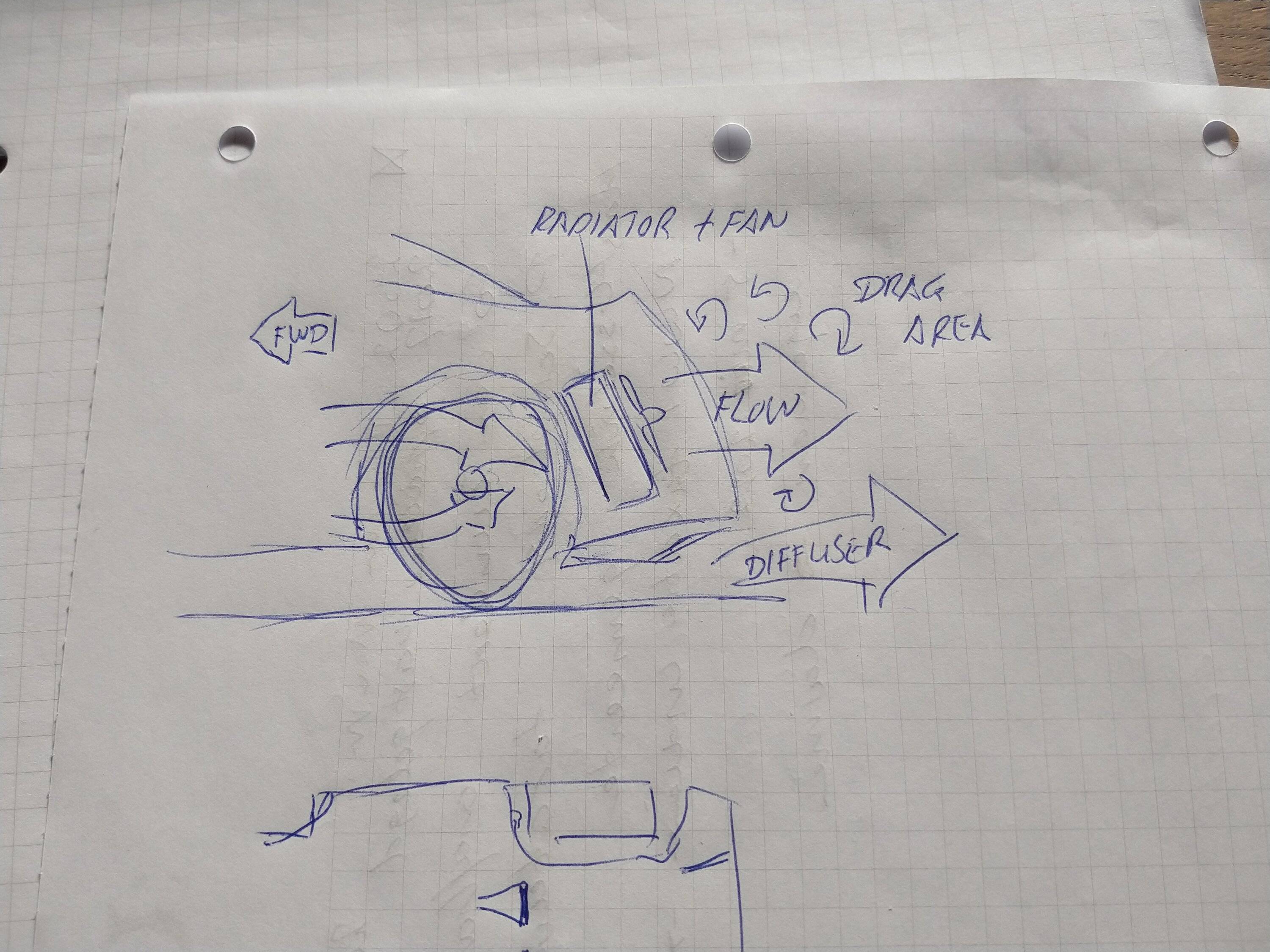

It would make sense to put radiators in the back:
Porsche Taycan Cooling Modifications Experiment for the Track: more air flow through radiators to keep battery temperature down IMG_20221106_113732880
1. It may reduce drag at the back (improves efficiency).
2. Flow from the sides goes into the rear wheel well and also may contribute to reduce drag at the back.
(No high pressure in front wheel well any more, new wheel designs incoming as well).
3. It may be even an idea to create a blown diffuser, like Brawn Racing did in F1 which will improve handling at high speeds.
Gordon Murray also uses a fan in his T50 to force the diffuser to work more efficiently although it spins at high rpms to achieve that...but hé, airflow is airflow.
4. You don't need cooling openings at the front anymore (except brake ducts) so it may improve overall Cw value and therefore efficiency.
With the coming of EVs there are new possibilities.

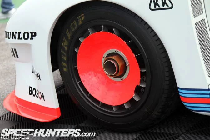

It was mainly for cooling the brakes (Porsche 935).

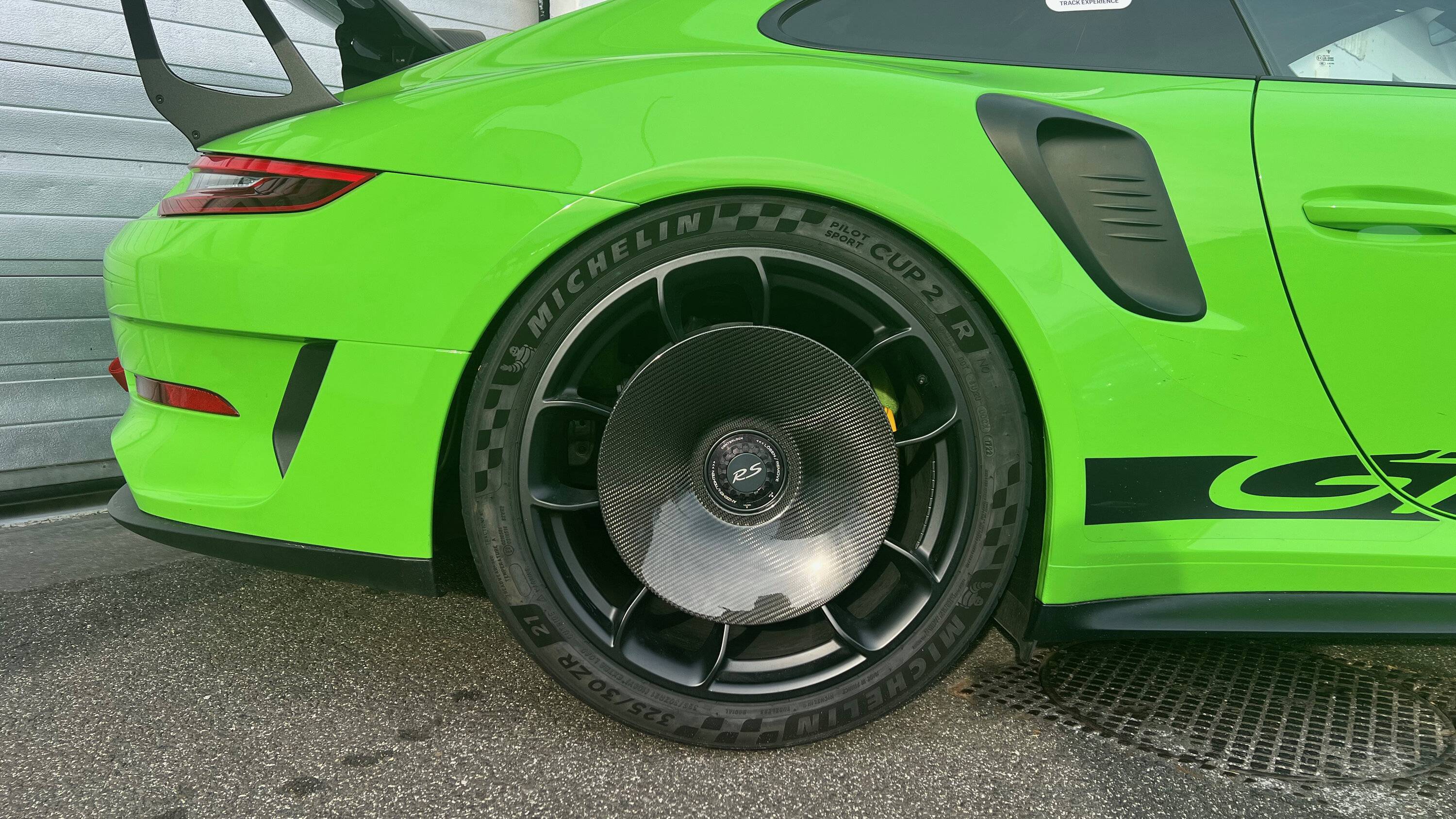

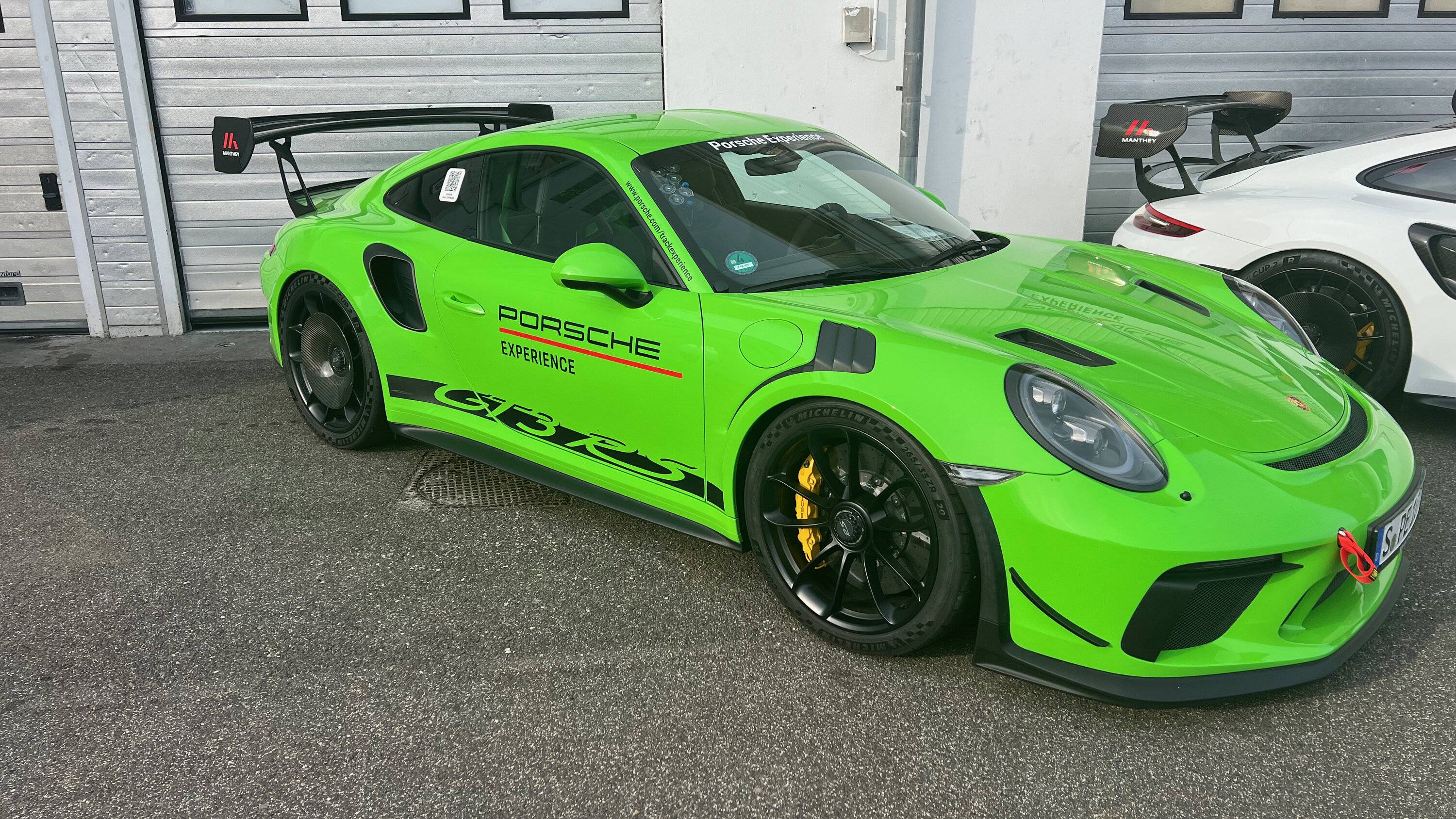

I think Rotiform has these wheels with aero disks if I'm not mistaken.
Manthey uses similar on the latest 911 GT developments but only on the rears.
Porsche Taycan Cooling Modifications Experiment for the Track: more air flow through radiators to keep battery temperature down IMG_4206
Porsche Taycan Cooling Modifications Experiment for the Track: more air flow through radiators to keep battery temperature down IMG_4207

Isn't that just for looks?
Love those wheels btw.
Maybe for aero or heat (cuz of rear motor set-up)?
Nothing for the looks on their cars 100%. Manthey Racing (911) cars are the fastest on Nürburgring Northshleife. Everything on their cars with purpose.

Aero wheels for drag reduction, yes. The cfd study I referenced in my previous post looked at several configurations. I was only referring to the efficacy of the 935 style wheel in pumping air out for brake cooling.
