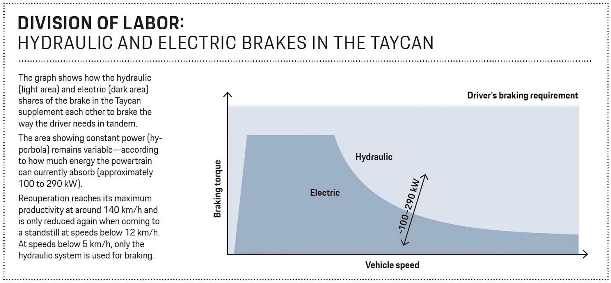

So it has to detect an upcoming vehicle to allow a deeper degree of recup/regen which presumably then reaches a deceleration level that triggers the brake lights?
…and you’re 100% confident that in this process there is absolutely no mechanical brake blending / assistance whatsoever?
that’s my experience.
Its never braked significantly under auto-recoup (but way more than normal recoup). I’ve watched the green recuperation bar and I’ve seen it swing to roughly 3/4 of max, but it’s never got to full, so I’m pretty certain it’s never got close to using mechanical brakes.
