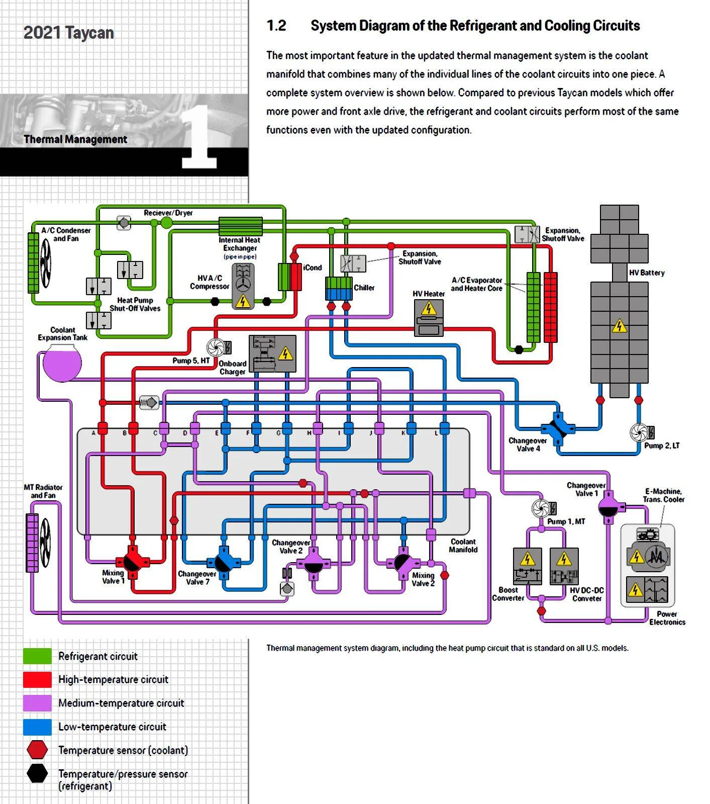

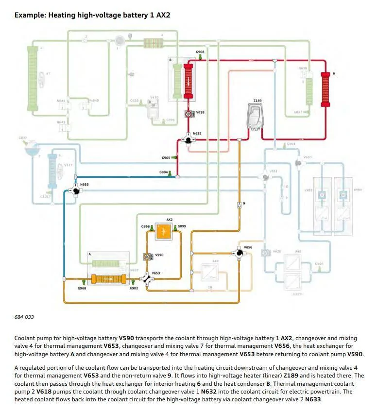

The self study guide for the e-tron GT has 30 odd pages and some 15 circuit flow diagrams devoted to the various heating and cooling modes and of use of the heat pump function, AC circuit, and HV heater, including the battery, drives and power electronics as heat sources variously to move heat and cool things about the place.

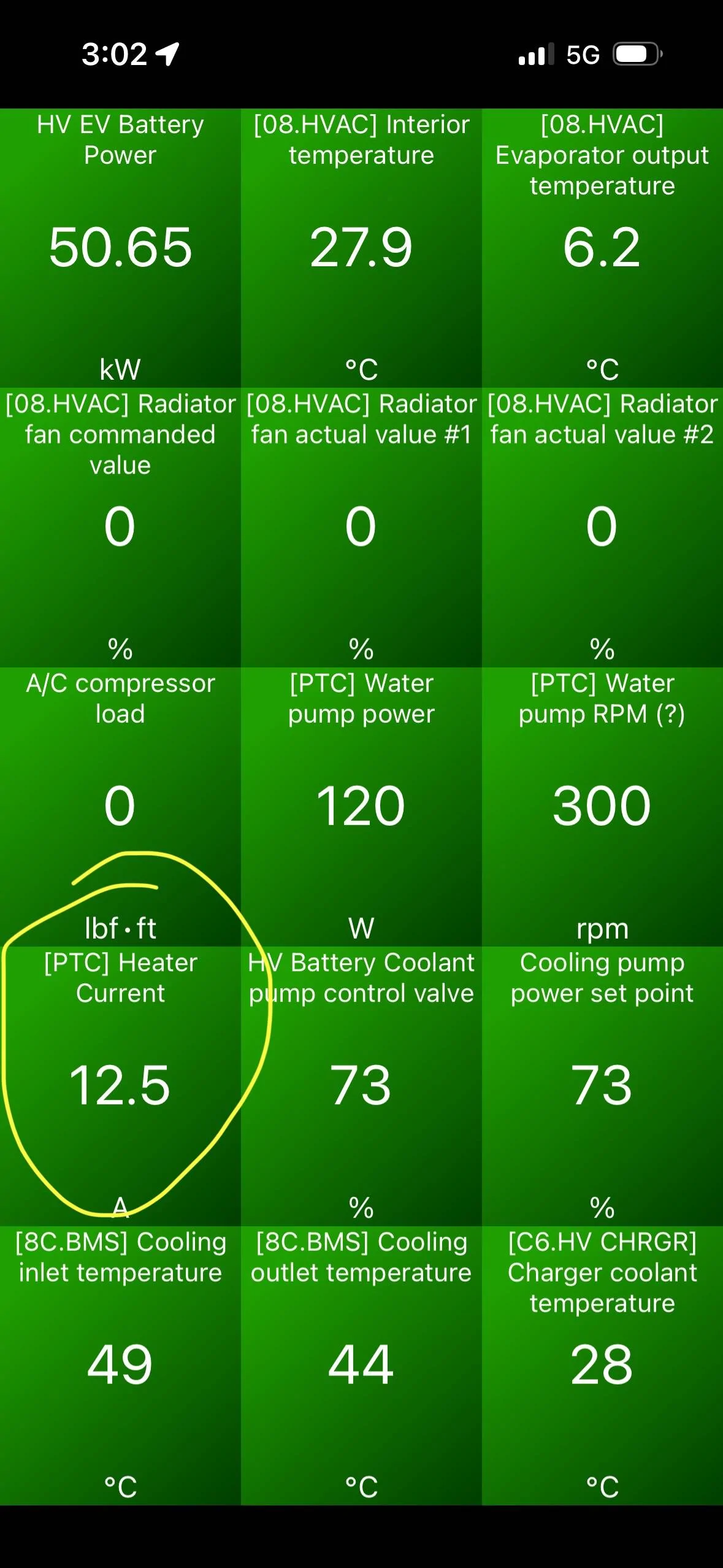

I’ve observed the heater turn on and off correlated with preconditioning the battery. With a cold battery/car, the heater current will ramp up after about 1-2min setting a DCFC as your destination and turn off as soon as you cancel the nav.
Porsche Taycan Does the Webasto heat the battery? IMG_0857
If the car is warm though, I have also observed the battery preconditioning happen without the heater current turning on so it must also be able to scavenge heat from other parts of the system.

Fairly sure the Taycan will do a similar range of things with its heating / cooling system.
Comparing the system in the self study guide to the Tesla system (see 3 part guide below), the eTron GT/Taycan system is fairly primitive. For one, Taycan would not need the webasto heater at all (note that Tesla system does not have a resistive heater, and with 16 heat sources it's fairly redundant - failure of one or even more does not leave your cabin without heat).
