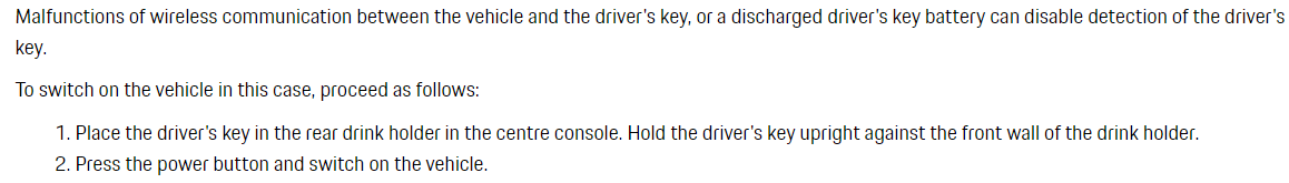

Hi all. I'm hoping someone can help me with a rather annoying message I get on the dash each time I get in the car. It comes up with Driver's key battery low - replace driver's key battery. I've replaced the battery in the key twice but the message still keeps appearing. I tried the spare key and that was fine. Does anyone know how I can clear this annoying message?

Try putting the key in the front cup holder. I think that can reset it. Also make sure the problem isn’t your spare key in the house but within range of the car

Thanks, will try this

Wow, thanks W1NGE - placing the key in the rear cupholder actually worked! Thanks again, your knowledge of Taycans is amazing!
