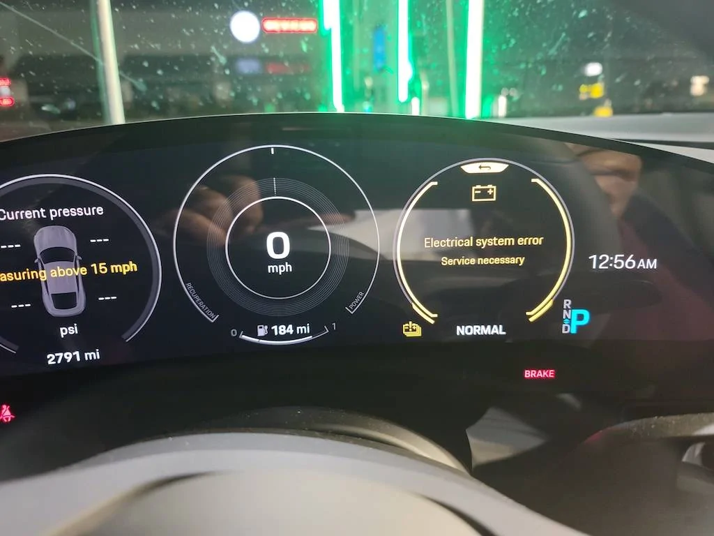

After replying on different threads about not having any problems with my car - Wham, I get hit with "Electrical System Error. Service necessary".
Story: I drove to my cousin's house in Mississippi one weekend. On the way back hame, I was charging at an EA station in Douglasville, GA when that error message popped up and the car shut down. I was calm at first. I totally shut the car down and restarted it. Message still there and it would only go into neutral. Now I'm starting to freak out. Freaking out because 1) I'm 142 miles from home; 2) it's 1 am and I'm in some strip mall parking lot with no security around; and 3) I'm by myself (although I did have a little friend with me). After restarting the car and no change, I called roadside assistance. They dispatched a tow truck but with COVID restrictions, I am not allowed to ride in the truck. Where am I supposed to go/do at 1 am and 140 miles from anyone I know? More freaking out!!!
I get a text from the tow company - ETA 120 - 240 minutes!! Panic turns to outrage at this point. Since there is nothing I can do and the car is dead, I decided to search the forum to see what others may have posted. Of course there were many threads. Temp fixes all pointed to shutting the car down, locking it, and letting it sit for 20 to 30 minutes. I waited about 45 minutes, restarted the car and fault was gone!!! I cancelled the tow and made my way home - driving conservatively!
Many thanks to this forum and the numerous posters out there!
Moral of the story: Keep posting no matter how big or small you think your problem is/was. You might help out a fellow motorist!!

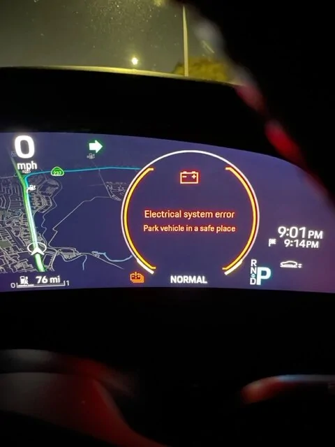

I got this dreaded red message tonight at 9pm. Almost 1 year into the ownership over 9k miles, first major issue. I got several errors starting with sensor, brake assist, camera not working and ended up with electrical system error. It was scary as I was driving at 70mph at the HOV lane for about 35 mins on 880S and suddenly no power. glad there was no behind/beside me and was able to cross over 4 lanes and pull to the side of highway. I called porsche assistance immediately and after spending 10 mins on call with them was assigned a service ticket.
I waiter over 50 mins and still no tow truck was assigned. In the mean time I shut the car off and restarted after 5 mins. I had to try several times before the error went away. I decide to drive as i was getting impatient and not fun waiting on the side of highway after a long day of business trip.I was 15 mins away from reaching my home.
Another frustrating part was with porsche assistance you get a paid lyft ride but they wont pick you up from highway and you are not allowed to travel in a tow truck. I dont know how people will get to their destination. I was wondering that myself while i was trying to restart my car. I have sent a email to my SA stating i will drop the car tomorrow and have a loaner ready for me.

Thanks for sharing!!
I'm glad you made it home!
I totally understand your frustration with the towing having been thru it myself.
Please let us know what the service tech says after the car has been checked out.
They didn't see anything on my diagnostics or codes when I took it in. I haven't had any other issues -at 11 months and 9982 miles in.

I took the car today. Similar to yours Tech didnt see anything "active" on my diagnostics. Tech did confirm he saw the error codes but cant do much which to me is mind boggling. I think they should know what each code means and what it translates too. Tech did want to keep the car and try to re create the failure mode but my SA said no. No active codes means nothing to service and wont get a loaner as well as he wants to focus on cars with active issues. The Tech did give me some confidence that the main battery looks good and he is thinking it could be a SW bug. Drove the car for about 50 miles at varying speed and so far everything seems to be working normal. My wife is not keen on taking taycan for road trip etc after this issue. Looks to me a failure to happen in future.
