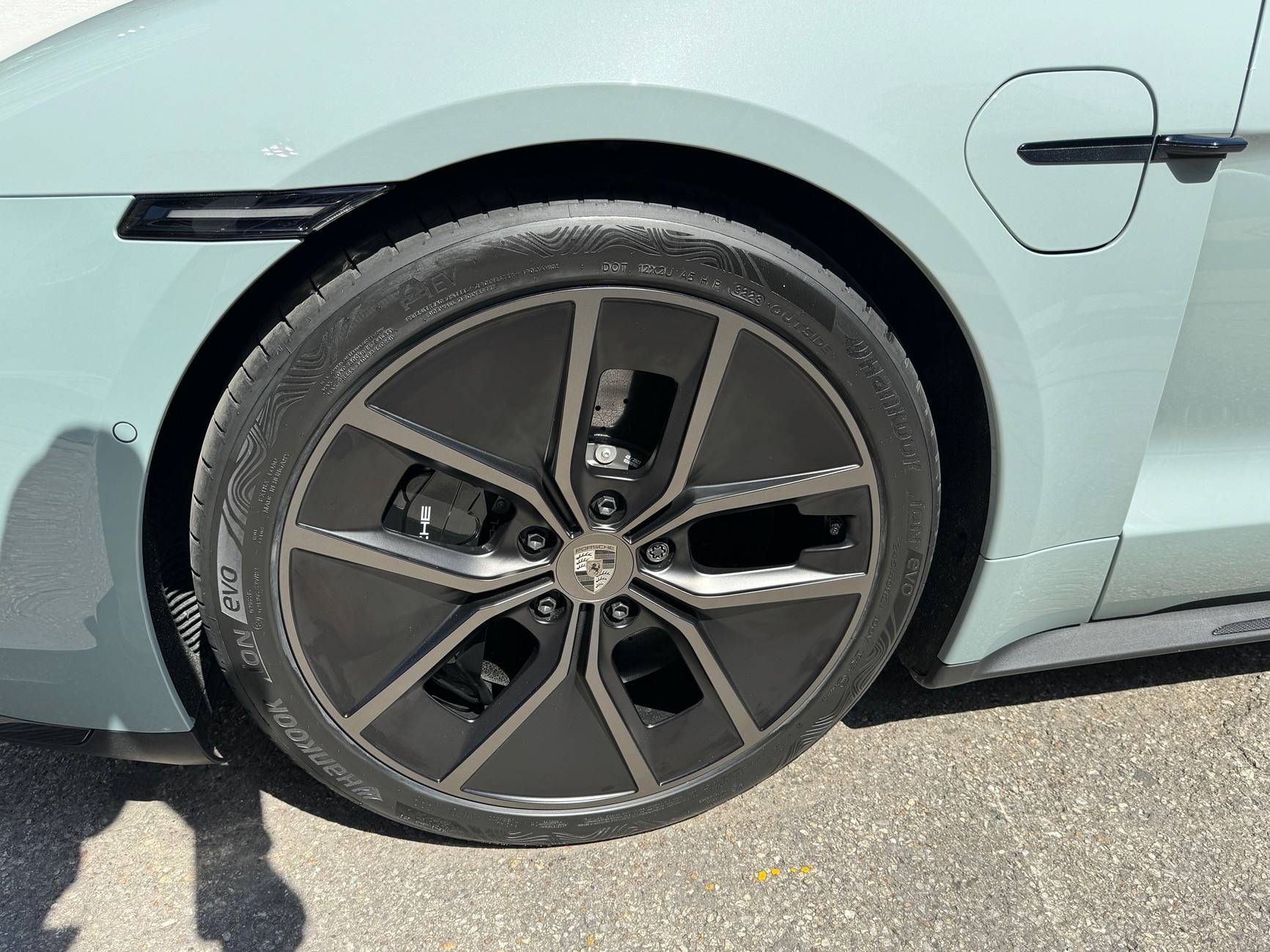

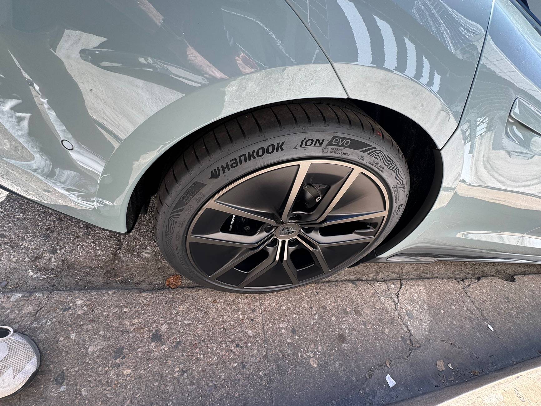

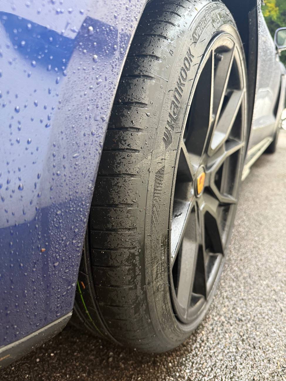

Would love to hear your experience with the Hankooks. It’s time to replace the 21” Pirelli’s on the Spyder wheels on our GTS. Looking for better wear, less road noise and higher efficiency. Thanks
So far I think things are very positive.
I’ve not yet had a run at speed, so not yet sure how they sound on the motorway, but so far I’ve found to be MUCH quieter, so much so that I’m hearing the wine of 1st gear a lot more when in sport mode when going slowly.
erformance seems good, grip reasonable enough - again, not really had time to going on a spirited run, but generally really pleased.
I don’t think the ride is quite a smooth as the Pirelli’s were - particularly in sport and sport plus.
The rears look a little ‘stretched’, almost like they should have a wider profile!

Thanks so much for the feedback. Really appreciate it. Have always felt that the 21” Pirelli’s on our GTS were noisy. Now that we have 12,000 miles on it and the tread depth is close to the wear bars, the road noise is more pronounced. Here are a couple of pictures of a MY2025 Taycan Turbo S with 21” Aero wheels which came fitted with Hankooks. I also noticed that the rears seemed “stretched”. If a 315 were available, it might be a better fit.
