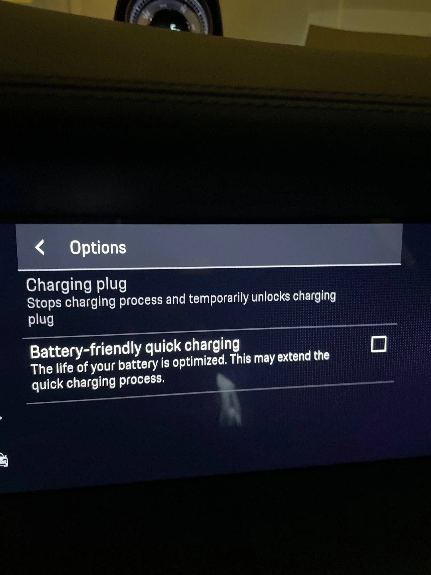

Do you see plug and charge option in your PCM? My 22 CT4 does not list the option for some odd reason. I plan to try and charge at EA station to see what happens
Charging, then hit the 3 dots in lower right corner. Should bring up the box to check/enable plug and charge.

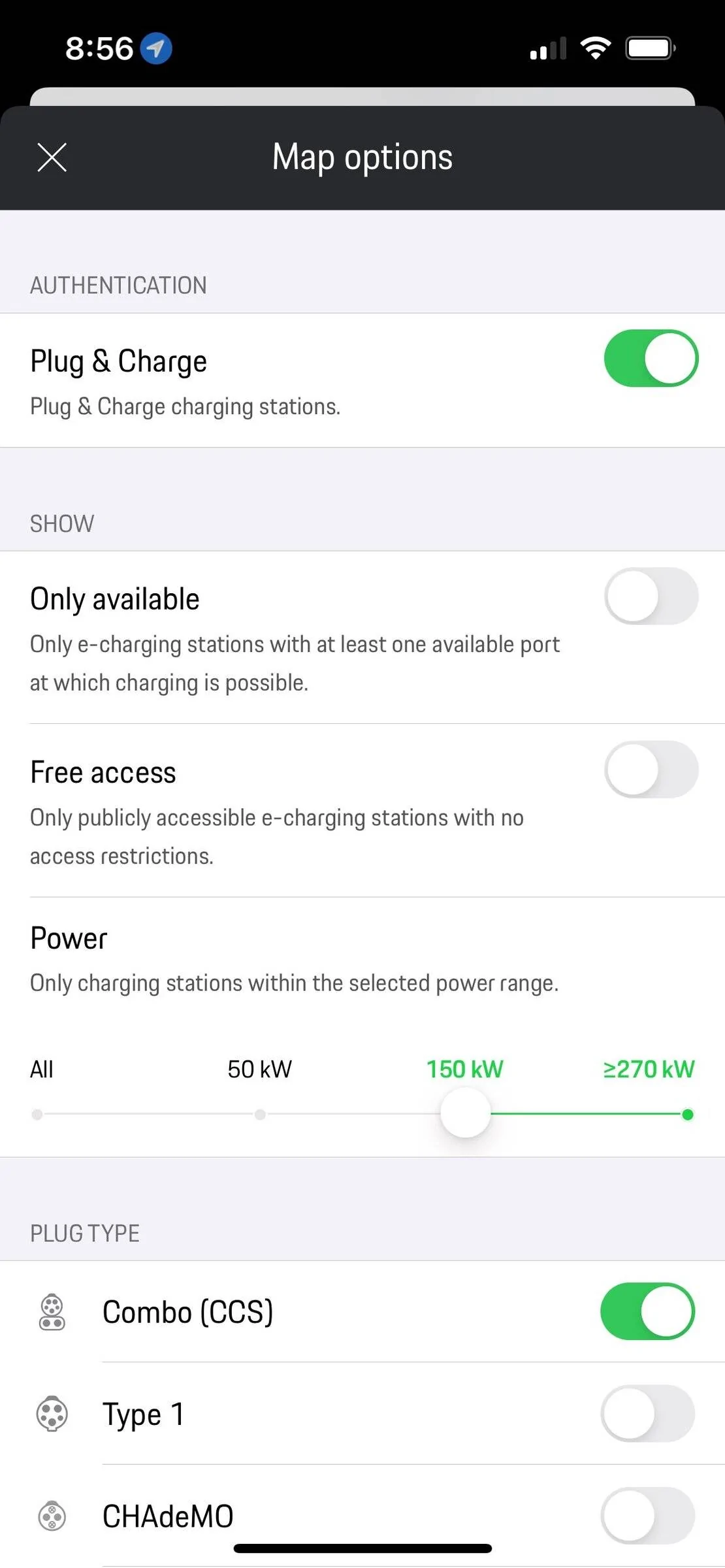

You also have to enable plug n' charge on the Charging app.

I did click the three dots and dont see that option.
Best to call or visit your dealer then & have them reset your info as that options screen s/b there in the Charging icon. As to the post from @chenner, check the Porsche Connect app and see if plug and charge is set there tho I am pretty sure it would need to be enabled in the car pcm as well.

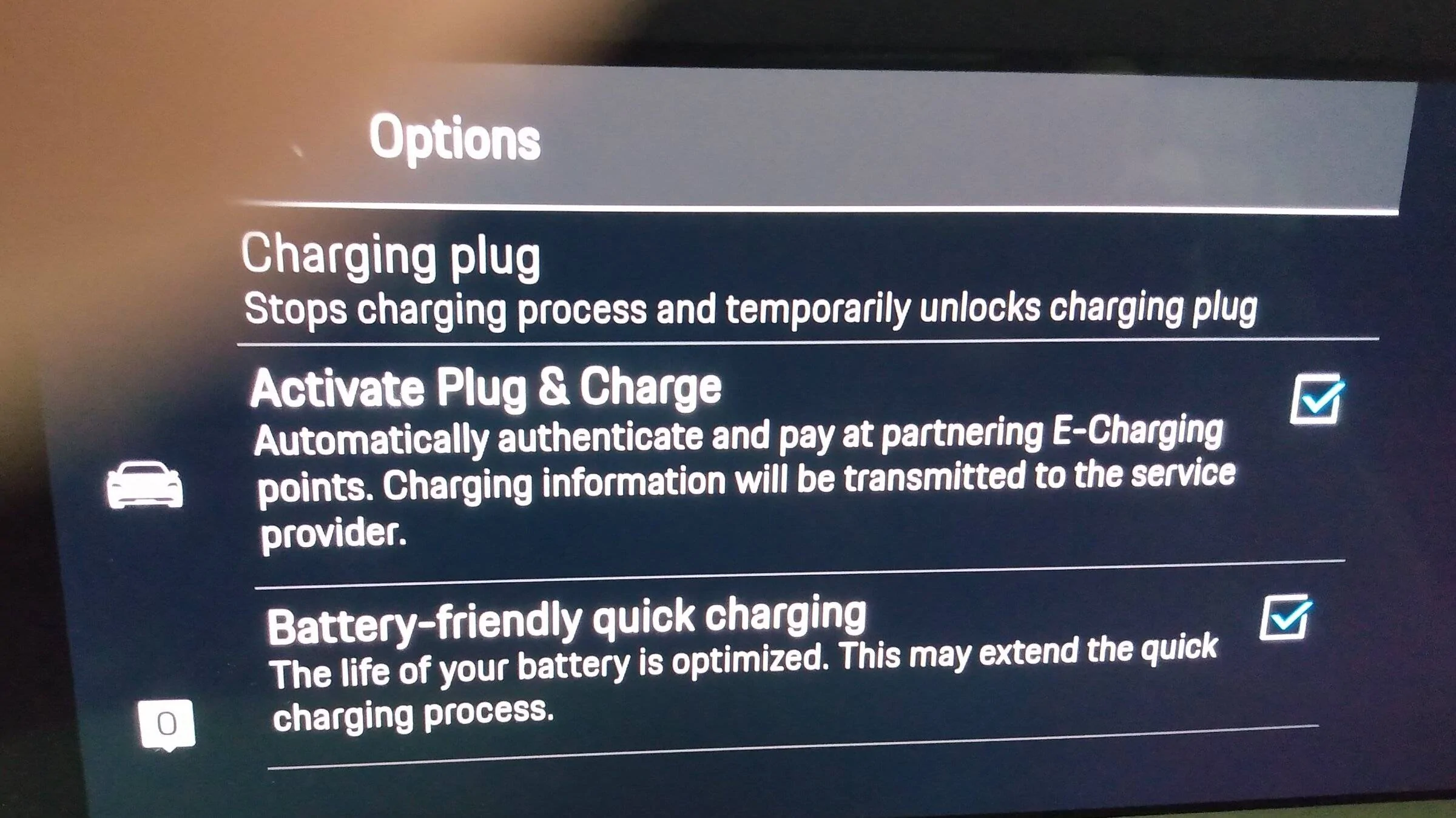

This is correct. There was also somewhere in the PCM where I had to enable "Plug n' Charge" to get it to work.
So one in the PCM and one in the Charging app (to ensure that the station allows for PnC).

Thanks all. I have enabled the plug and charge in the charging app. I dont see the option in PCM. I have pinged my SA again. I have also opened a case with Porsche customer service. appreciate the support here!

Wow, that is incredible! Have you tried a reboot of the pcm? You might also check the box for battery friendly quick charging and see if that brings up the other box for plug and charge.
