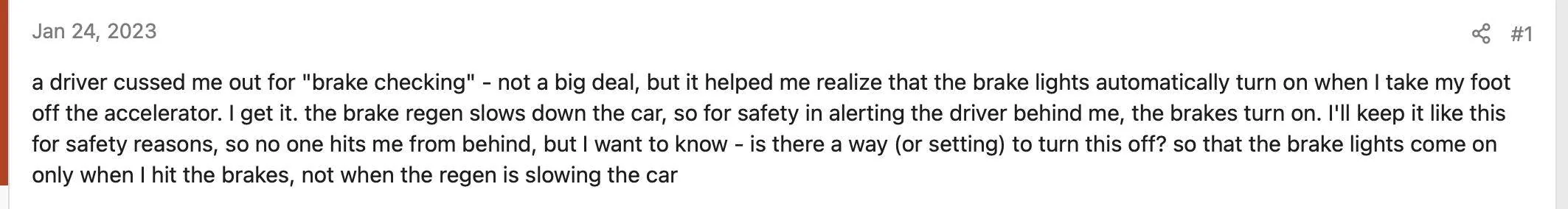

I'm in the same boat. I have a Model 3 LR rental right now while the Taycan is at the body shop. I've posted many times on this forum my disgust for Tesla's implementation of regen. I live in CA and Teslas are everywhere. One pedal for acceleration, another pedal for slowing down. PERIOD. Brake lights should only ever come on when the "slowing down" pedal is pressed. With a Tesla, theirs come on when a decel threshold is met. I don't know what it is exactly, but soooo many Tesla drivers brake check people without even knowing it because of the accel pedal let off for a split second. Funny, I just came across this trying to search for the decel threshold.
Porsche Taycan Great regen after brake flush 1701132720096
