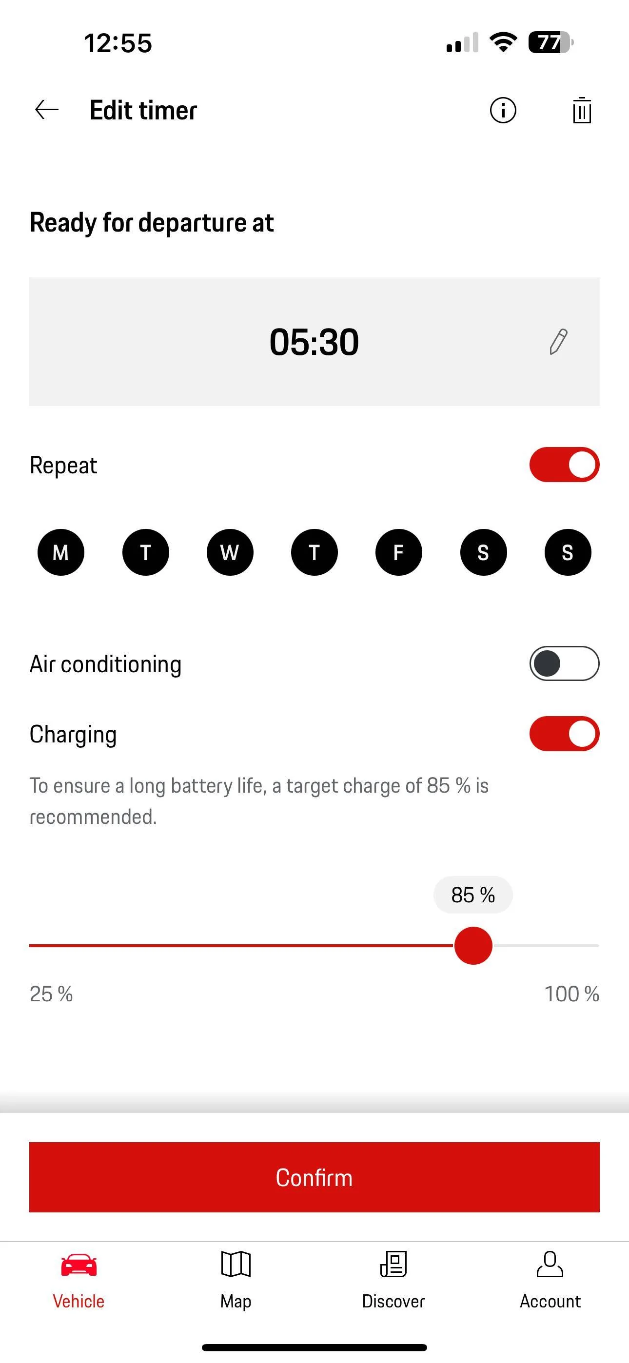

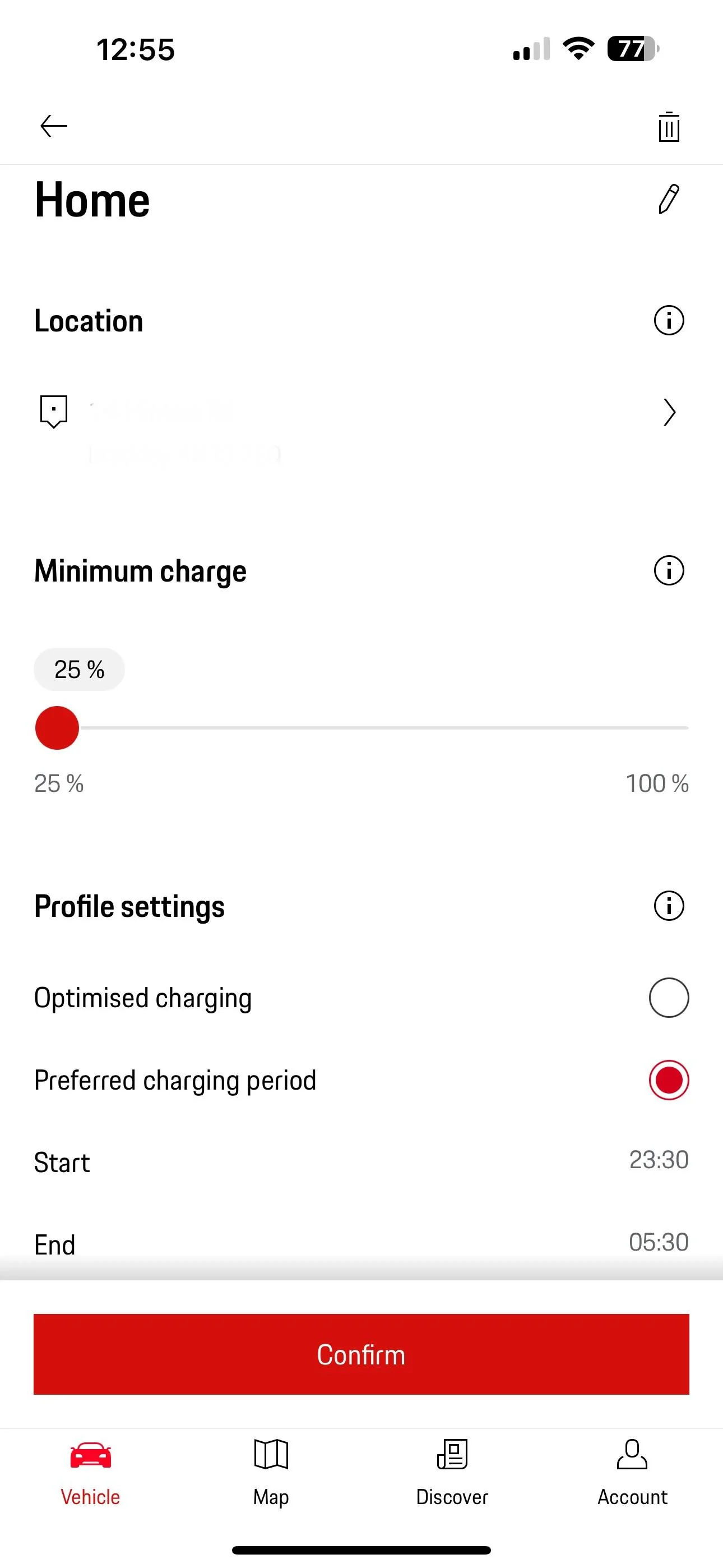

You need a profile AND a timer. These work for me to get to 85% each day with Octopus Smart Charging disabled …
Porsche Taycan Home Charging IMG_1107
Porsche Taycan Home Charging IMG_1108
Noelh
Noel
Dec 3, 2023
Sunderland
Taycan 4s
