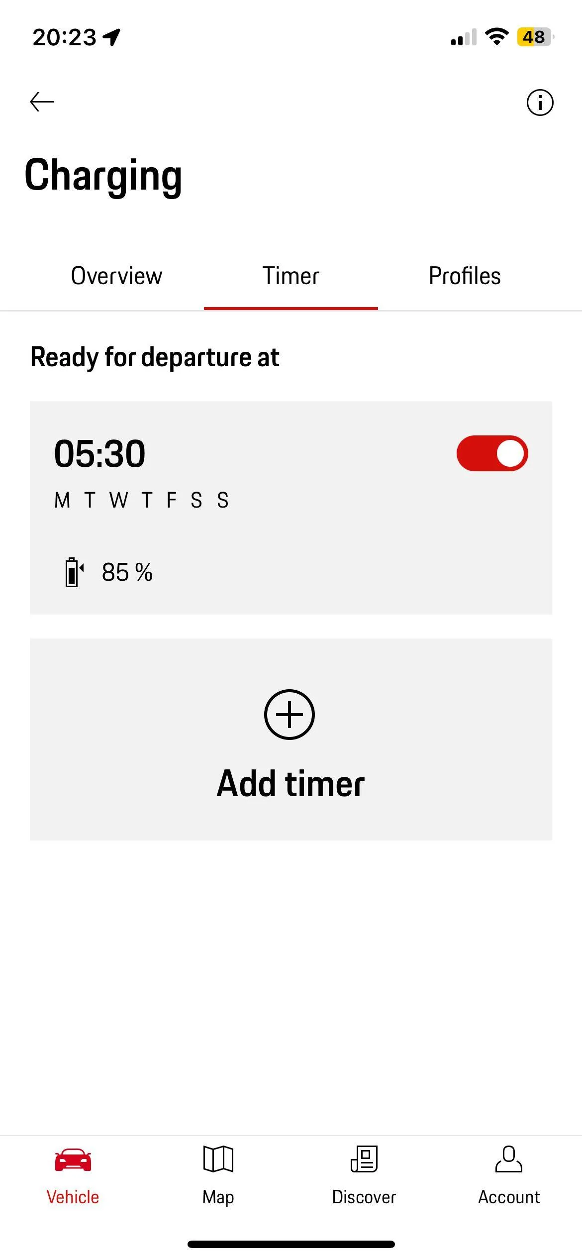

Is it not possible to have a profile active without a timer? Like this?

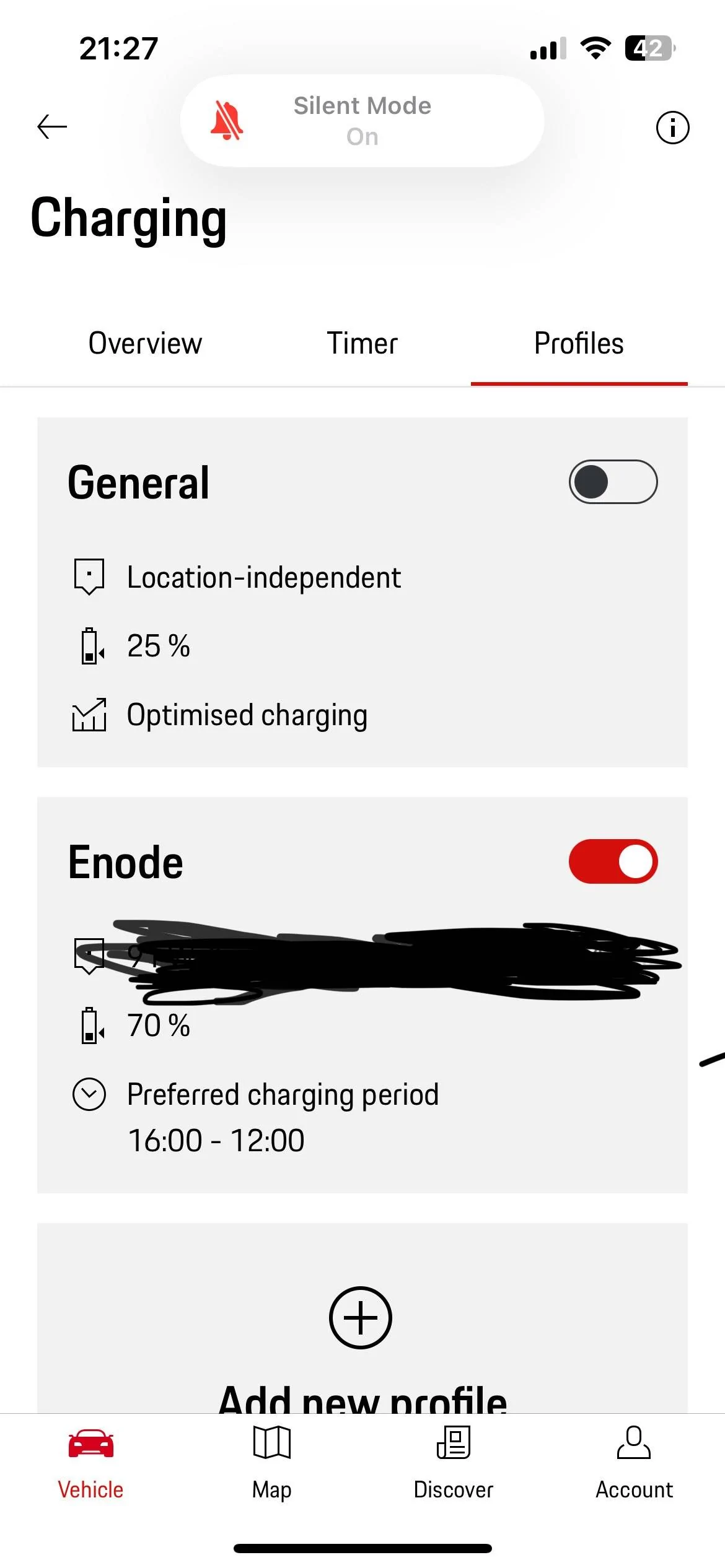

This is what mine looks like for ovo charge anytime. I believe octopus uses the same system, so should be similar.
enode being the profile generated by the electricity supplier. For what it's worth, my ovo app is set to 95% by 8am tomorrow. So the enode profile is pretty random, but i guess the app knows what it's doing. edit - It has also set up an timer for 100% on Friday.
No. Just having that profile alone will tell the car to charge immediately up to 25% as soon as you plug in. Once it reaches 25% state of charge it will sit and do nothing without a timer set.

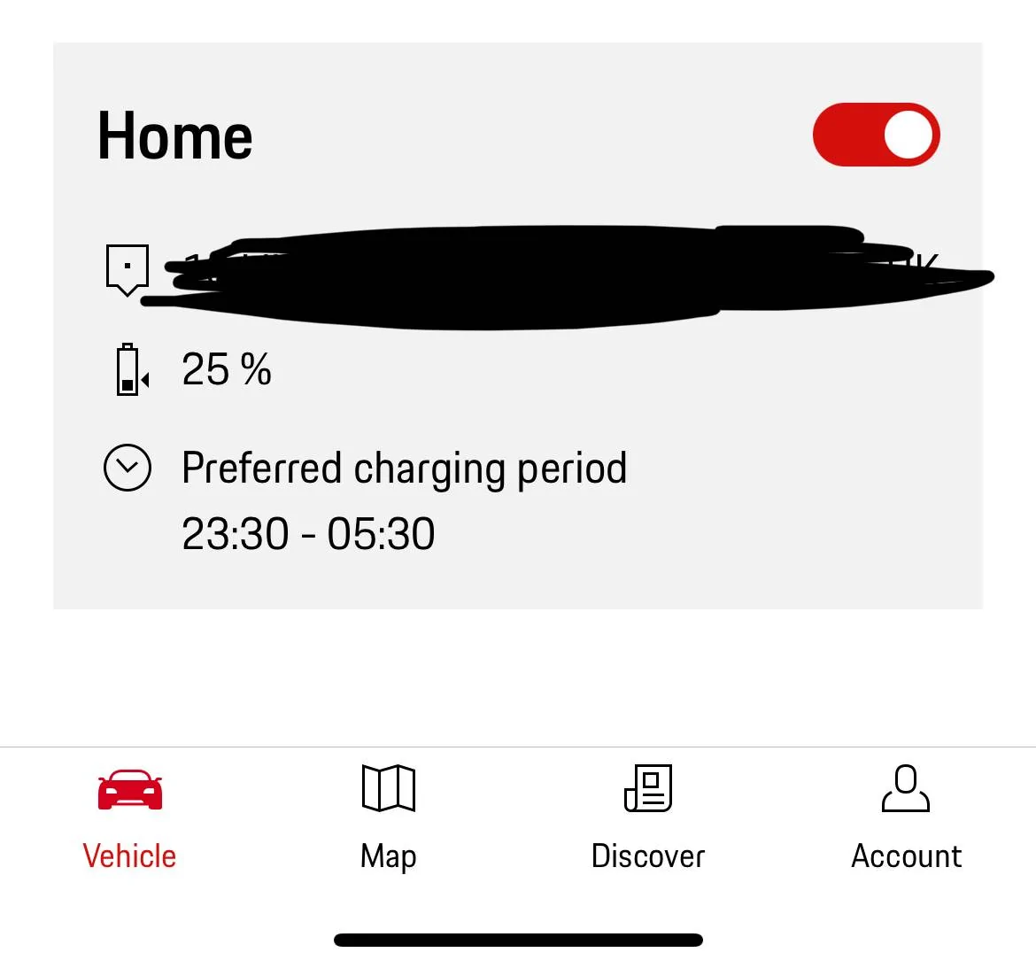

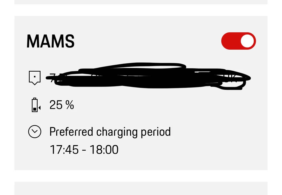

This is how I set the profile last night, woke up and still didn’t charge.

Double check your “Home” profile. Specifically that your car is actually within a 1640 foot radius of the defined location (tap the address field and see where it takes you on the map).
The location defined in my profile was off by quarter of a mile and that stopped my car charging. Also make sure the inbuilt “General” profile is disabled (slider to off position).
