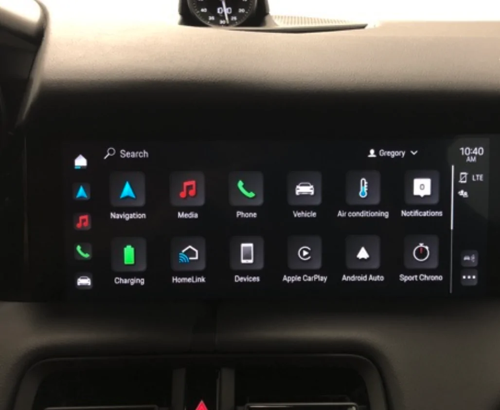

I have a 2022 and just got my update, all the icons on the display are now in color. Which is one way of telling. I have had an issue though and wonder if anyone else who has had the update lost all their safety systems. My car is back in the shop, to resolve this issue.

Great point on the color icons. thank you! Has the update fixed the alarm going off for no reason?

Colored icons may not ensure the car has all of the required software updates. You should have a dealer check the car and compare to what campaigns its VIN should have.

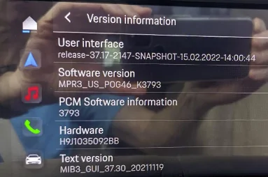

If the Taycan has color icons and software version is approximately 3790, it's uPdated.
My 2022 RWD was built in April and came with colored icons. The software version before I got the uPdate was number 3776.
My uPdate was completed yesterday (dropped off Monday morning and picked up Wednesday afternoon), and now I have software version number 3793.
Tap the
Settings icon (with the gear) on the PCM screen.
Then tap
System.
Then tap
Software information.
Then tap
Version information.
