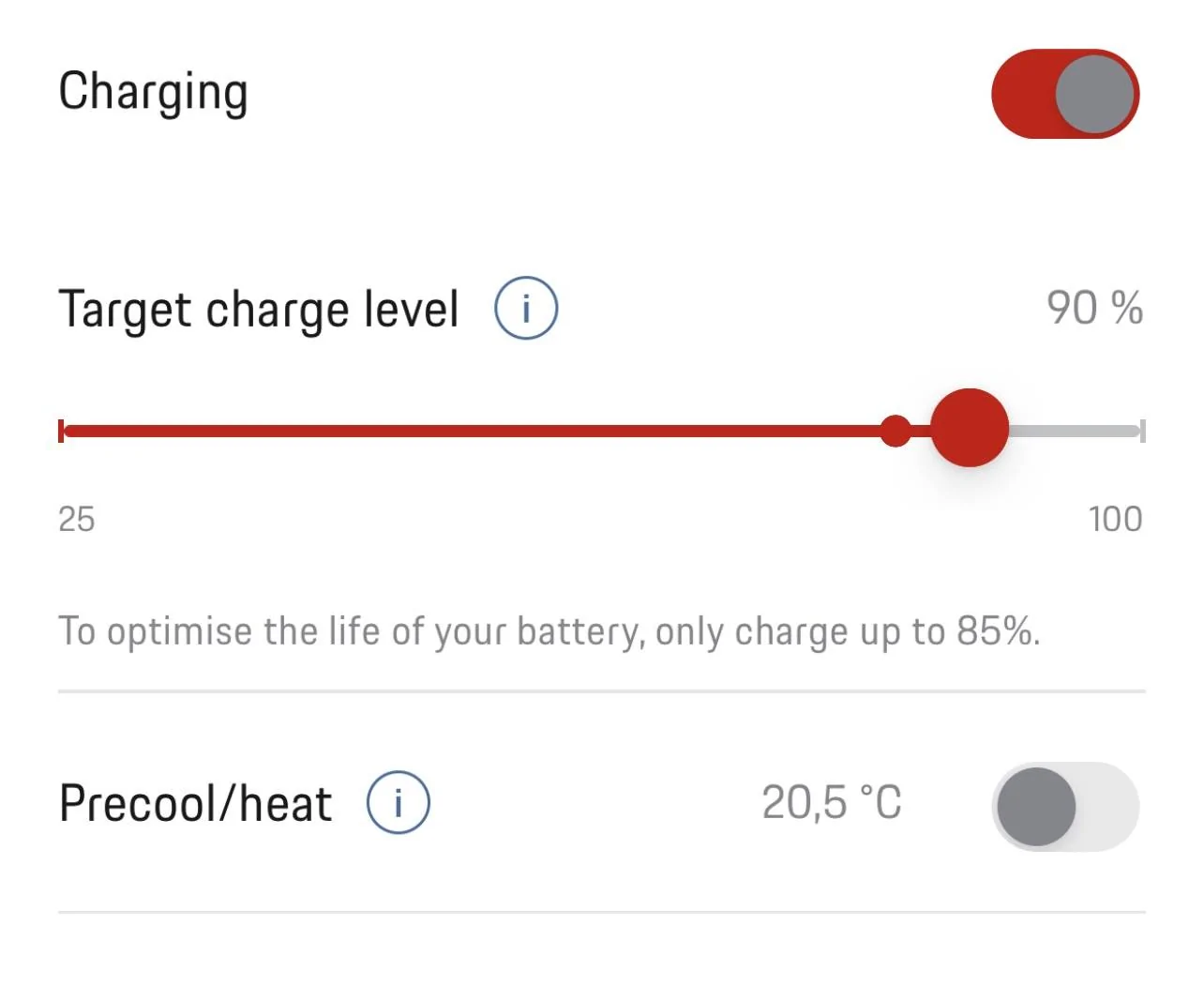

85%, daily. 85% is recommended by the app. My2021 (recommendation appears when you slide over 85, see below).
80% is what is called for in the manual
