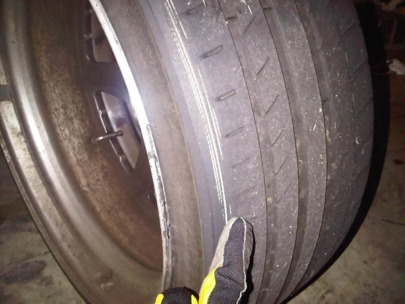

With camber you have half the tyre worn out, but these just have a tiny strip, which if you have experience with alignment it's toe that does that.
IDK why everyone assumes it's camber, when the wear pattern is text book toe.
Camber tends to look something like this (too much positive camber in the photo):

Yeah, here's a textbook example of toe wear:
Porsche Taycan Inside of front tyres bald - rest of tyre fine 1770051658898-82
That's what all our cars are doing...
IDK Why people keep saying it's camber. Just set your toe a little less than spec, and most likely it won't eat tyres anymore.
P.S.
At the expense of handling of course. Having toe adjusted out is what gives the car the lively feeling of reacting to direction change really well. Setting it more neutral will reduce that a little.
