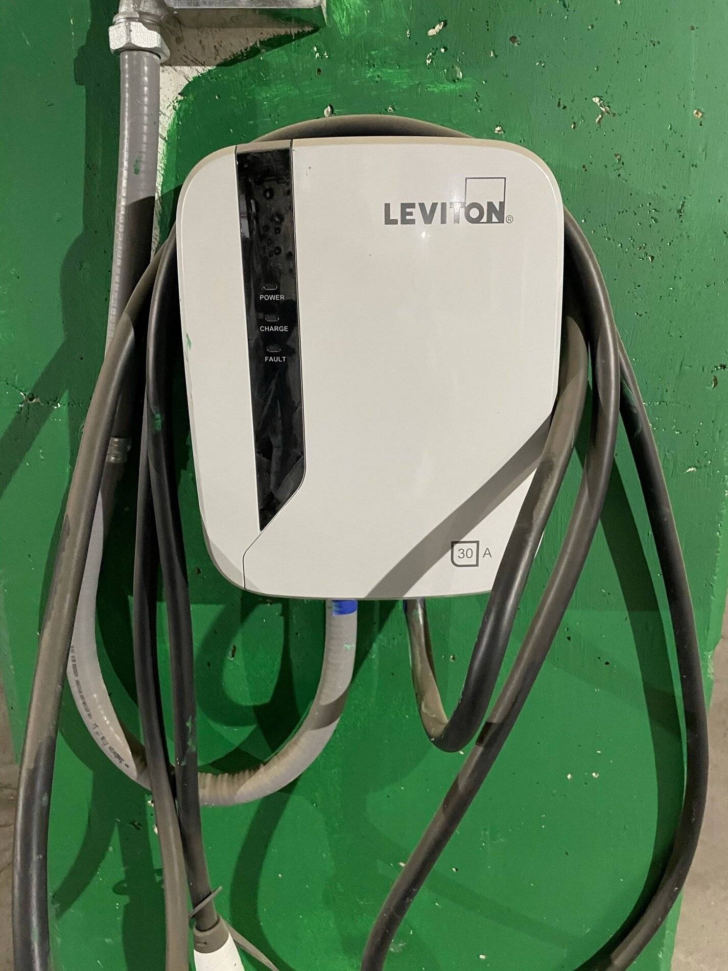

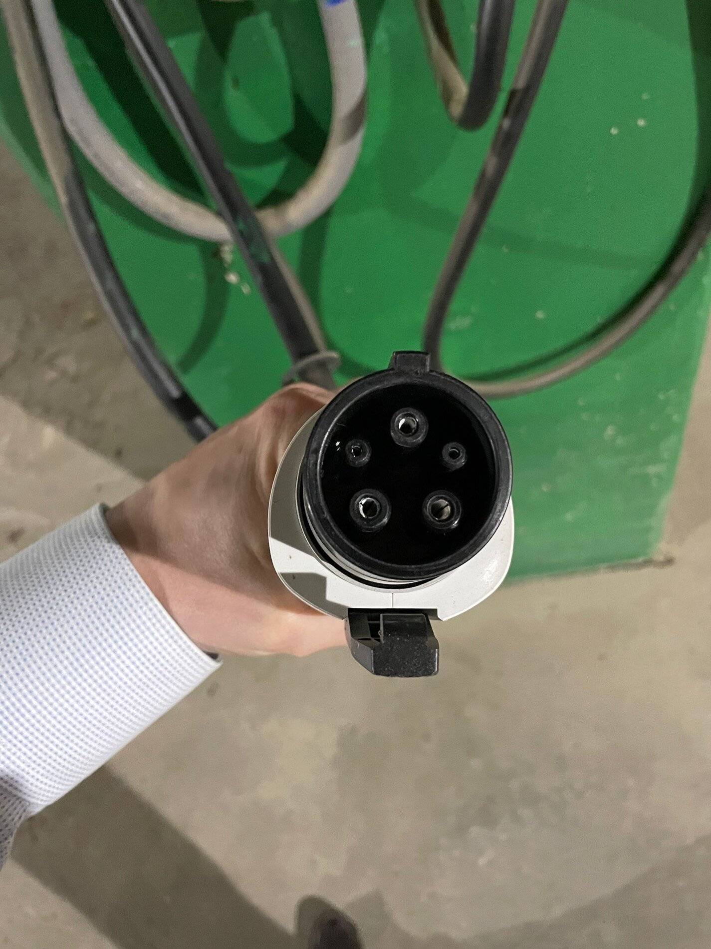

Attached are some photos. Let me know if I will need any adaptor. Are these considered 'ok' chargers? Can I use their plug? Also, the plug image is the plug I have at work, does that work?

it’s standard it will work fine

based on pics no adapter required

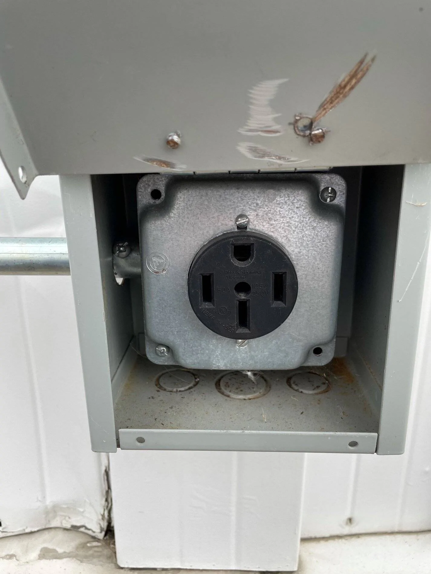

if this plug is available to you from your pictures
Porsche Taycan Leviton Charger - 30A BF2AD1D8-2BD0-4503-80E8-2CD8BB298505
this could be good for you
that is a NEMA 14-50 plug - which if wired correctly means is on a 50 amp breaker which can offer a 40 amp charge rate or 9.6 kw - that plug should charge your taycan much faster than the 30 amp levition chargers - but you will need the porsche PMCC or some other J-1772 40 amp EV charger - verify with building management it’s a 50 amp breaker and you are good to go with any 40/50 amp J-1772 EV charger (EVSE) - porsche or otherwise
