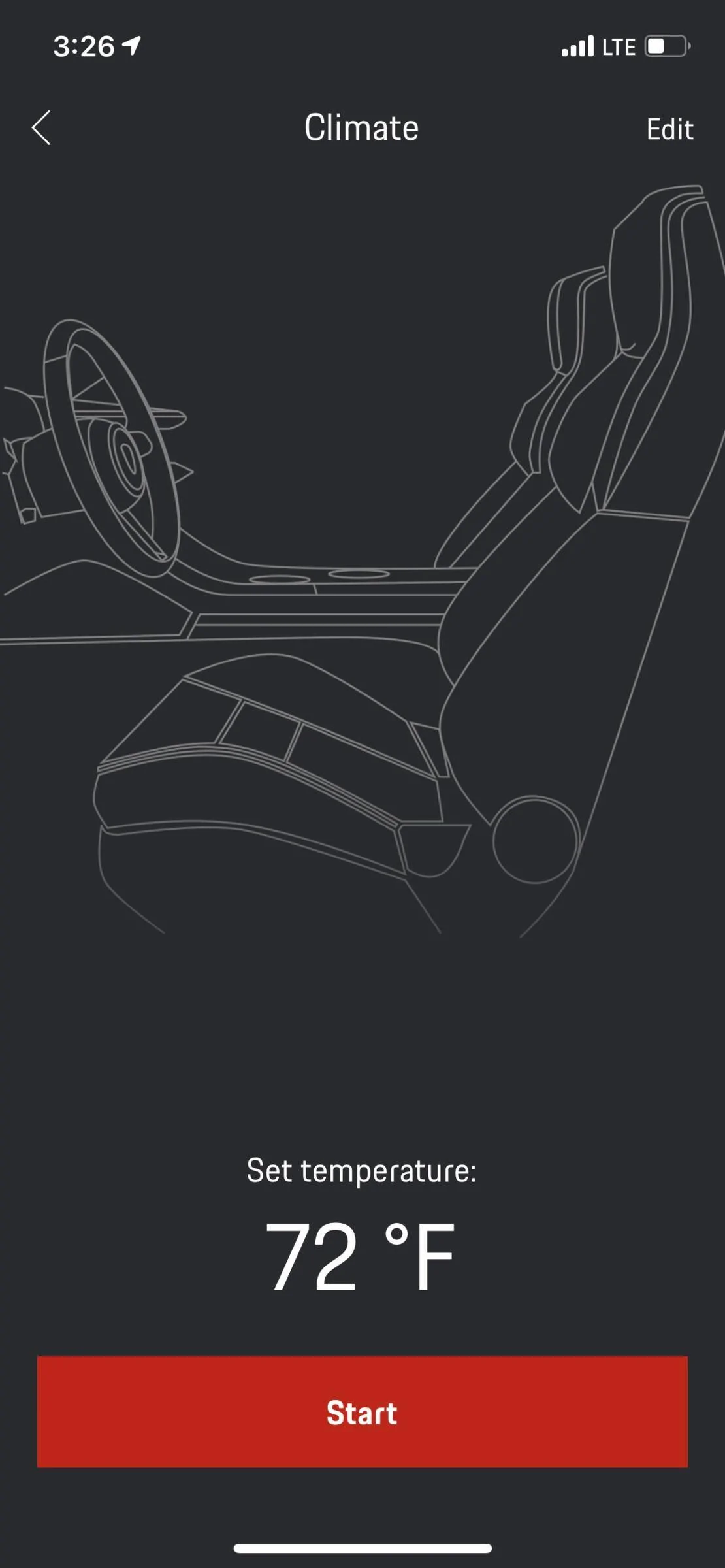

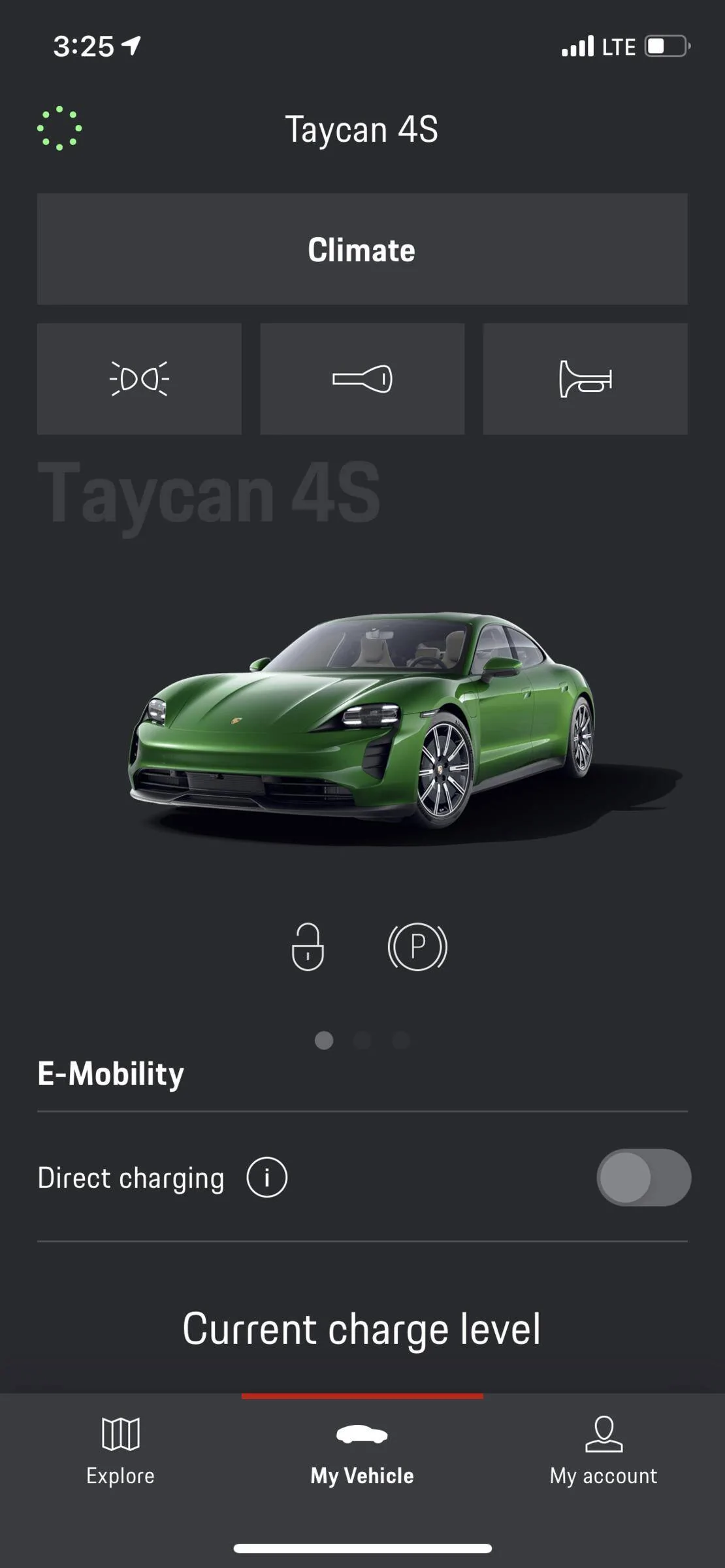

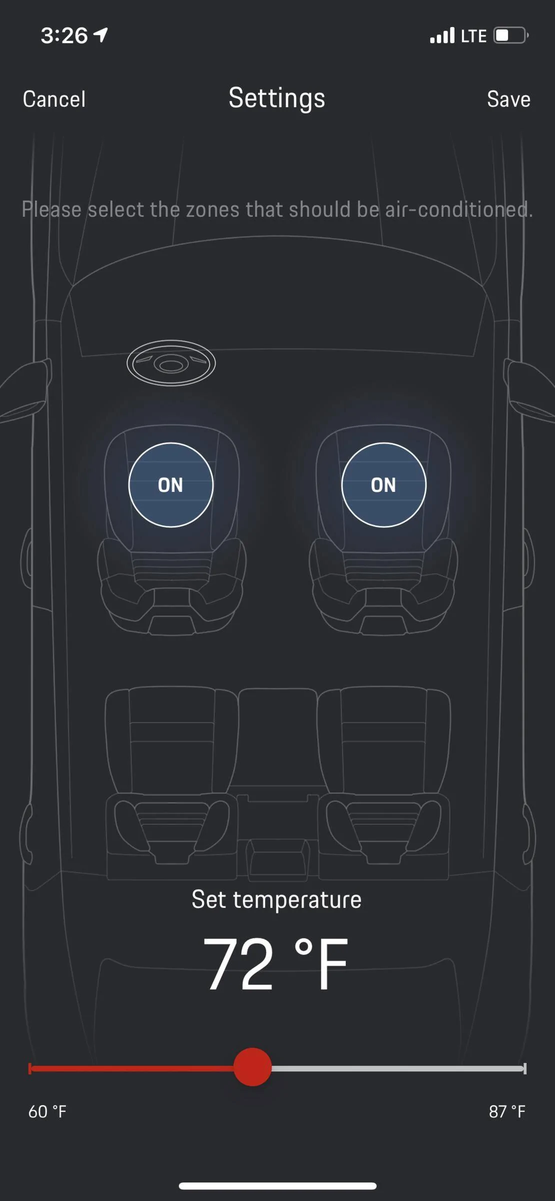

Does the Porsche phone app allow you to pre-heat the car remotely? That has been be the most used feature on all our Teslas.
Yes, you can select “climate” from the top of the app and then hit “start”. You can also adjust settings. See below.
Is that what you’re looking for?

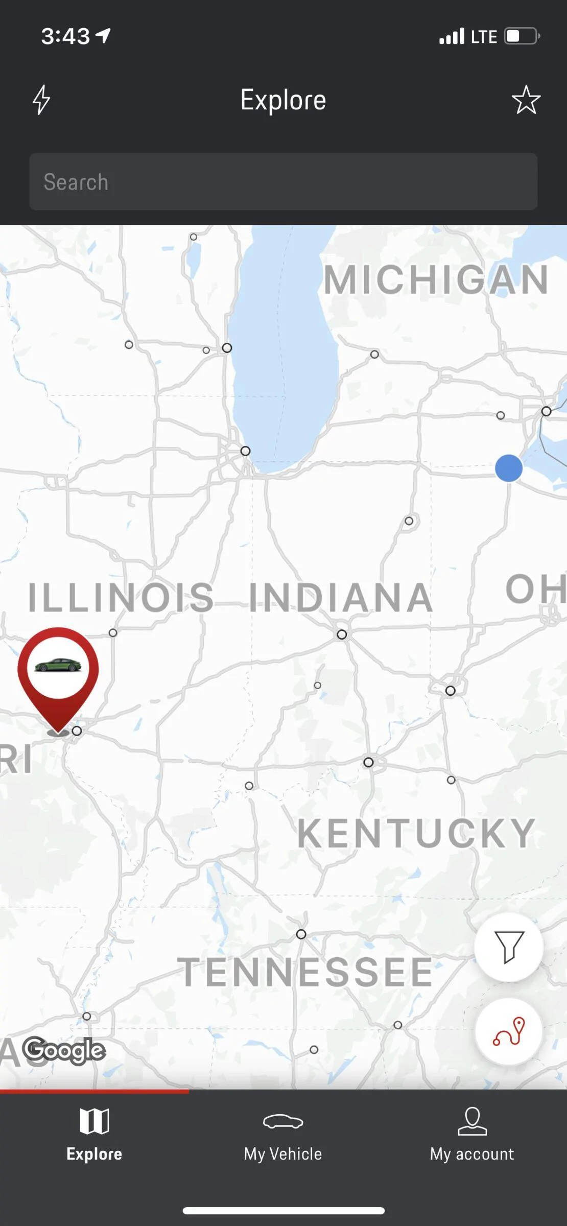

Yes, thanks. I suspect this will be the most used phone app feature for Porsche too, definitely so if my wife ever gets one.
Out of curiosity, does the app show you the car's and your location on the same map, so you can use it to find your car if you forgot where you parked it?
I’ve never looked. It appears so below. I usually use the “last place parked” on my iPhone maps for that though.
Looks like I have quite a hike back to the car! ? (I’m out of town).
It does, the location of the car refreshes quite quick too. Source: I used it to chase down my car in a cab when it was being towed ?
Yes it does but it can be incorrect (depends on the reliability of the connection and frequency of updates to the central servers). In my case there has often been quite a lag - sometimes measured in days and in '00s of miles (honest). The same implementation on my Panamera (old tech now) was always 100% accurate (and reliable) not sure why the Taycan implementation has been such a lottery.
In principle if offers these things but the achilles heel appears to be the connectivity from the car to Porsche servers to your phone and generally the weakest link is the one to the car unfortunately.
