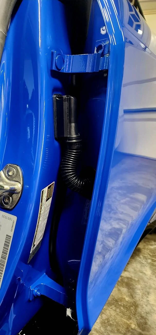

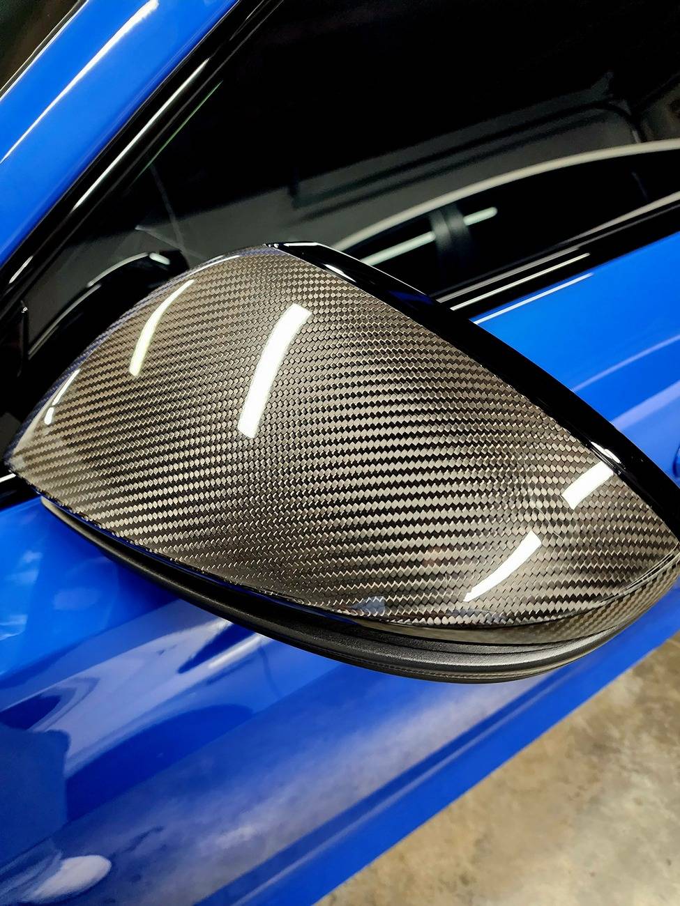

All of my towls are hydroponic after 1.5 years because I use so many different sealants and waxes.
I'll do another post about how I wash my car which takes between 7-8 hours for a regular maintenance wash. My car is not dirty, its just not perfect.
I learned many techniques from my friend that is the only person on earth to get perfect scores at PCA concours events. PCA is the most anal in judging for dirt.
Here are the different towels I use:
Exterior:
Wheel
Dressing
Window
Paint dirt removal (low pile)
Paint sealant application and removal (high pile)
Door jams
Interior:
Leather
All other interior surfaces
No matter what they will become hydrophobic, but this prolongs the longevity. Keeping them submerged in water/Vinegar immediately after using ASAP is the greatest tool though
