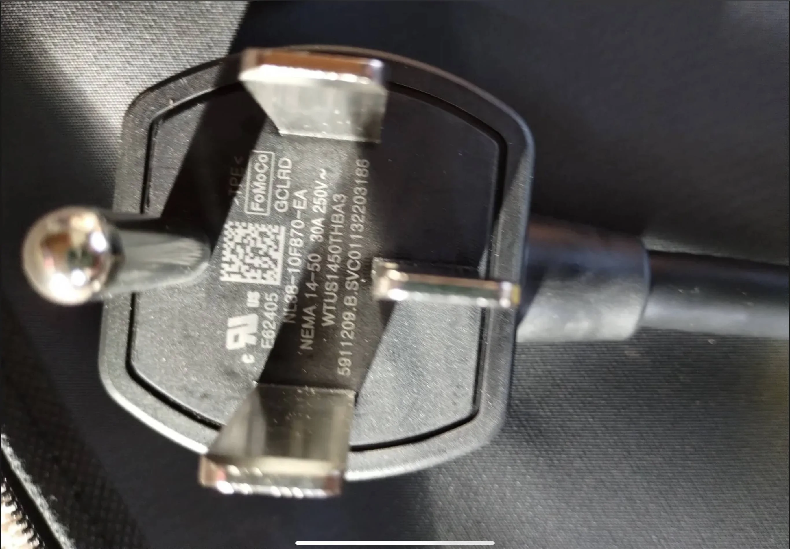

I did not want to use the Porsche charger that came with the car after reading the forums. I also didn't want to buy a charger off Amazon, so decided to buy a new OEM charger from ebay. I ended up buying a Lucid charger which has worked great but also considered the Rivian, Chevy, and Polestar OEM chargers. All these models have a removable pigtail that allows you to change out the plug for different outlet types. If you're patient, you typically can find these in new condition around the $250 - $300 range currently.

Probably same charger as the Ford I have. The plug on your eBay one even says FoMoCo.
It looks like they messed up and got some Ford charger pics mixed in. I'm not sure what this seller does but they have a bunch of Ford, Rivian, and Lucid chargers. It was a toss-up but one reason why I chose the Lucid was because it was a 40A charger. Most of the others are 30A. You can see in the pics that they have a few shots of the pigtail receptacle and there are two obvious different types.
