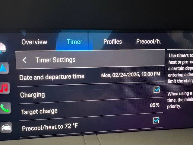

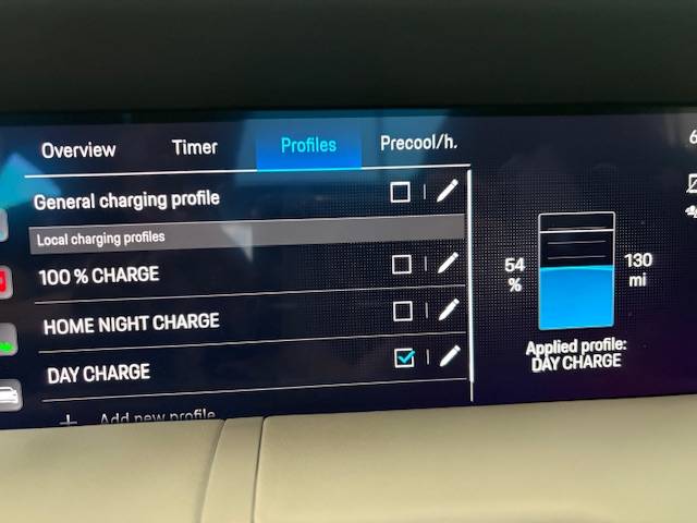

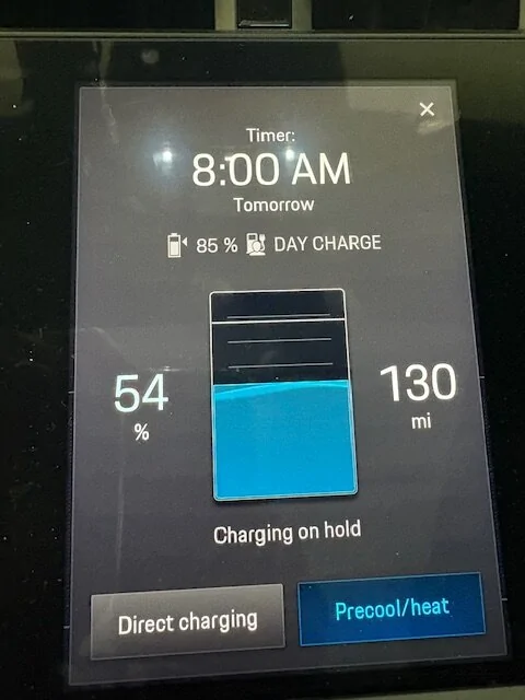

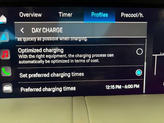

@SergeyIndy I understand what you're saying but the "night profile" always worked flawlessley. I have the Tesla Universal Charger. Attached some photos from the Charging app on the car. I assume the Timer isnt taking priority but shared the pic anyway. Any help would be appreciated!

If there is a timer, It doesn’t just start charging at the beginning of the preferred time. It starts charging to be done at the end time.
You only need 30%. It doesn’t need 6 hours to do that on 9.6kW power (assuming that’s what you’re using). So, my guess is that it will start later.

@4thPcar, I see what's happening.
You current SoC is 54%. Profile DAY CHARGE assume is set to 85% with preferred timeframe.
Therefore, you cannot expect the car to start charging at EXACTLY 12:15pm, because there is MORE time in the preferred window than needed to get you from 54% to 85%, so the car is Paused since the car calculates the time needed from the target 6pm backwards. Therefore, for example, if it needs 3 hours to charge to 85%, it will start charging at 3pm and will get you to 85% by 6pm.
Bottom line, the car is working as expected.

Okay it started at 3pm! Thanks all, it is indeed "working as intended." Theory confirmed.
