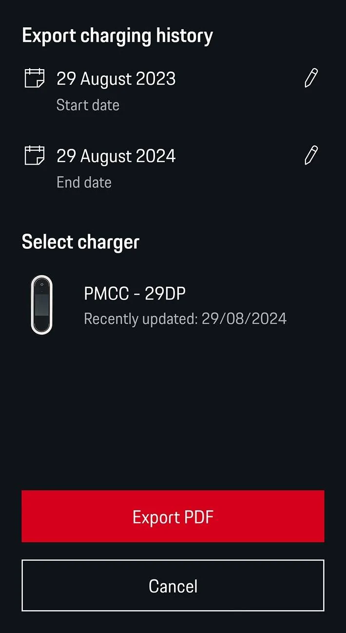

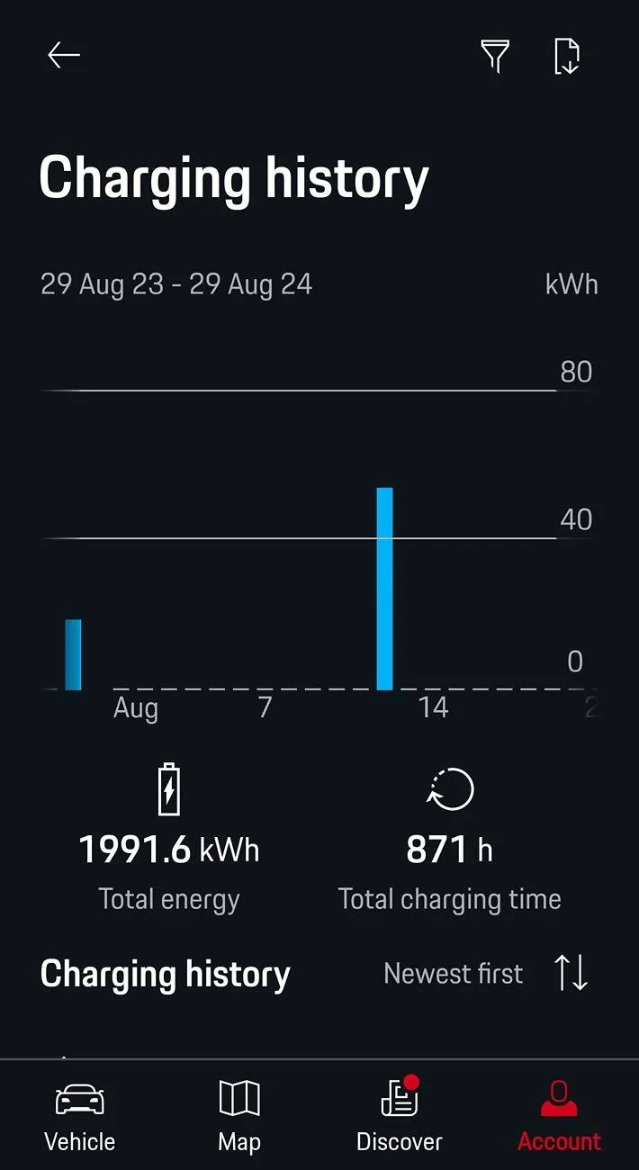

Actually it may also enhance My Porsche app as I can now export all charging history since 2020 to PDF whereas I couldn't export anything recently
Porsche Taycan New PMCC Software Release - 3030 Screenshot_20240829-182855_My Porsch
Porsche Taycan New PMCC Software Release - 3030 Screenshot_20240829-182847_My Porsch
Yeah its quite nifty and reports per vehicle so I can see the data for my first Taycan and now second.
