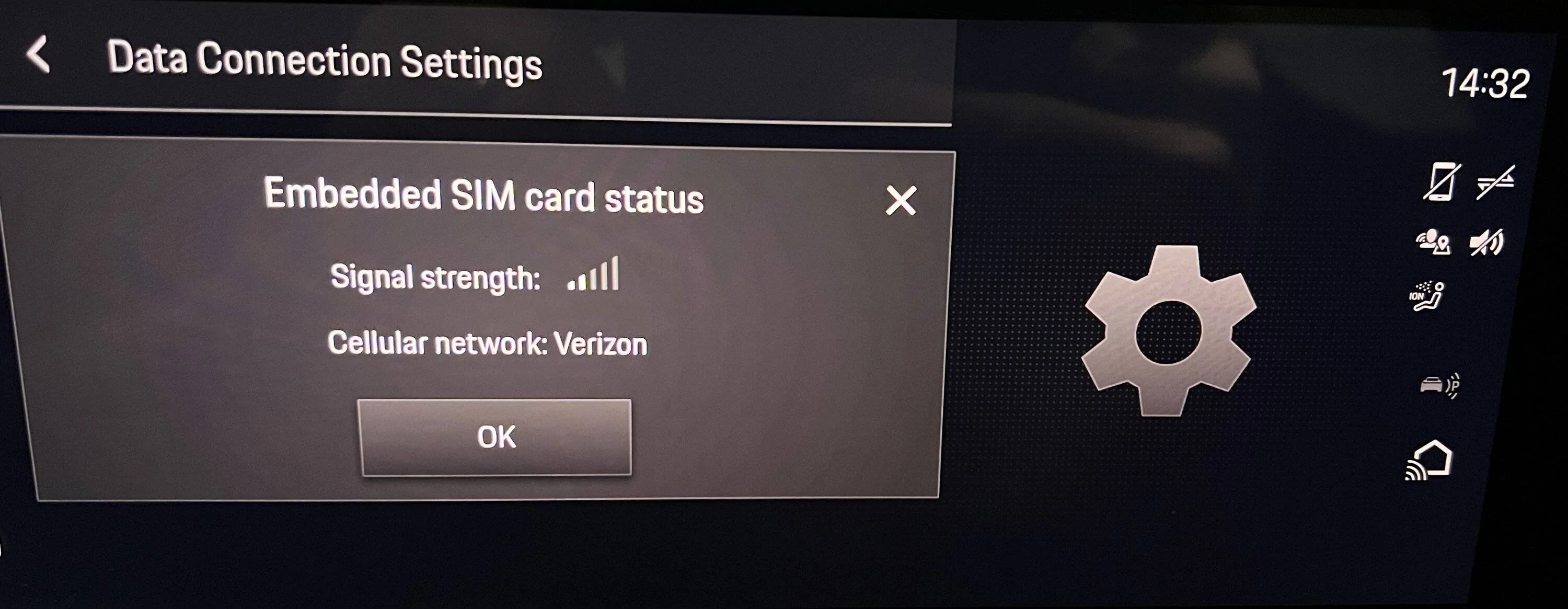

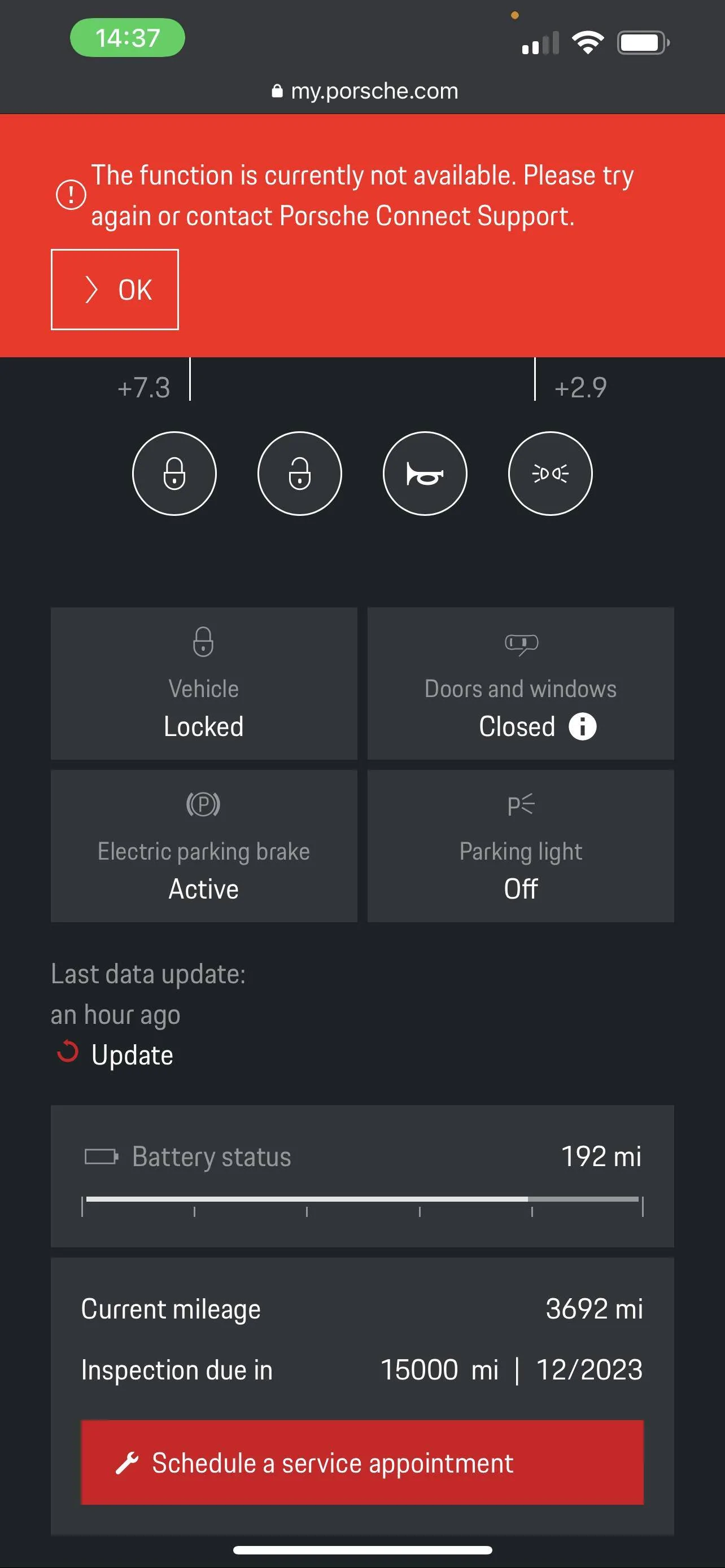

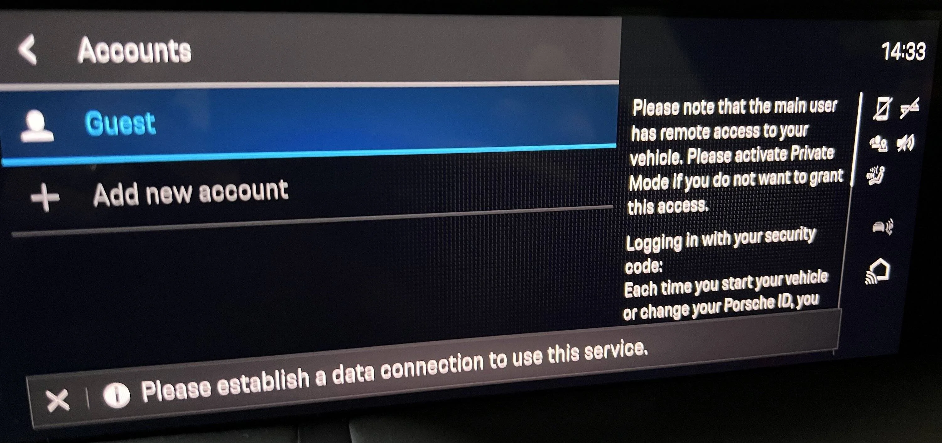

It seems since the last MyPorsche app update (where they added the tire pressure display) my car has lost its data connection. It won't even let me know when its charged - I used to get a notification about that every time in the evening. No remote feature works at all (lock/unlock/condition, etc).
Things i've tried
- rebooted PCM
- waited for car to turn off and on again
- tried to catch it in service while driving around (no luck)
- Sim status shows connected to Verizon with 2-4 bars in random locations
- logged out of system - that was a mistake as I can't log in now
- tried a full reset. The system can't complete that, I assume since it needs data connection to unregister
- enabled/disabled privacy mode to no effect
- SOS light is solid green
- The app shows " updated 1hr ago", but the data it shows is actually from 2 weeks ago
I opened a case with the Porsche connected services. The rep was very helpful and didn't bullshit me around. He said he could try to remove my car from the account but I didn't want to since he shared that he's been getting a lot of calls these past 2 weeks. It seems definitely some issue with their systems. The case is now in Germany and I'm waiting to hear back.
At this point this is just majorly annoying but the car is driving fine.
Has anyone else experienced similar issues? Any suggestions on what else I can try? I'm hesitant to bring to dealer since I don't want to be without my car for a month

1. Could be the LTE module has a fault. Dependent on this for car connectivity.
2. Have you tried using your secondary Porsche ID and key fob - this will force a new login?
3. Can't imagine the updates to the app would lead to a total loss of connectivity. Screenshots shared look to be from My Porsche web site and not the app but should work nonetheless.
4. Disconnecting 12v battery to properly hard reboot everything might be a solution. Guidance in Porsche Good To Know App.
5. May be a software / account screw up due to the recent server migrations.
6. Delete all accounts from PCM and factory reset. Some settings will be lost but easy to reestablish after logging in with your Porsche ID (if you can).
I had this / similar issue last year and by trying some of the above the issue cleared. Pulling the 12v (for less than 5 mins) or PCM fuse may be the quickest thing to do but no guarantee it will resolve your issue.

🤦‍♂️The battery - thats what I forgot! I disconnected it for 5min and the car showed LTE right after.
Thanks for the ideas! I appreciate you taking the time to help! I tried some of those already to no avail, but the battery disconnect was the fix.
