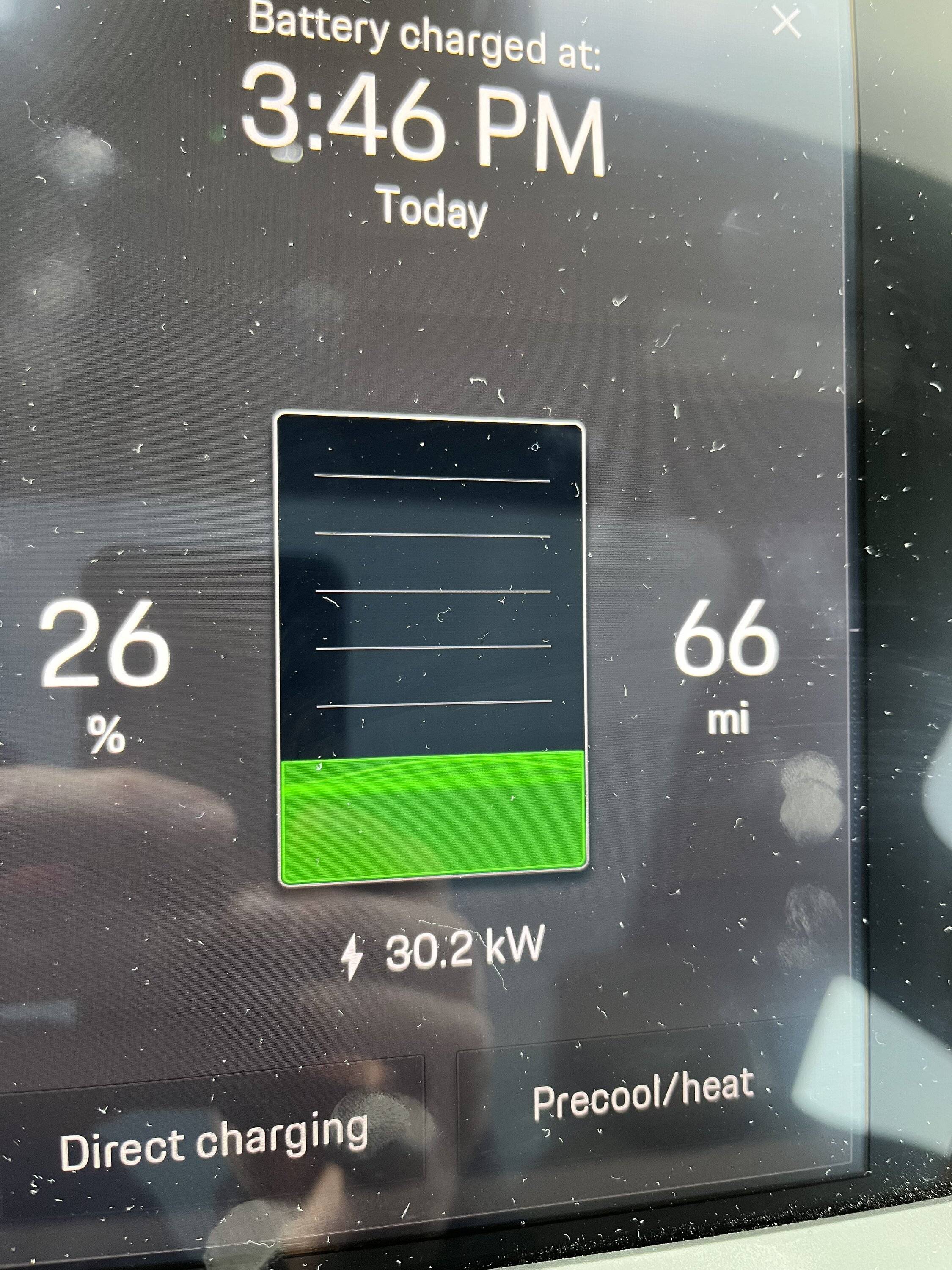

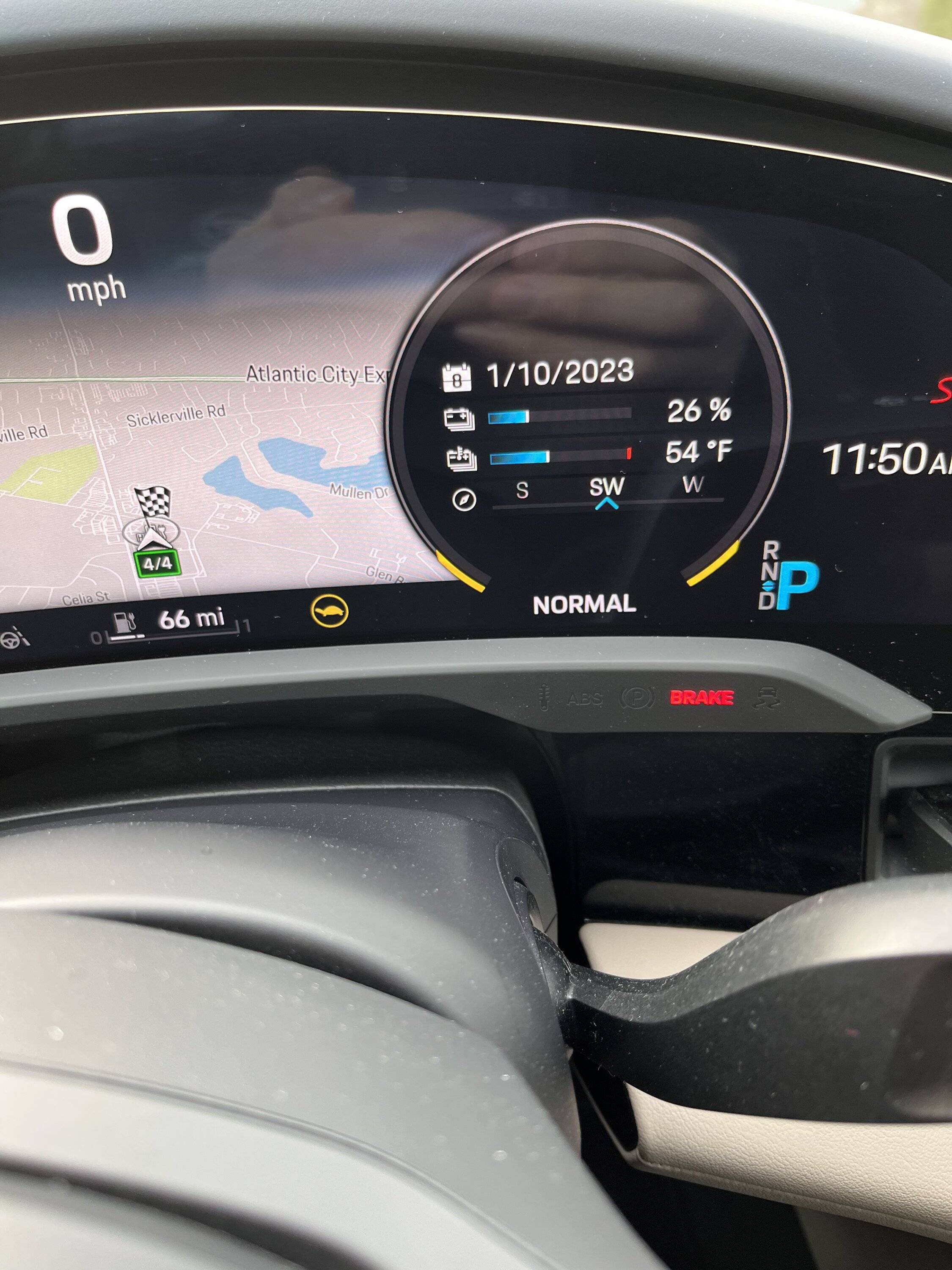

Outside of the car having no heat here is the bigger issue. It’s same damn hard to charge the car. I am currently plugged into a 350kw charger and this is what I am dealing with.
The batteries will not heat up to accept of fast charge. The dreaded “turtle icon”.
This sucks!
