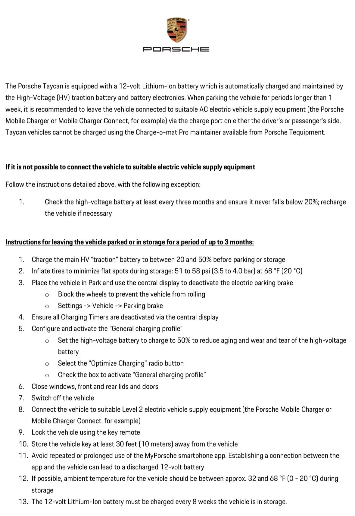

This topic seems to always get a variety of different answers. Porsche’s official recommendation is to leave it at a SOC of 20-50%, plugged in, no timers, optimized charging profile set to 50%, and if for longer than 8 weeks to also trickle charge the 12v.
3 weeks is no big deal if the car is working properly but a few have experienced draining 12v in as short as 2 weeks. Likely a separate problem. I’ve had no issues with HV or 12v loss up to 8 weeks.
Porsche Taycan Not Driving Taycan 4S for three weeks IMG_1170
Source: https://static.nhtsa.gov/odi/tsbs/2022/MC-10209809-0001.pdf

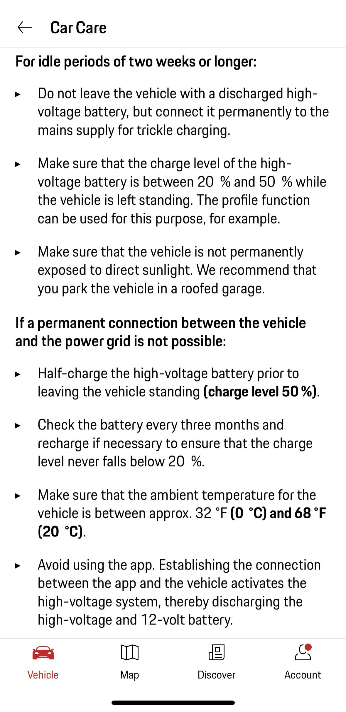

And the less detailed version in the manual:
Porsche Taycan Not Driving Taycan 4S for three weeks IMG_1169
Very useful information. Thanks for the details. Looks like Porsche and NHTSA both are recommending to connect to the charger while parking the Taycan for more than two weeks. I am thinking to leave It connected. It seems that 12V battery is not getting charged even if I leave the charger connected but I am not going to connect to the car (using my Porsche) often and so it should be OK.
