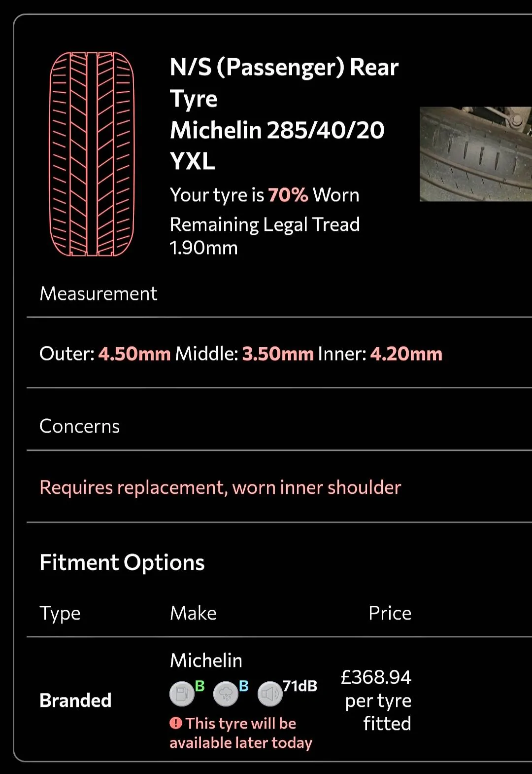

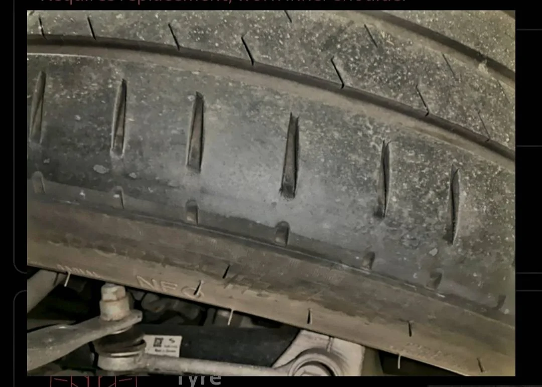

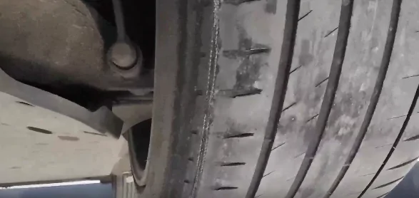

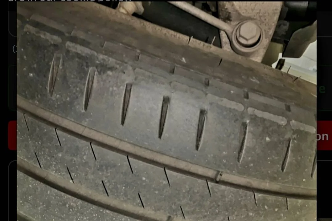

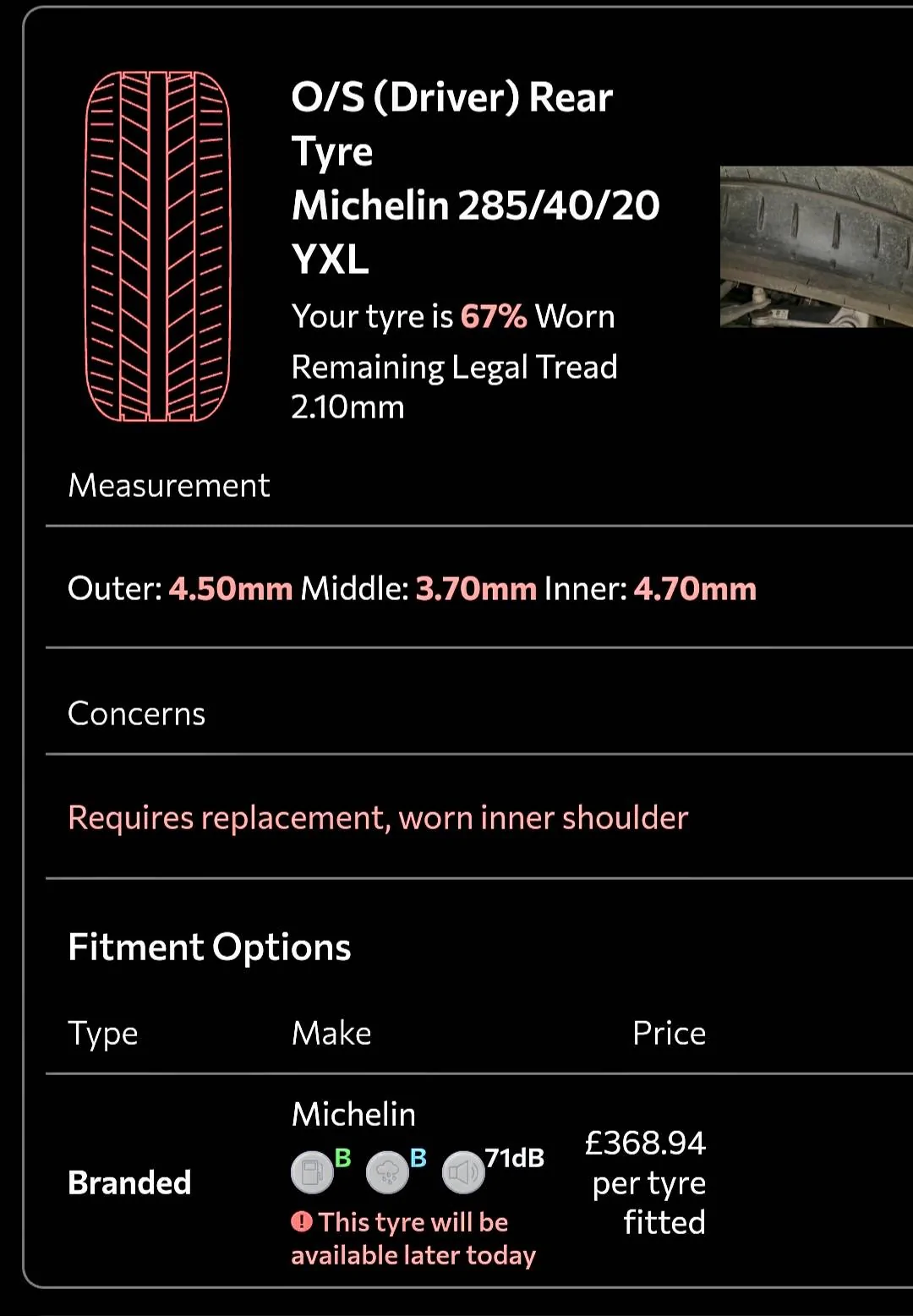

My car is in to have the heater sorted as well. So received the Health Check; the tyres are down to the cords, on the inside, but still within legal limit across the tyre. This does not seem right to me and did not get a convincing response why. Worst thing is it is dangerous, I check the tyres regularly i.e. running your fingers across the three tread wear indicators, which you can see from the pic are OK (but close to needing a replacement). The tryes have done over 30k so happy with them. Need to push a little harder with the dealer to find a an answer, to ensure that the next set don't go the same way.

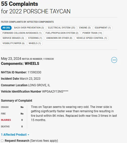

This has been a very common issue on here. There are other threads about it.
https://www.taycanforum.com/forum/threads/taycan-problem-potential-catastrophic-tire-failure.16788/
My rears tyres also seemed ok treadwear, but at service the inside wall was found to be shot.
Michelin PS4 at 18000 miles.
No explanation from dealer and the only thing I can think to do differently is to change the chassis settings this time round.
I used to have it in 'sport' permanently, but changed to 'normal' this time round.
Will see how it goes.
