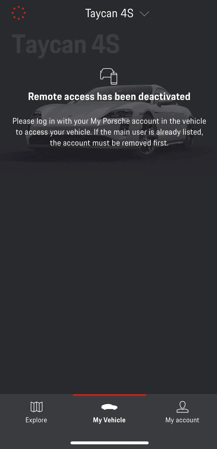

Have only had my 4s for a couple of days. Have pretty much figured everything out on the car except for car connect. My car shows up as one of my vehicles...but I cannot control or see status of the car. Randomly...I get a “app notification” that says that “climate control process completed”. That may be when I use the Porsche charger versus a 3rd party charger?
The app tells me to remove and re add my profile. See attached pic. Does anyone know if I can delete my Porsche ID from the car and re add it without issues? Any other idea Why my car is not talking to the server?

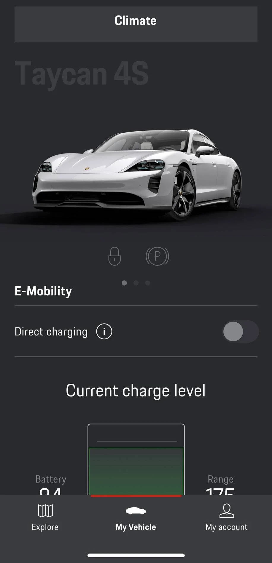

Update. Deleted my profile in the car. Signed back in. All my settings came back. And both the app and website started working with full functionality. maybe just a bug during initial setup.

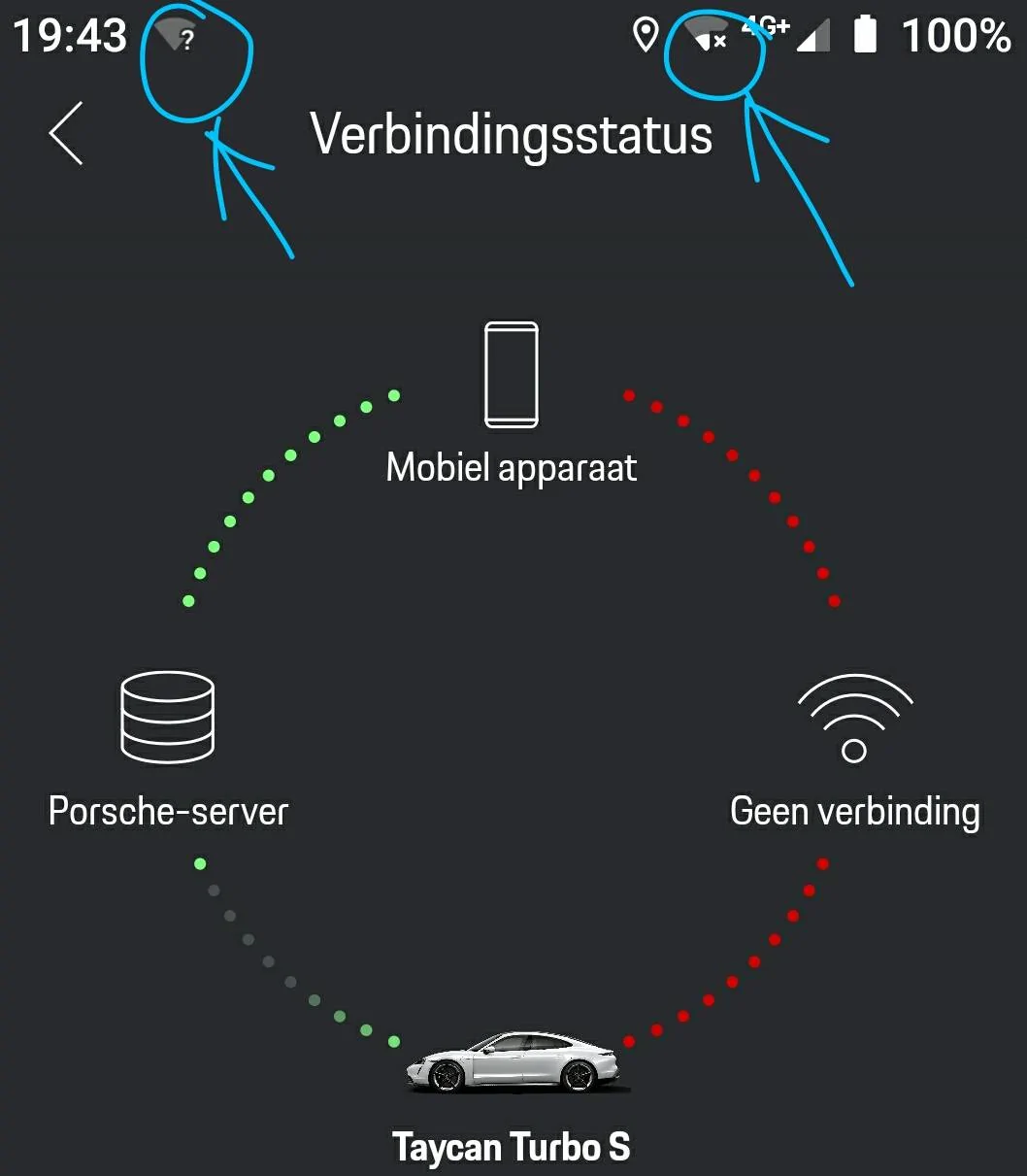

I did a test about keeping my internet connection when the phone connects to the car.
It does.
Interesting to see what way the connection is established when I open the Porsche Connect app
First one, with normal WiFi activated:
Porsche Taycan Porsche Connect not working 2020-08-31_19.49.56

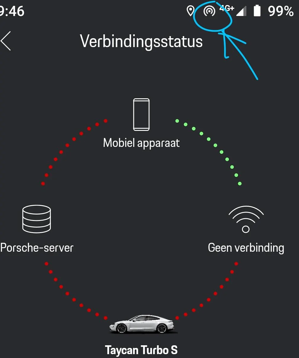

Second one, with hotspot on my phone activated:
Porsche Taycan Porsche Connect not working 2020-08-31_19.48.23
Funny huh?
It seems that with your hotspot activated you make direct contact with the car but still have internet on your phone.
That would suggest you can stream music through your phone to the car, right?
The first pic doesn't allow that cuz you'll need a datapackage or free music.
Right?
In theory, I mean...

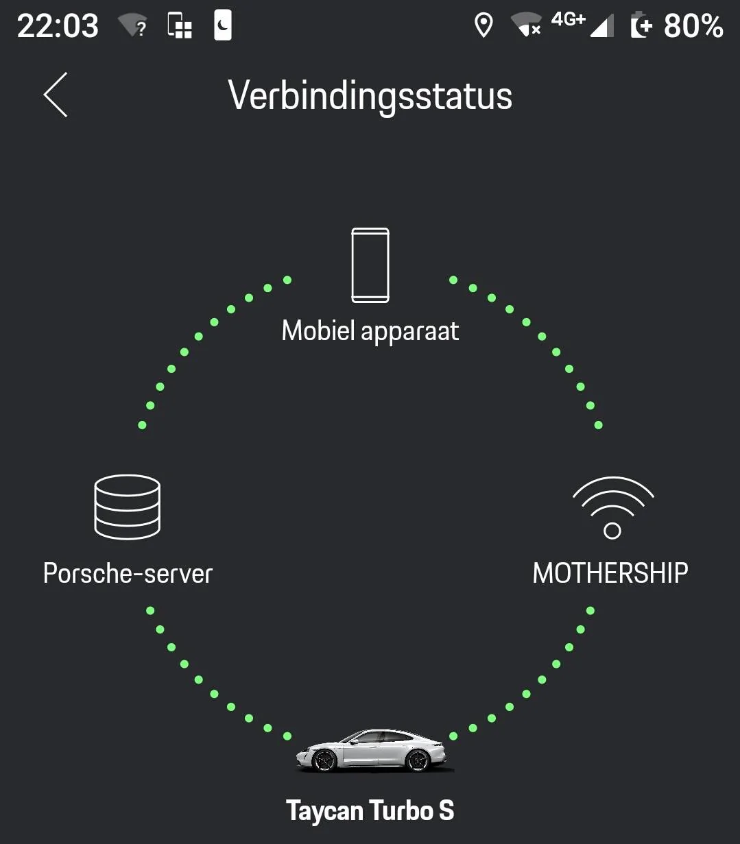

To make things even more confusing:
Porsche Taycan Porsche Connect not working Screenshot_20200831-201611
With normal WiFi on my phone enabled, it now has waken up the car, showing the name of the WiFi hotspot in the car: "mothership" and it shows the connection is established.
I give up.
Anyway, I can send data from and to the car (most of the time) and that's the only thing that matters.

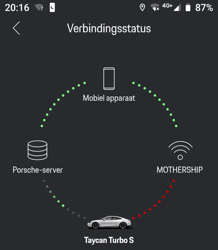

I've see full green circles as well:
Porsche Taycan Porsche Connect not working 2020-08-31_20.21.54
