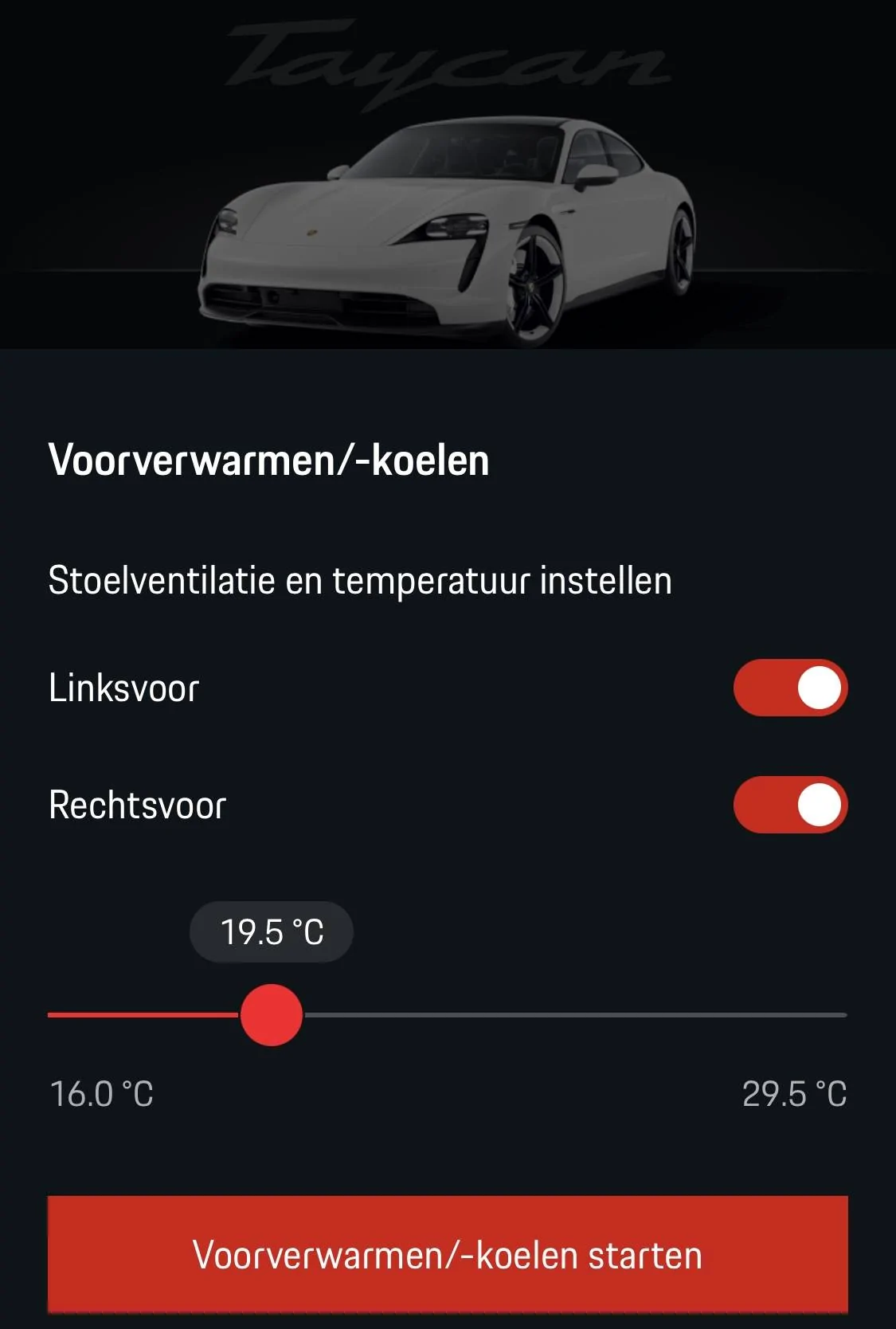

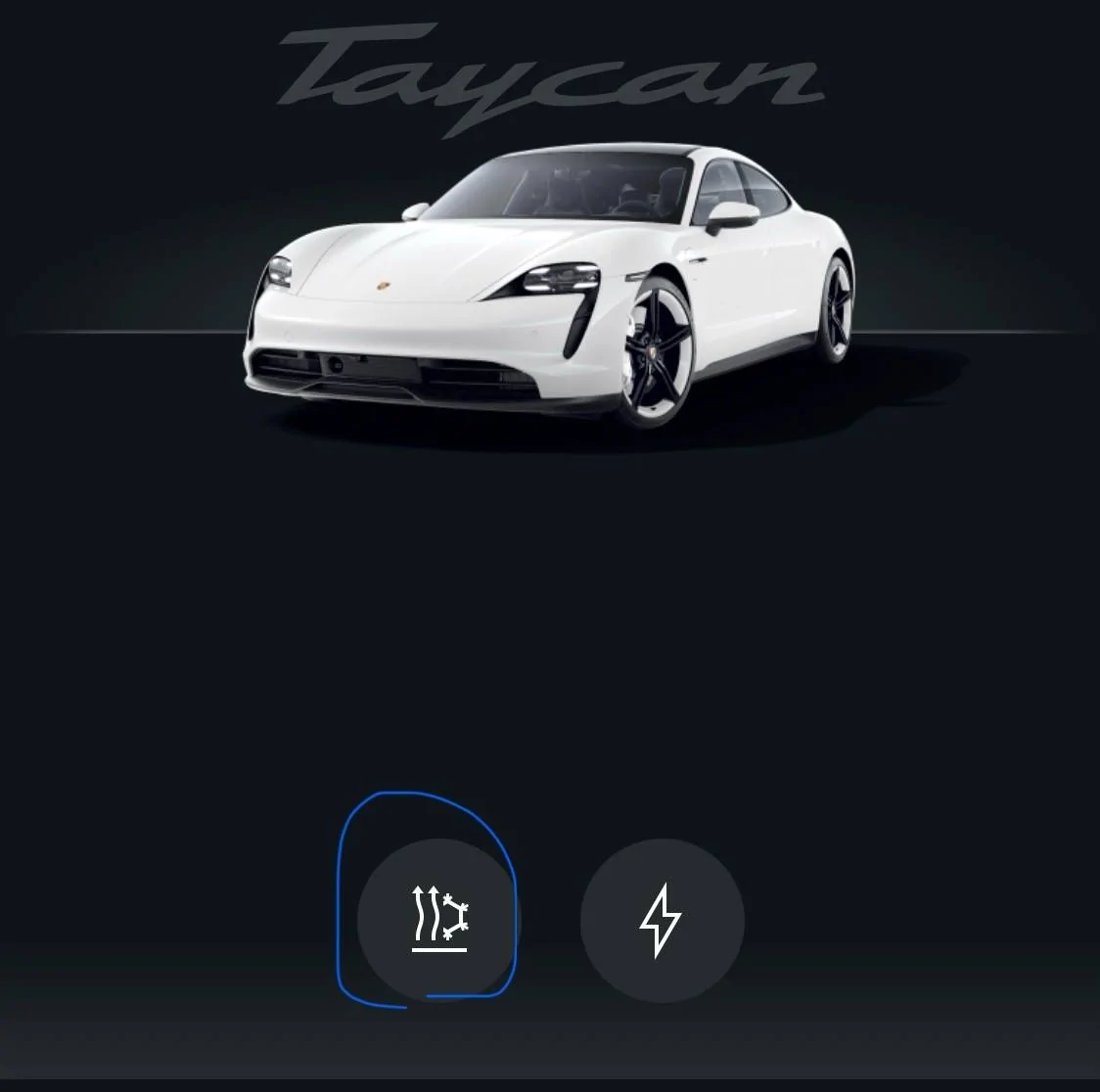

I did not realise it would be different in other countries. I am in the Netherlands.
You just press this button in the picture below and then the menu of the second picture appears. If you don’t get this without the subscription it is indeed quite bad..

Maybe that explains it, yet (in NL) I still have the pre-heat/cool feature above without the connect subscription.
Or should I not mention as Porsche may be reading here as well?
