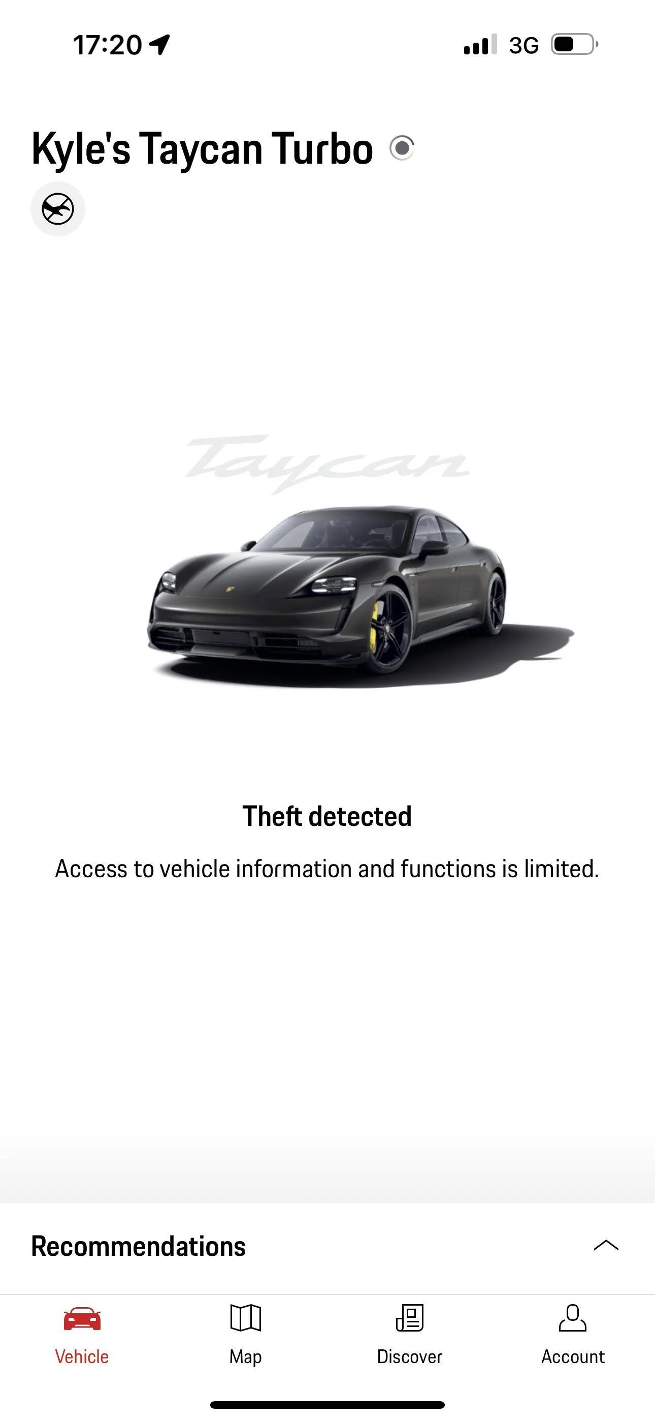

Hi all. Newbie here. I have a Porsche Taycan Turbo and they did an overnight update last wednesday (22nd) and since then I cannot drive my car. On the app it shows as theft detected and when you get in it's not dead, but wont load the displays. The app has updated to a new security standard but the problem remains
Have had very little, infact nothing back from Porsche unless i ring them and ask. Car hasn't been collected and they have told me there is no fix, not yet at least. Their words were 'the update had killed the car'.
First world problem but currently in a clapped out merc courtesy car which is a little frustrating. I assume there are others in the same boat, have Porsche been any better and any recommendations? I feel it will just sit on my drive forever at this rate.
I've seen similar posts about servers down, but not one dedicated to dead cars so apologies if I'm duplicating a thread here.
thanks in advance

Same problem here.
My car simply won't start and I have the same message on the app. Worse still, my car is communicating with the security company every hour raising the theft alarm. Vodafone has turned off the alerts many times but it just keeps happening. :headbang:
The car must think it has been stolen so it must be the tracking software??? I suspect the car is shutting itself down as a security measure. If I am right, this is a high-risk feature in my opinion.
For those interested, I managed to start my car by disconnecting the auxiliary battery for a few seconds. This basically resets the car but the problem reoccurs when I turn it off again.
Going to take it to the garage tomorrow. I've also heard that there is no fix. Apparently, there has been a software update that affected all Porsche cars but the Taycan is now the only one with the problem.
Either way, I have no car to drive.

OK, My car has just started normally. I have driven it, stopped, turned the engine off, and started it again. I couldn't do this yesterday.
I have made a couple of calls and I have it on good authority that Porsche rolled out a software update this weekend on the servers that control the security monitoring of the Porsche fleet. I am guessing here, but I suspect that they have rolled back the release.
Again this is pure speculation, but I suspect there was a bug that locked the car down if the alarm was triggered. I triggered the alarm on Saturday morning because I left my driver key in my kitchen. Four hours later, I couldn't start the car. I understand that hundreds of cars have been affected over the weekend with a similar issue.
Anyway, what I have learned is that if you disconnect the auxiliary battery, it re-sets the Taycan. You need a 10MM spanner to do it and it takes seconds. This is what the AA engineer did when they attended my call-out this weekend. I waited an hour for him to literally disconnect the battery and reconnect it. KEEP YOUR CAR UNLOCKED WHEN YOU DO IT!!!!!!!!! otherwise, the alarm will go off. This is what I did :cool:
What the Taycan really needs is a Hard reset button somewhere.
Anyway, I hope this helps and fingers crossed that my car will start tomorrow morning.
