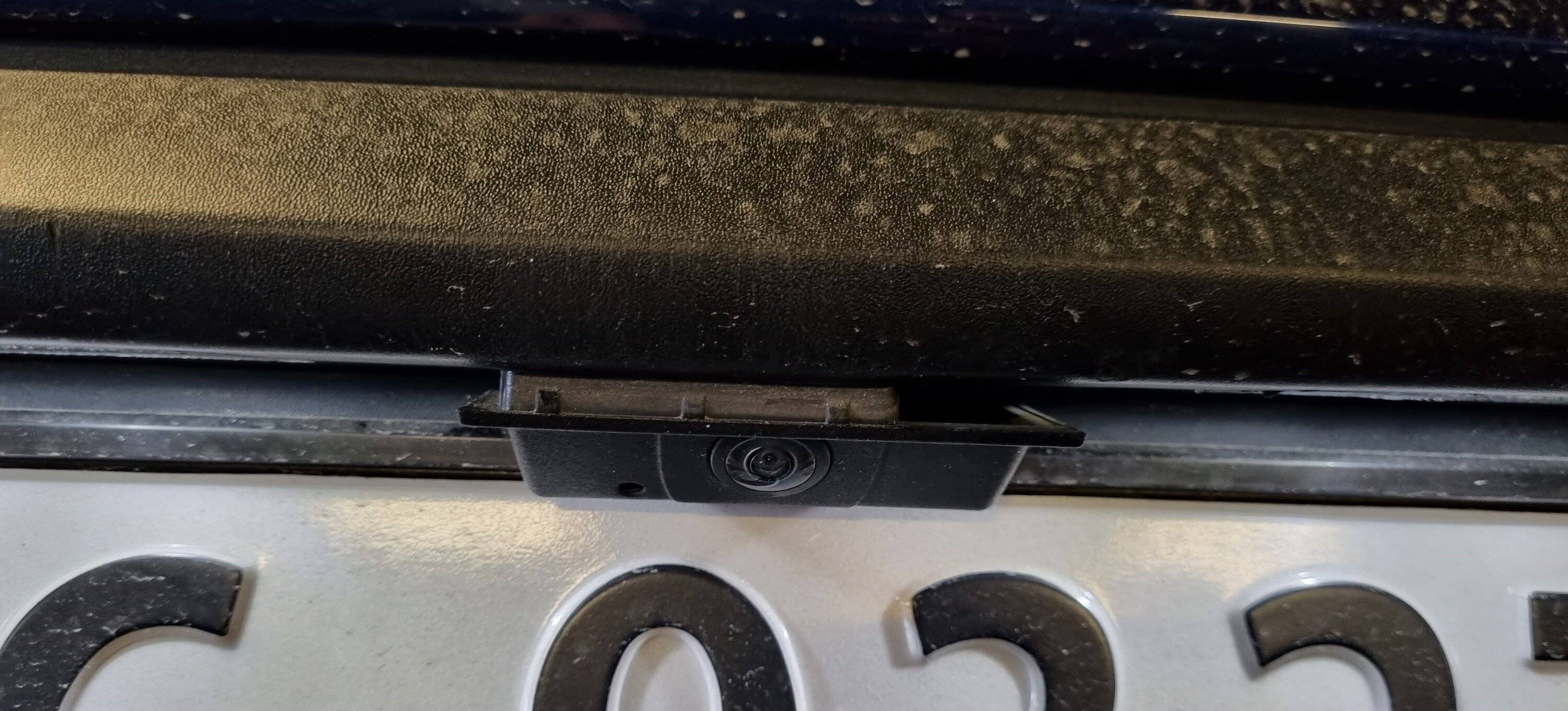

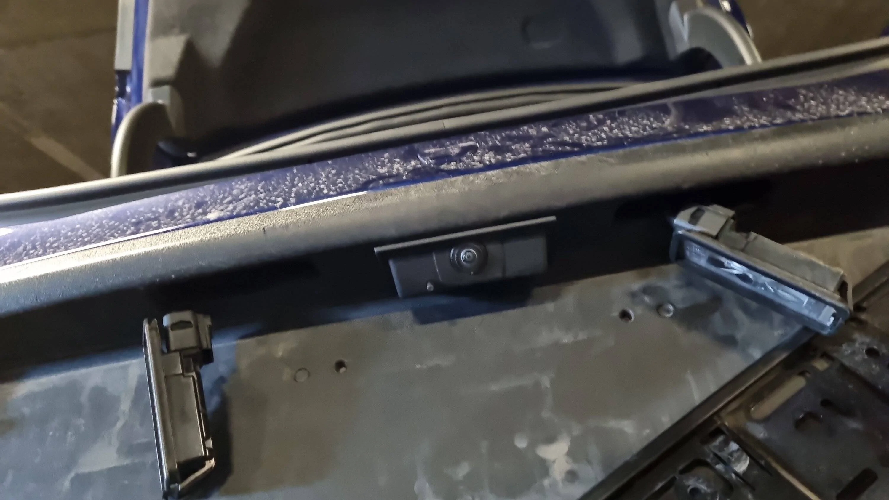

The camera was sticking out a bit so it was easy to pull it out. I also removed the two rear plate lights on the sides of the camera, in order to get some access space.
After a little bit of poking around I managed to find the nozzle of the washer that was still connected to an inner piece of plastic that forms the camera/washer unit.

After about an hour of fiddling I managed to fit it all into place. You need to insert the inner part into the hole in the bumper (it is actually bigger than the hole so you need to find a good angle to push it through while the nozzle is connected to it). Then you need to hold it from inside with your index fingers through the side light openings and position the camera into the outer plastic casing. The last step is to push the two parts of the plastic casing into each other (the visible one on the outside and the one on the inside of the hole).
Porsche Taycan Rear Camera Washer Problem 2
And here it is back in place with the nozzle in the correct position.

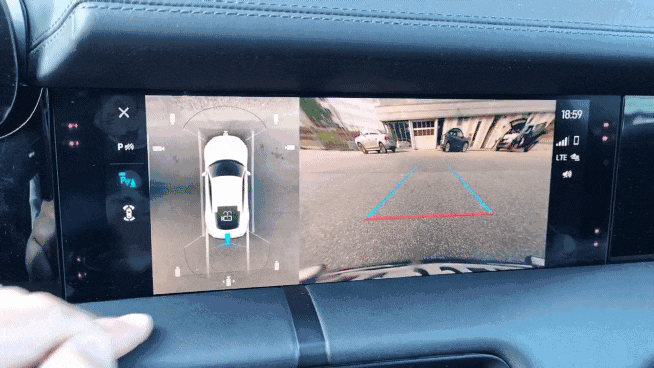

I didn't know it had one! How do you make it squirt - Pressing the rear windscreen?
When you're in reverse there will be an icon/button as shown in the gif above. It's not there all the time, I guess only when you're in reverse. On the CT/ST it's connected to the rear wiper washer, so there won't be a button there.
Ah. I have the CT. Thanks.
