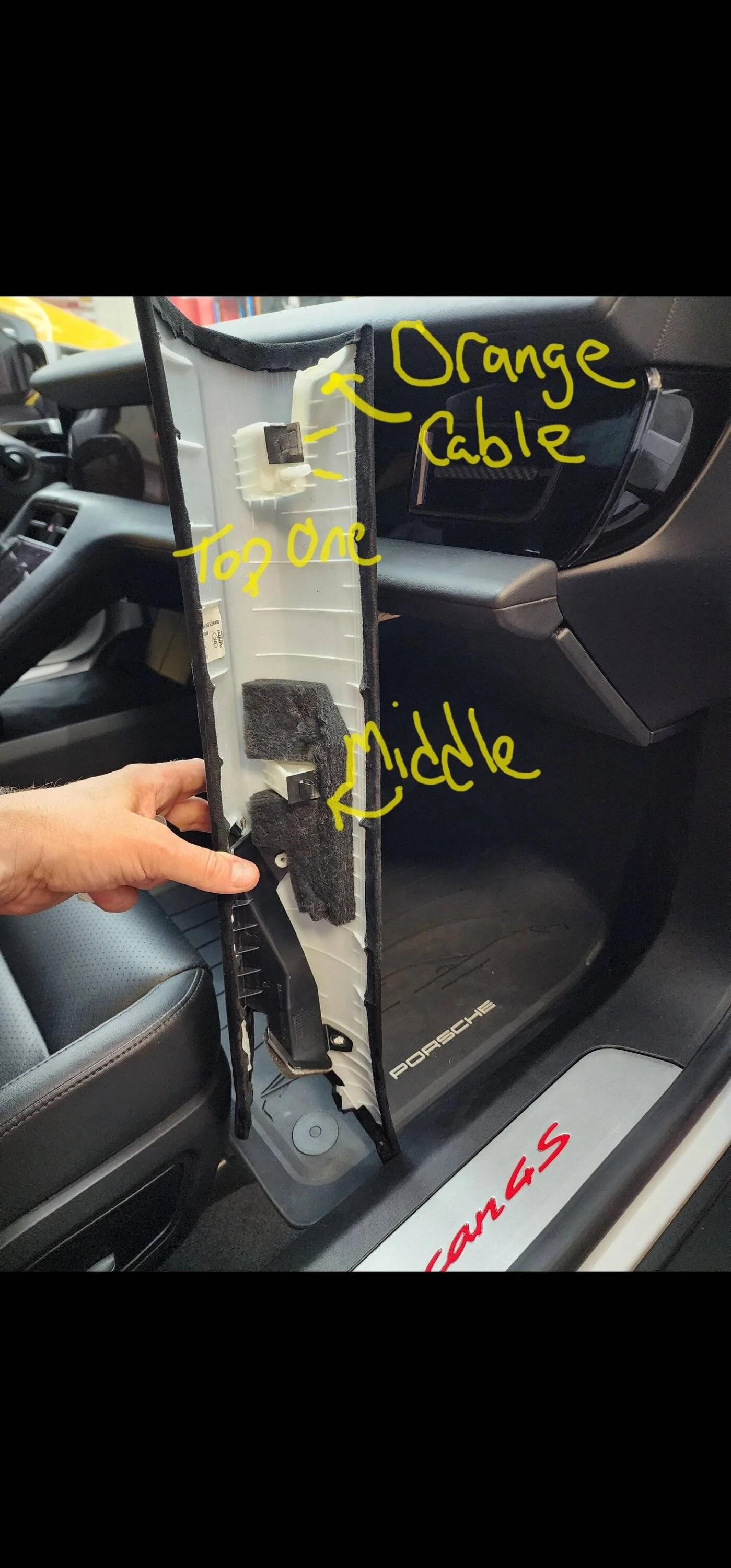

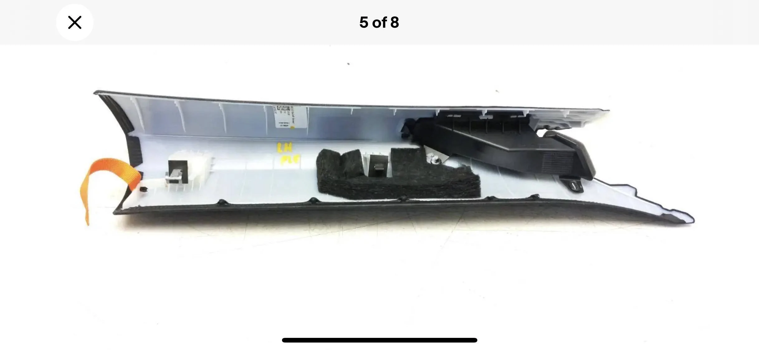

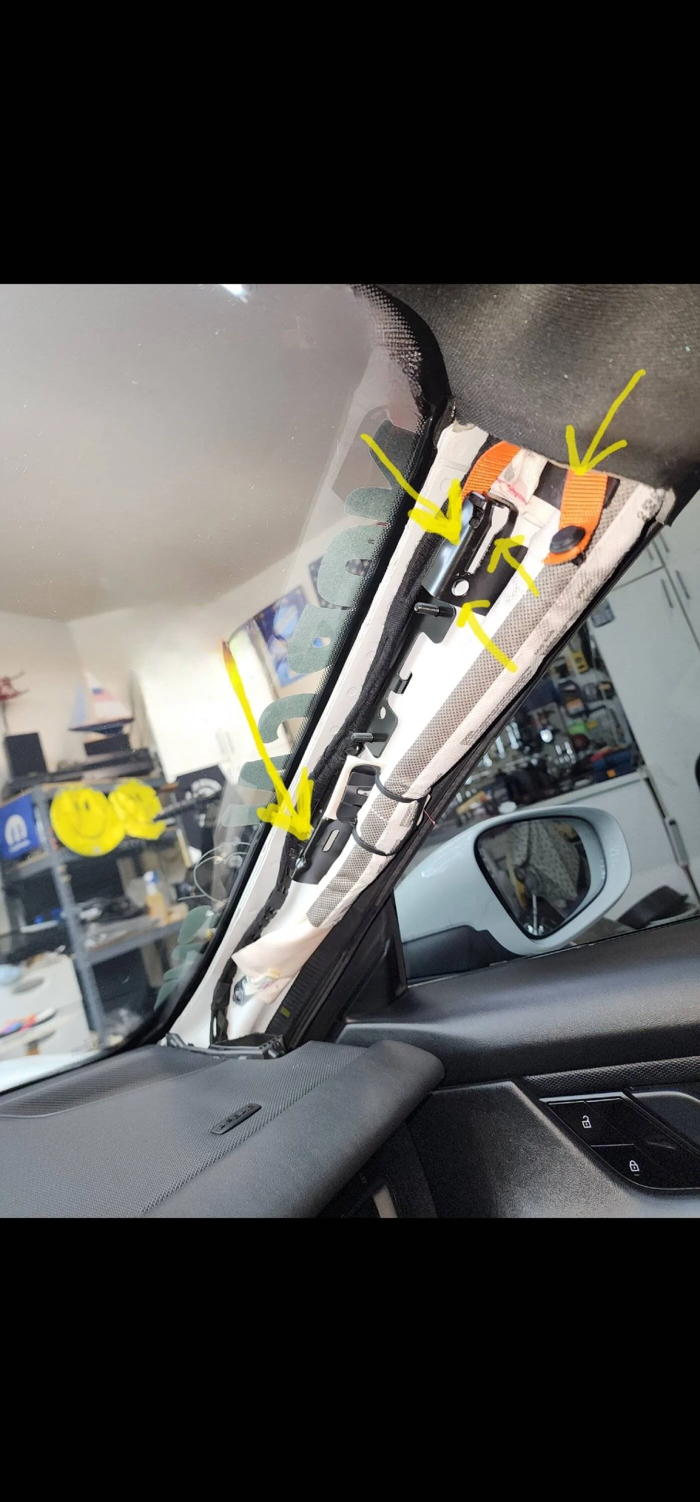

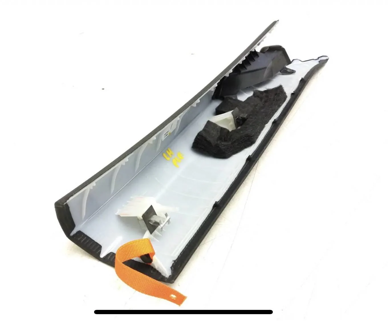

The tab nearest the orange strap needs to be partially released so that the backing clip can be slid out in order to release it. This is a safety issue design to stop the entire a-pillar trim flying out like shrapnel when the airbag behind it is deployed.
You use a hook to pull it up and out so that the clip can fully released and you can remove the trim.

It’s quite simple. Release the A pillar from the top as far as it goes. The clip nearest the top won’t fully release until you pull out the backing plate. The backing plate has a hole in it. You need to use a hook to access it from behind at the top of the A-pillar. You then pull it up towards the top of the A-Pillar and this allows the A-pillar trim to be fully released. The orange strap is attached by a push fixing which is much easier to remove.

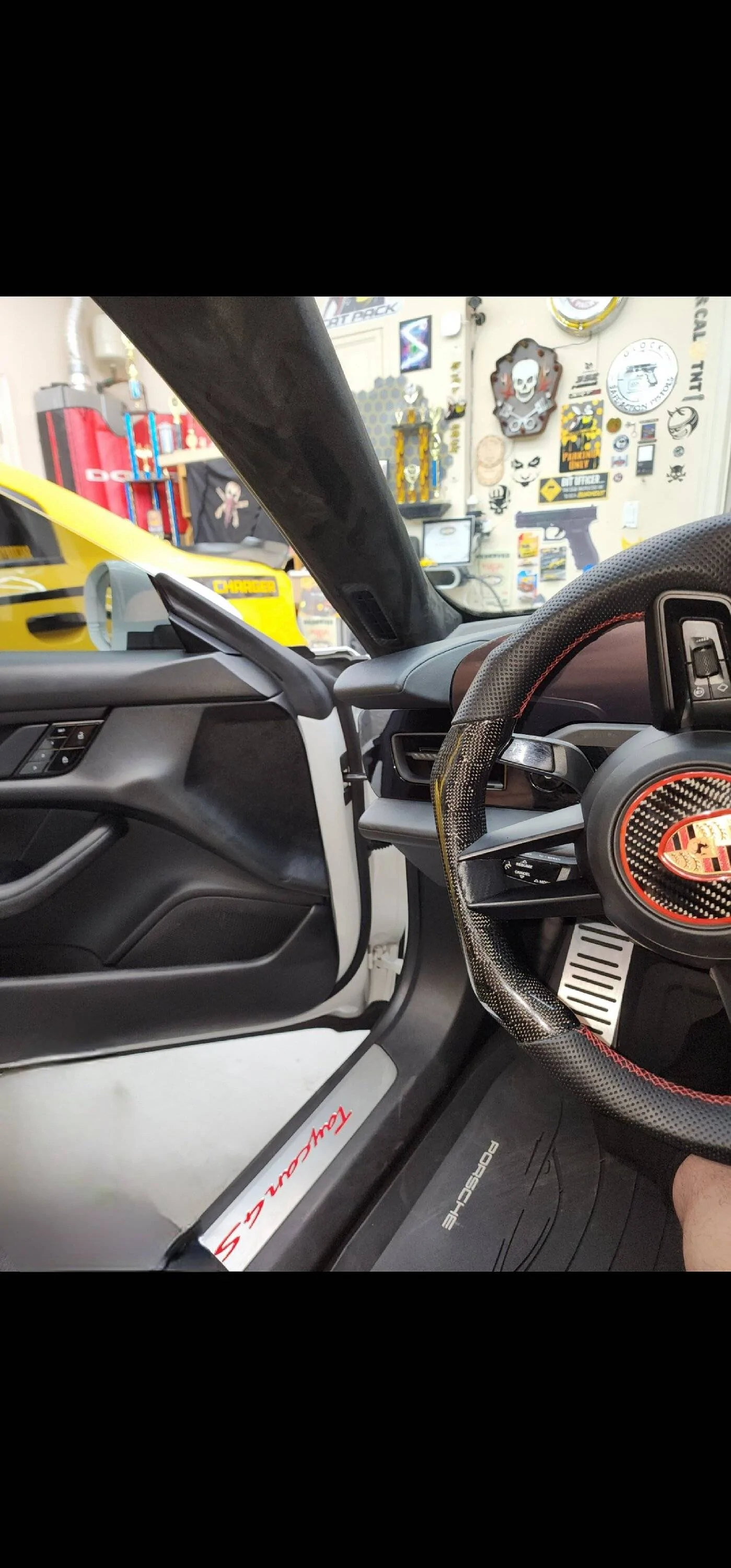

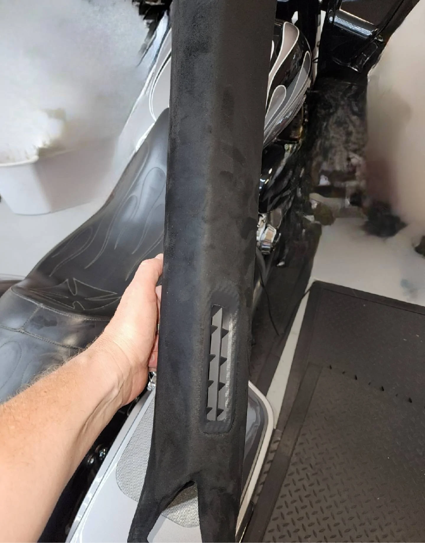

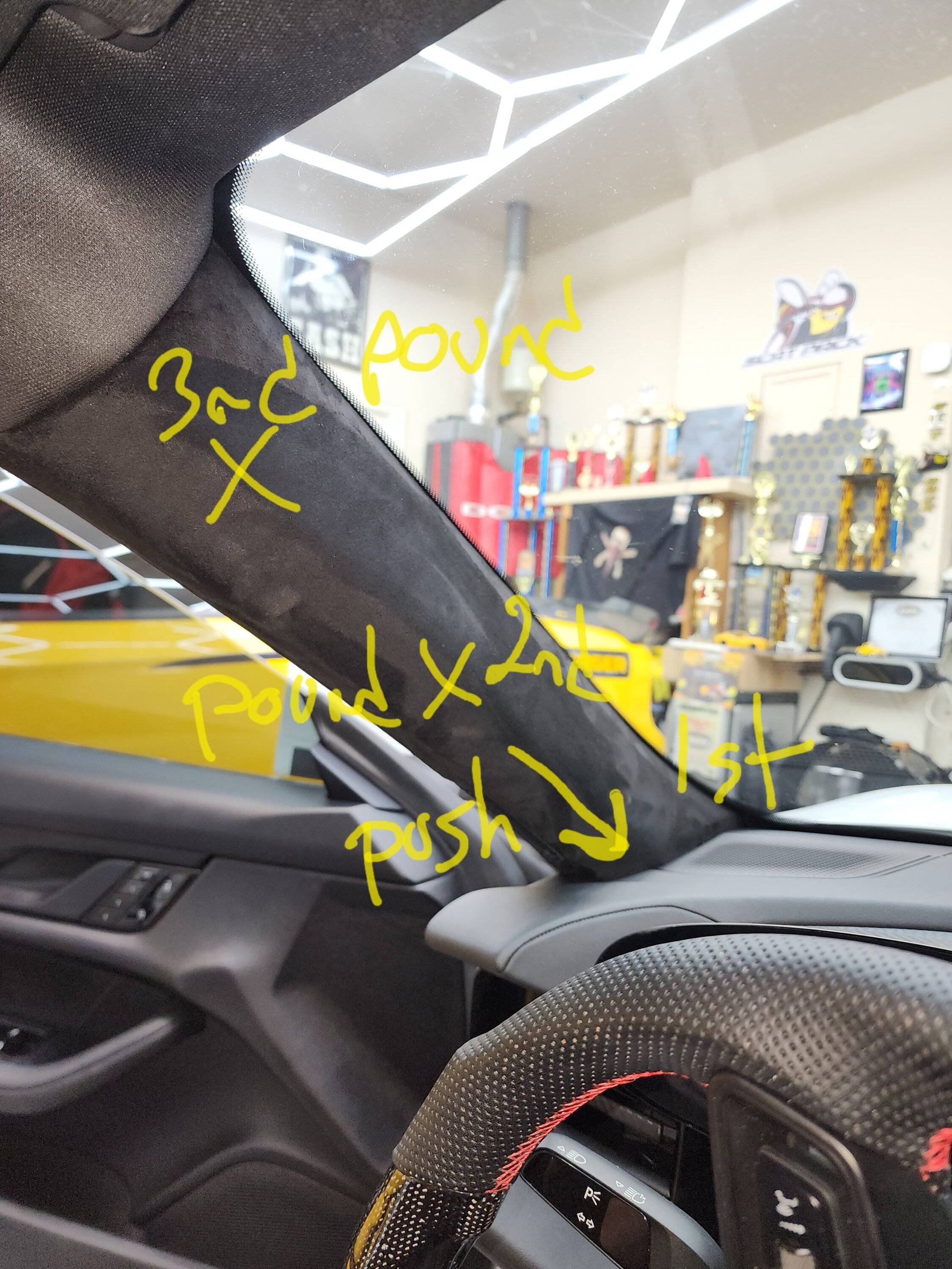

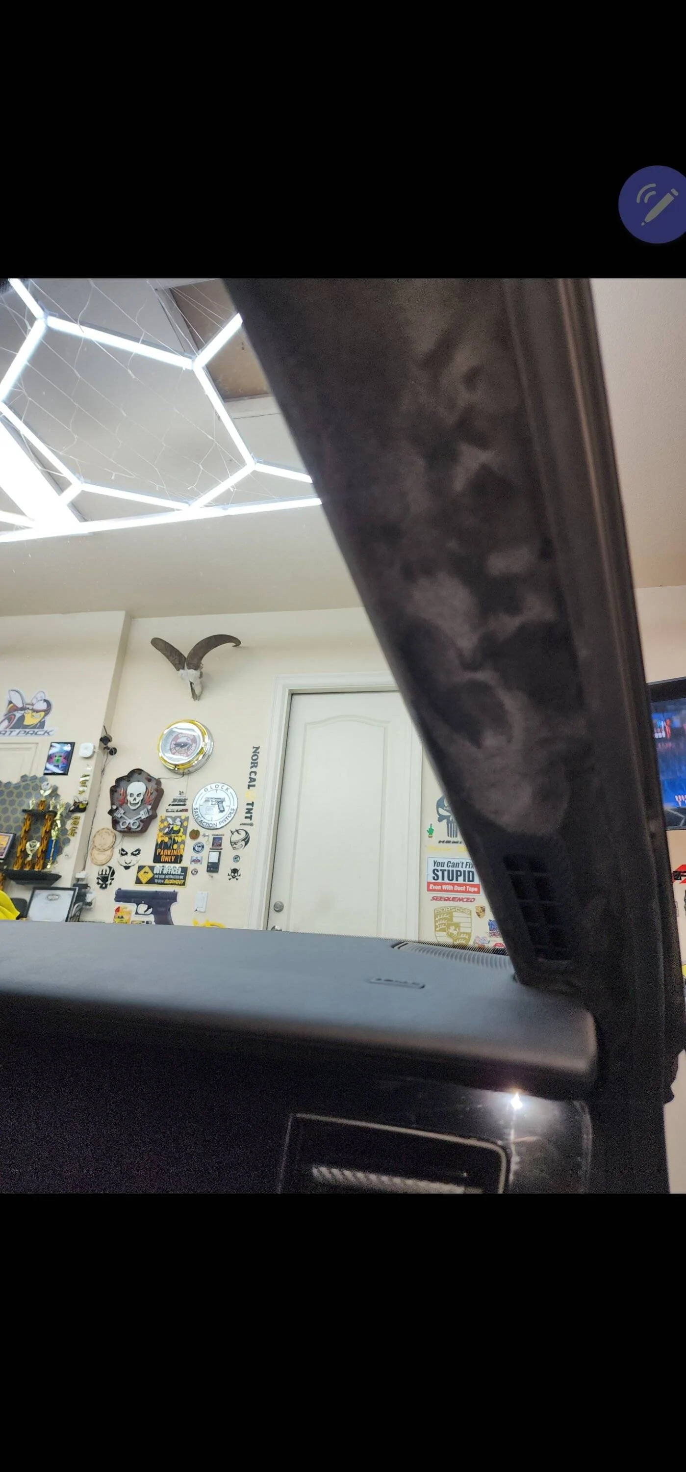

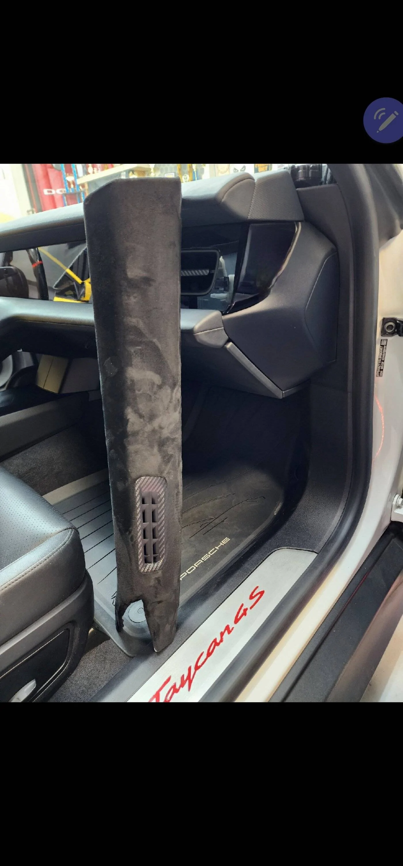

I wanted to say Thank you for all your help.
It was a Complete Success and I took some pictures for everyone too.
I LOVE LOVE LOVE the look of the Alcantra.
I think I'm going to do the rest of the headliner too.
A Pillars aren't as bad as everyone said to remove orput back in.
So anyone else wanting to do it it's Not that Bad.
Here's the pictures I took.

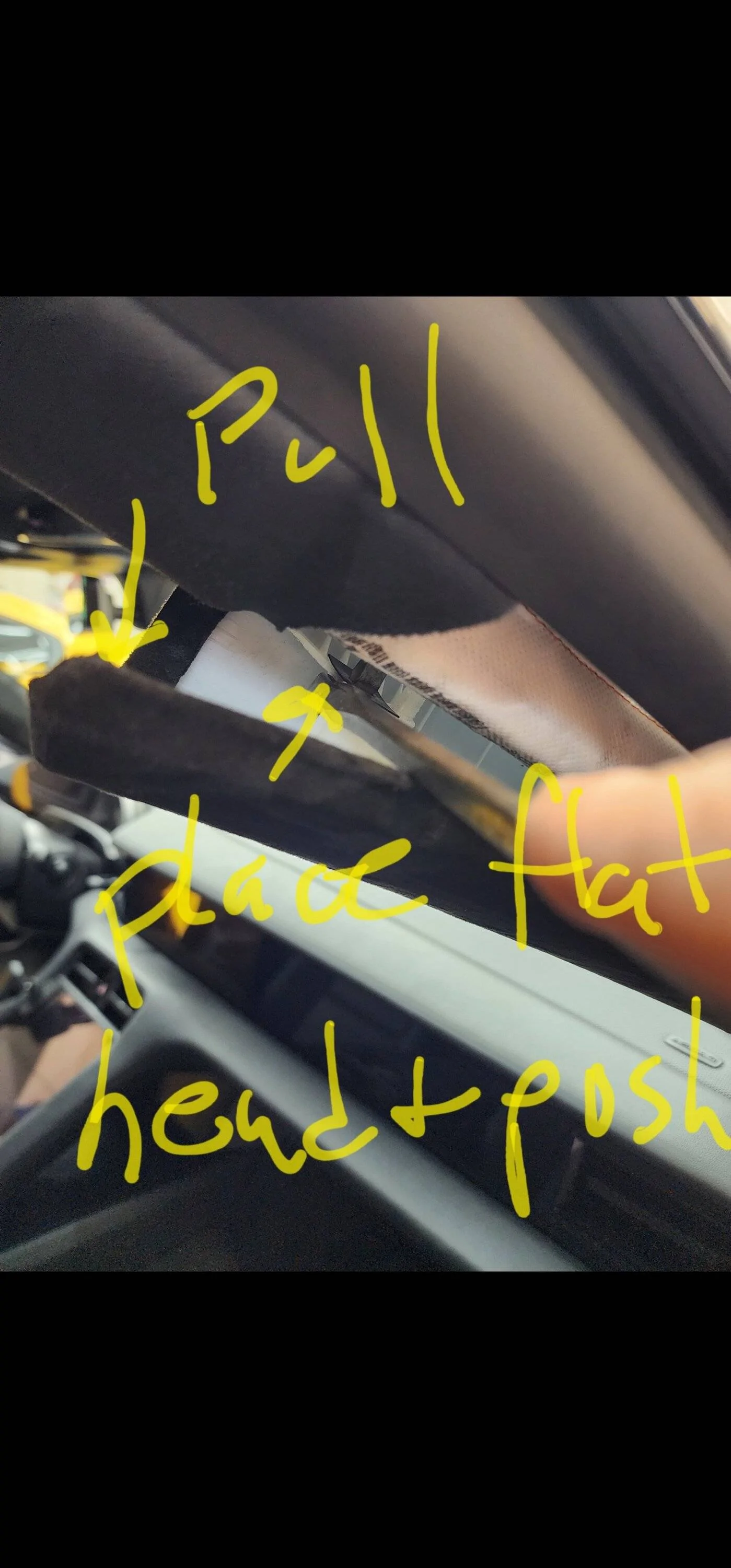

Thanks for posting. What did you use to hook the backing plate during removal of the A pillar trim?

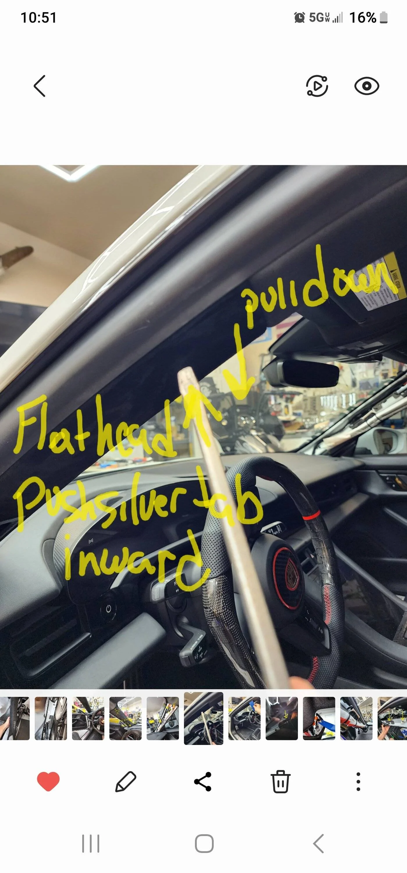

I took a flat head screw driver and pushed the silver hold tab inward and it popped right off.

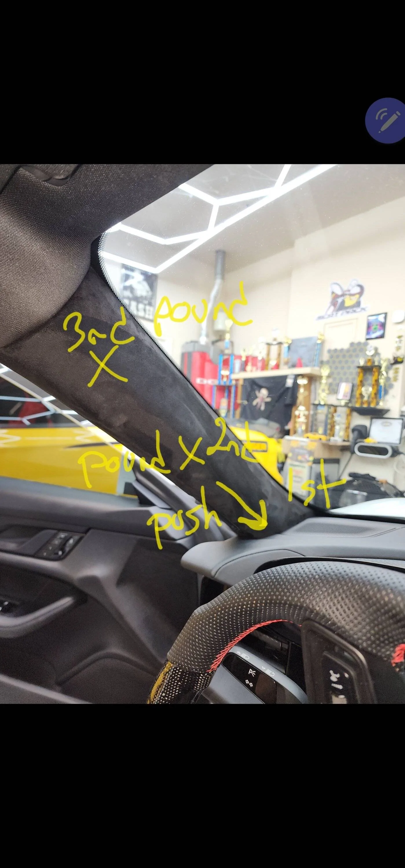

To install just put all your pieces back on the A Pillar. It makes it pretty easy to reinstall.
