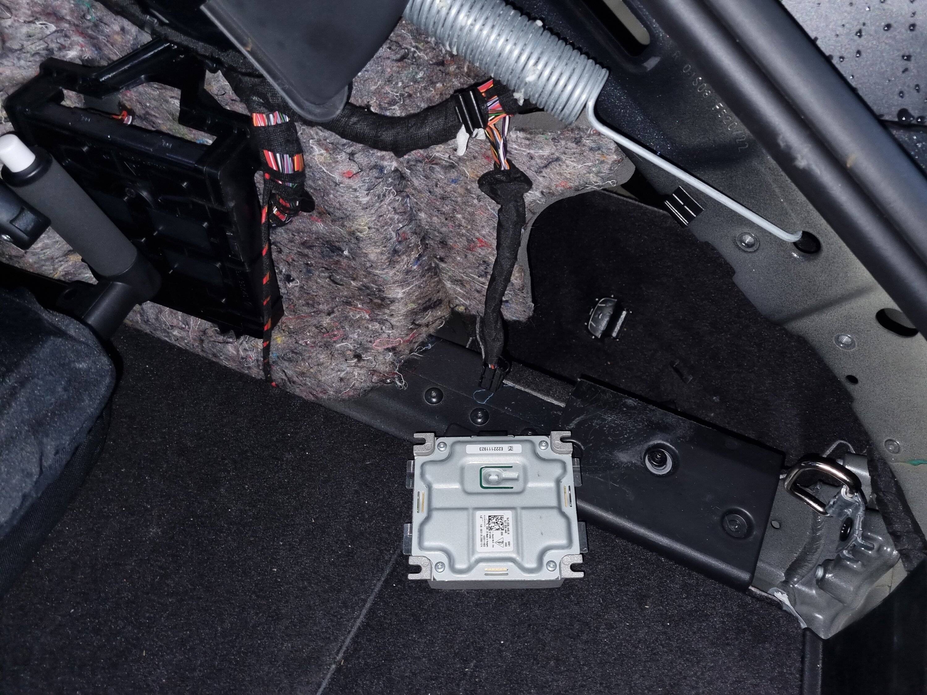

I had disconnected the Module and the Sportsound is still there.
Despite it has the same Partnumber and location as in the Retrofit Guide, it does not make any sense. Also the wiring harness to it has not enough pins for connecting 3 speakers to it.
Something is fishy here.

if wiring is not fitting may be you are mixing the AVAS Sound Generator and the optional Sportsound? Their ECUs look very similar and their names as well.

That seems to be the case weirdly.

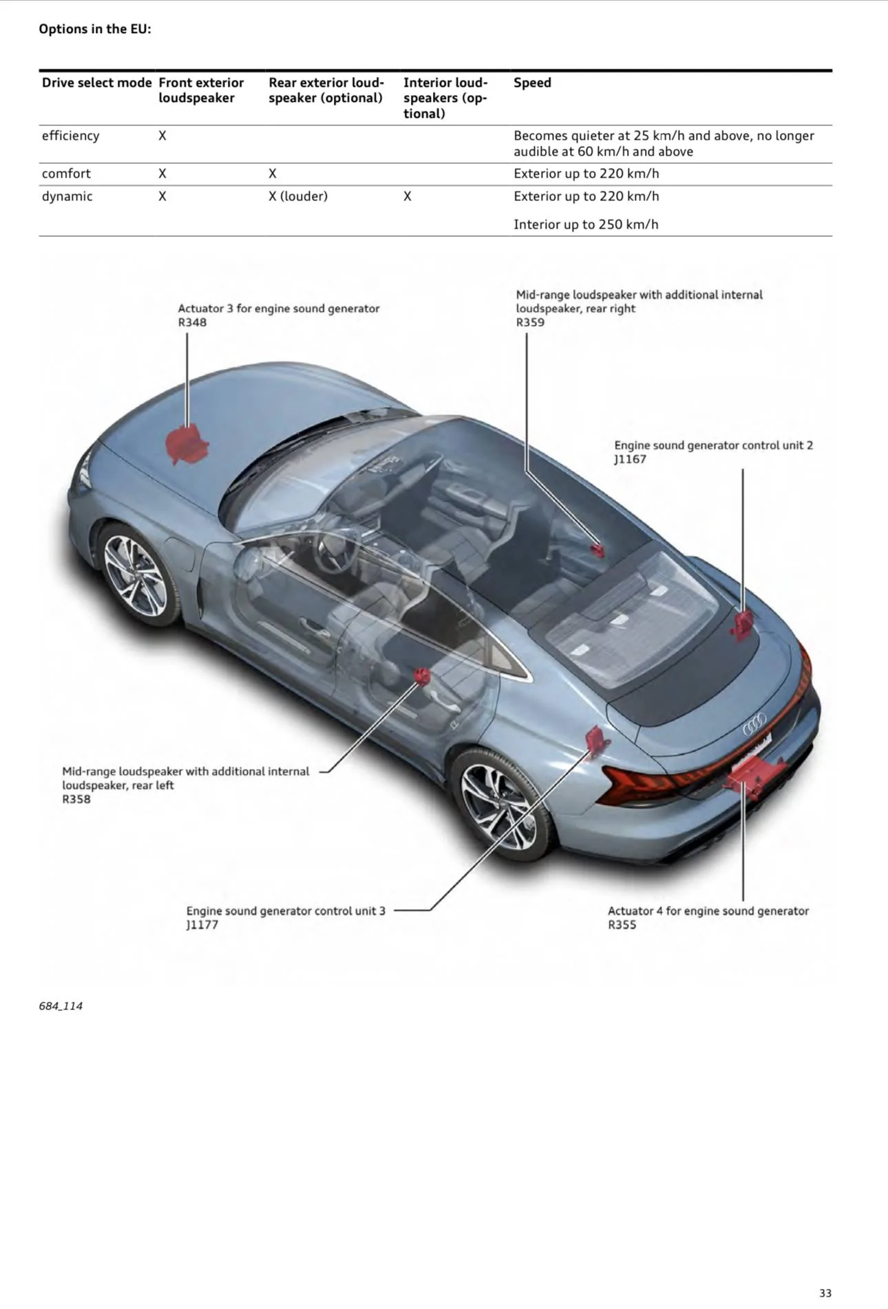

Do you know where the Sportsound Module is in the Back? So far i only found the pedestrian module apparently.
For the e-tron GT…perhaps Taycan is in a similar pos:
