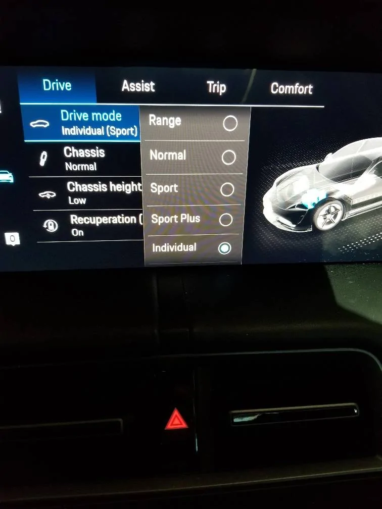

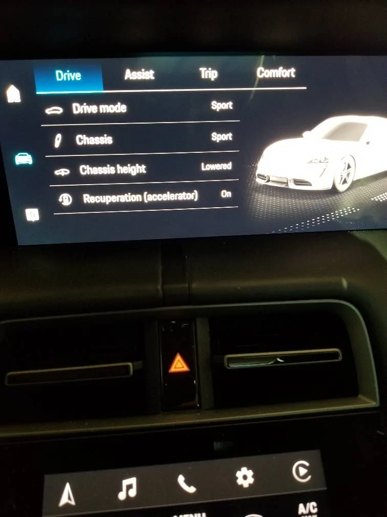

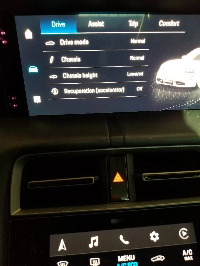

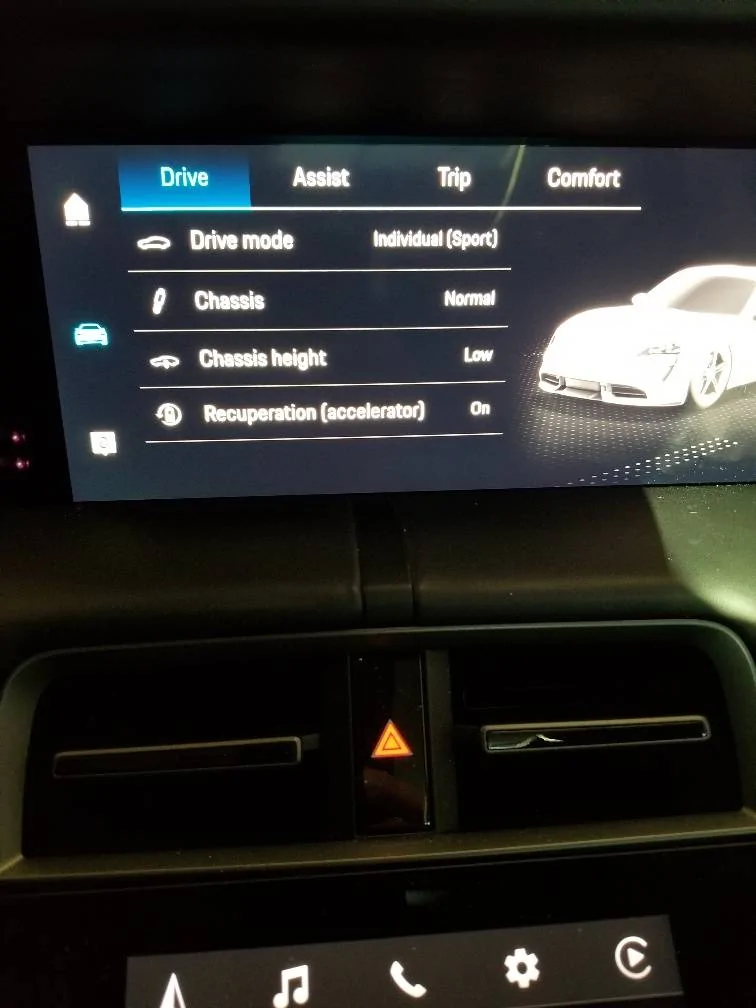

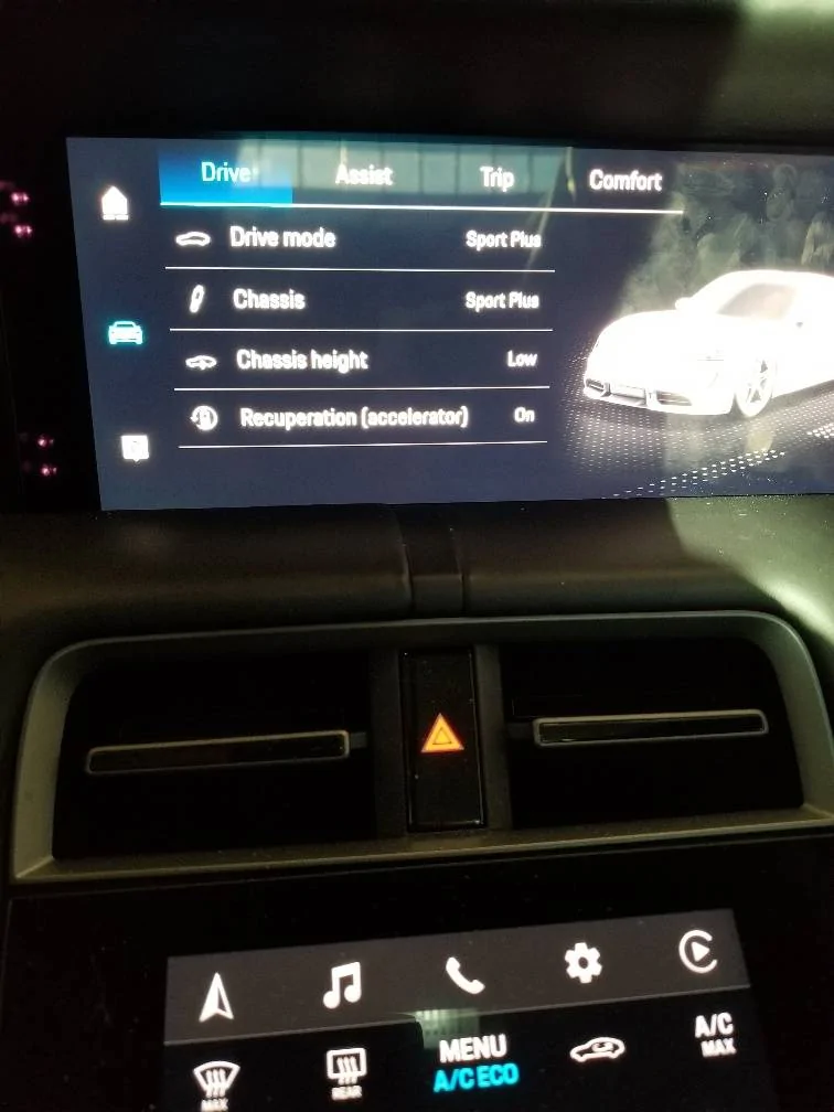

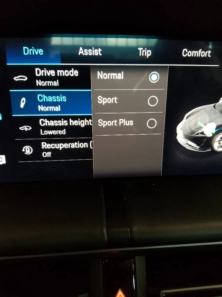

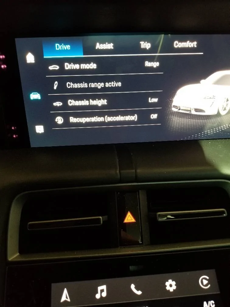

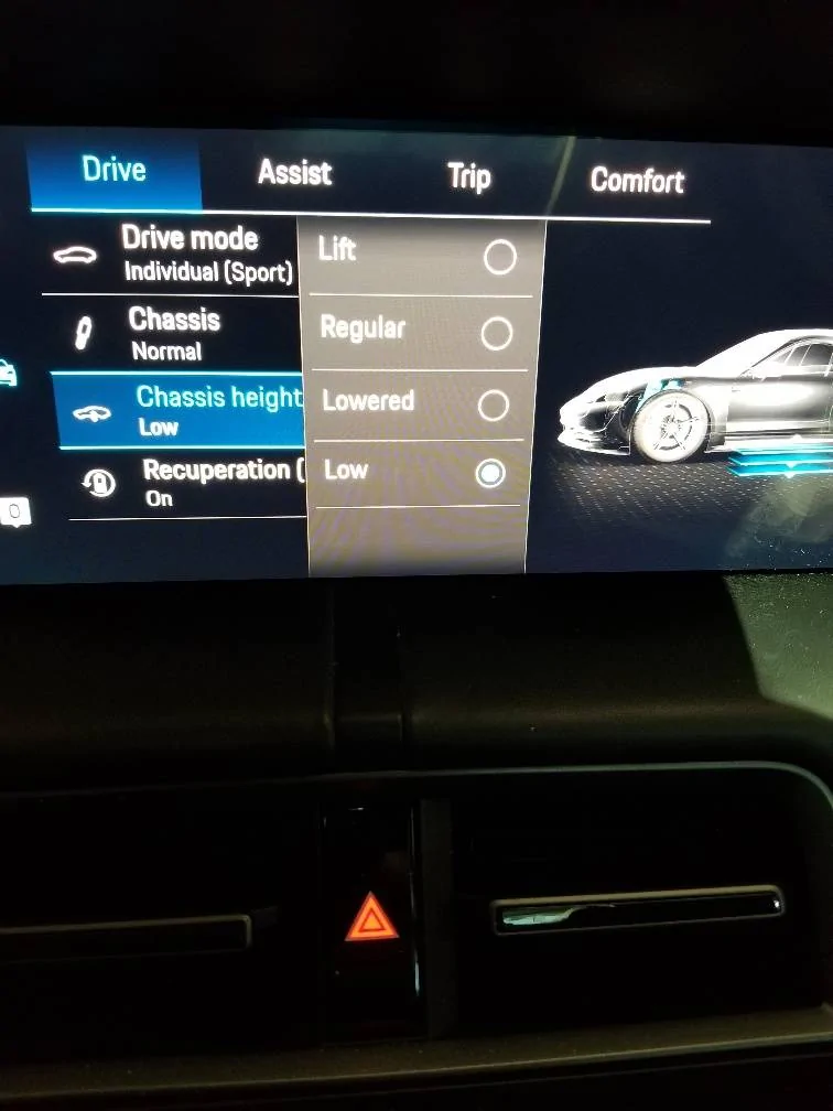

@torx - There are Drive Mode, Chassis, and Height. Each of these is preconfigured depending on the Drive Mode selected, but can be temporarily modified until you shut off the power. With the Sport Chrono option you also get Sport Chrono and Individual Drive Modes. Sport Plus in Drive Mode (power) is different from Sport Plus in the Chassis setting (suspension). The Individual Drive Mode can be programmed with your preference for Chassis and Height. I have Individual setting programmed with Sport for Drive Mode, Normal for Chassis and Low for Height (same as Sport Plus height).
As far as Height, Range and Sport Plus are the same and Normal and Sport are the same (higher than Range or Sport Plus). Here are some pics.

For the 4S you need to have the Sport Chrono Package option to have the Individual programable setting (note Porsche Electric Sport Sound mentioned below is a separate option)
Includes:
  • Multifunction GT Sport Steering Wheel including mode switch for selecting drive modes: Range, Normal, SPORT, SPORT PLUS and Individual
  • Analogue and digital chronograph
  • SPORT PLUS mode with performance oriented tuning of chassis, Porsche Active Aerodynamics and temperature control of the Performance Battery
  • Individual mode for the individual configuration of the settings for driving mode, chassis, chassis level and Porsche Electric Sport Sound
Without the Sport Chrono Package, you will need to manually change the Chassis Height to Low for the Drive Mode you are using. It will be a temporary change for that particular trip.
Also whenever you power off the car and restart it, it will always start in Normal even with the Sport Chrono Package.
I like to drive around as low as possible too, but the car gets pretty low and you will need to hit the suspension lift button often when entering and leaving many driveways, speed bumps, parking space stops, etc. I'm used to doing it and I have owned many other cars that sit low, so I don't mind having to be thoughtful about the front end not scraping.

It is confusing. Sport plus [and all its characteristics] isn’t a thing in non-chronic cars. When you adjust chassis on instrument cluster there’s only normal and sport apparently, minus sport plus.
Personally I like the simplicity of just hitting a button for sport. A car this powerful doesn’t need a “plus“ mode.
