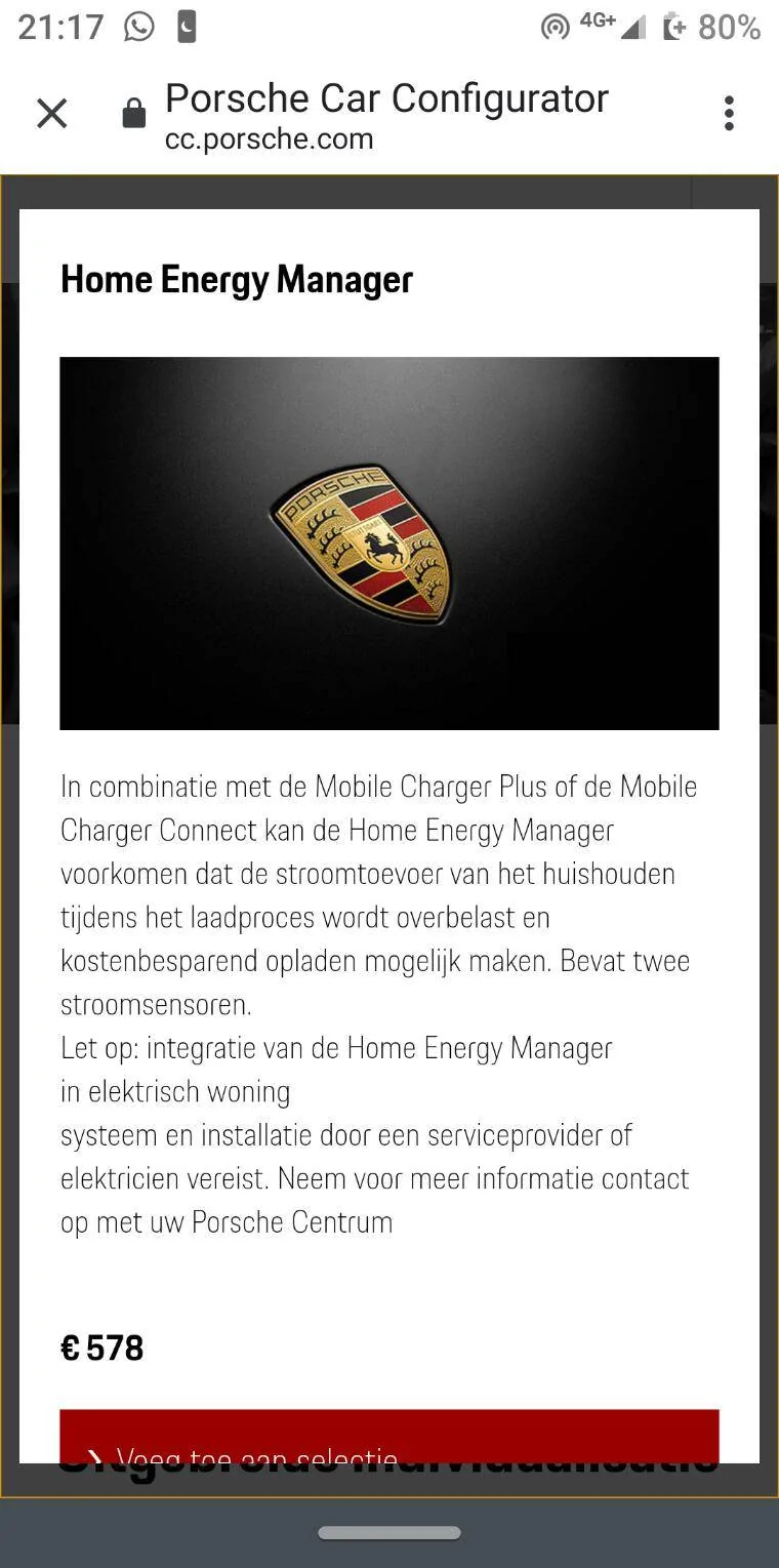

What does the "Optimized charging" option do? It says that it "considers both the prices of the electricity tariff you have provided as well as the availability of generated solar power". I have not "provided" any electricity prices, nor do I have solar power. I don't see where you can tell it your electricity prices. But when I have "optimized charging" selected in the general profile, it seems to wait to start charging the car, rather than charging immediately when plugged in. I have a fixed rate all day, so I just want it to start charging right away when I plug in.
That's only usefull if you're connected to a smart grid.
They're rolling this out in the EU.
Isn't that the Porsche Home manager which communicates with the Porsche charger?
