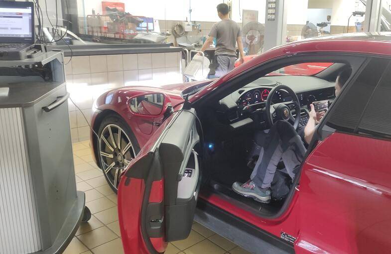

feye
Sep 16, 2019
2,203
1,665
Shenzhen
Porsche Taycan 4S+ 2020
Porsche Taycan Software Update - new PCM needed 1622206591339
Second attempt, cannot solve the problem of failed PCM update. Luckily I can drive the car, so I picked it up again. Porsche confirmed, PCM need to be replaced.
