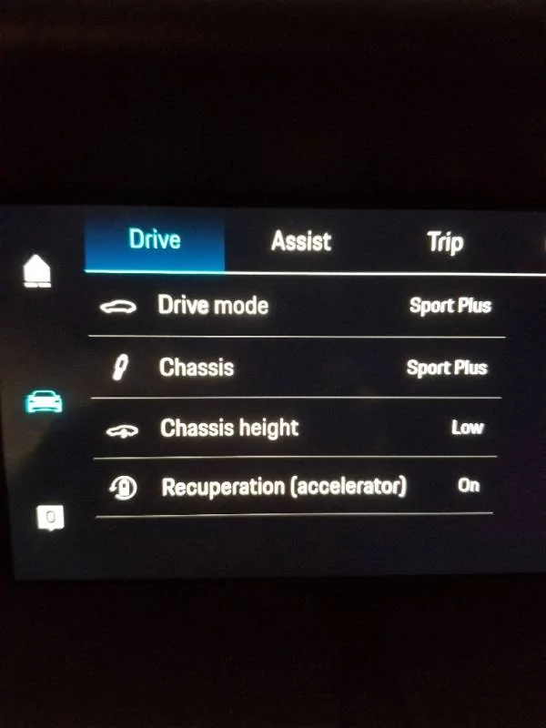

You can still select Sport Plus chassis mode without sport chrono. Just not the drive mode.
Mouse House
Sep 1, 2020
247
253
Suisse
New Balance 1500 v6
Sport Plus drive mode further alters the chassis over just the suspension setting.
What exactly? Clearly there's a different drive mode - the sport plus drive mode in the pic below isn't available without SC - but I don't see why there would be a difference between the chassis modes.
