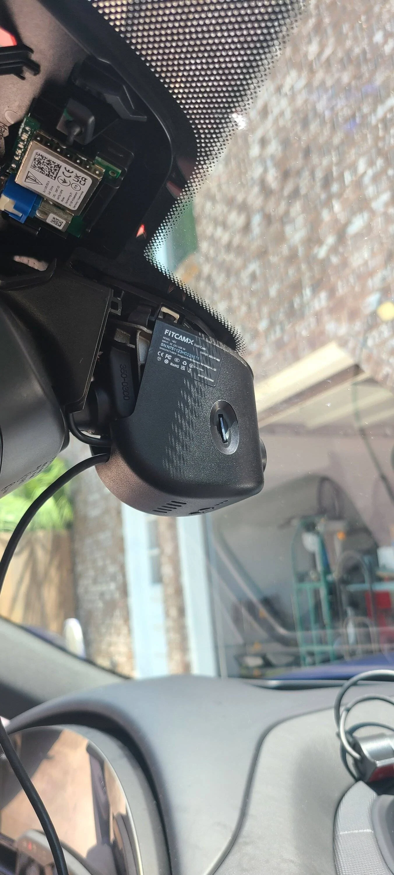

FitcamX - stuck trying to put it back together.
Dr Kiwi
Kela
Mar 11, 2023
Charleston, SC
Taycan 4S Cross Turismo 2023 (ordered)
I have the wiring completed for the forward and rear camers. I am stuck trying to get the trim pieces back in place. With the wire for the reverse camera coming out the bottom I have not been able to get the camera piece to "click" I to place.
Any one have experience with successful placement of the wires?

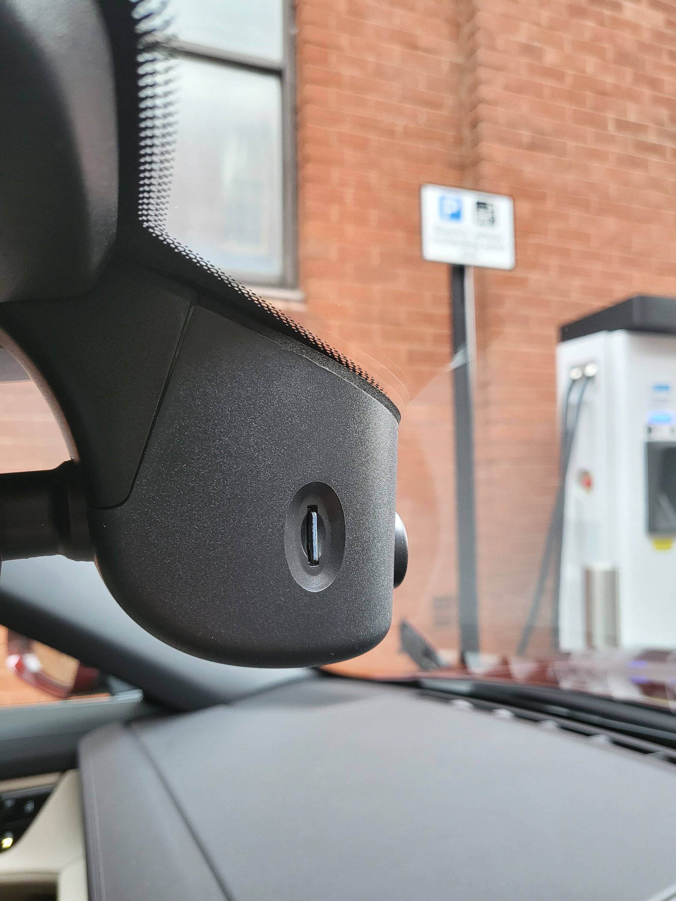

Cherryjock
James
May 28, 2023
56
Scotland
Taycan Cross Turismo 4
I don't have the rear camera but the front camera wire should exit higher, level with the bottom of the memory card.
If you look at where the camera has to slide up there is quite a 'bump' to get over. When it clicks in you will see it level with the windscreen.
I feel your pain, it's not easy at all but I think worth it in the end.

Cherryjock
James
May 28, 2023
56
Scotland
I meant to say the top of the memory card.

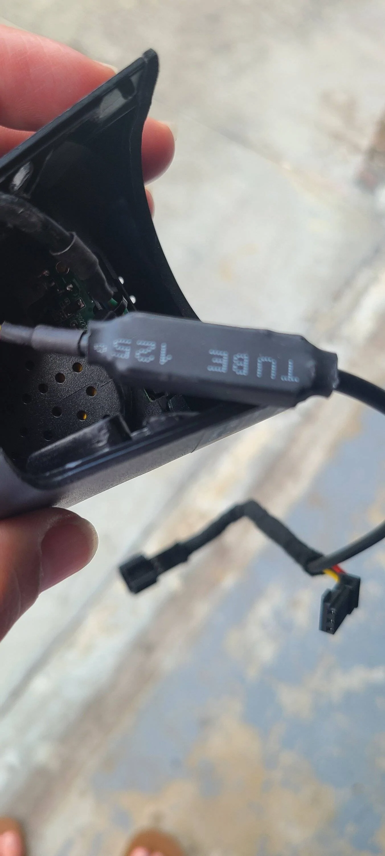

Dr Kiwi
Kela
Mar 11, 2023
Charleston, SC
We have tried it in multiple wire positions and can sometimes get one side to "click" into place but then the other side is deformed outwards. The other issue is the presence of a box on the power wire. It is not far enough from the unit to fit beneath the upper trim piece and it is too big to tuck in.
The bigger issue is that before getting the trim completely back together we tried to set it up on the app and it would not power on at all. It is now taken out because it is my daily driver so I couldn't leave it apart.

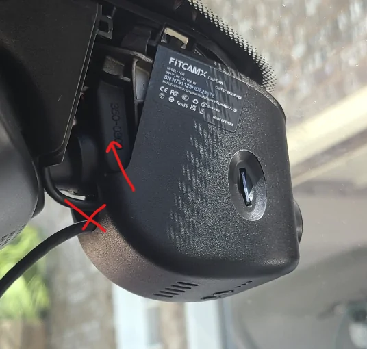

fika
Jared
Jul 10, 2023
56
Los Angeles
2020 Taycan Turbo
I contacted their support for the large black square in the wire and this video (see attached) is what they sent me as a reply.
The wires should be exiting like the picture below, from the side not the bottom.
